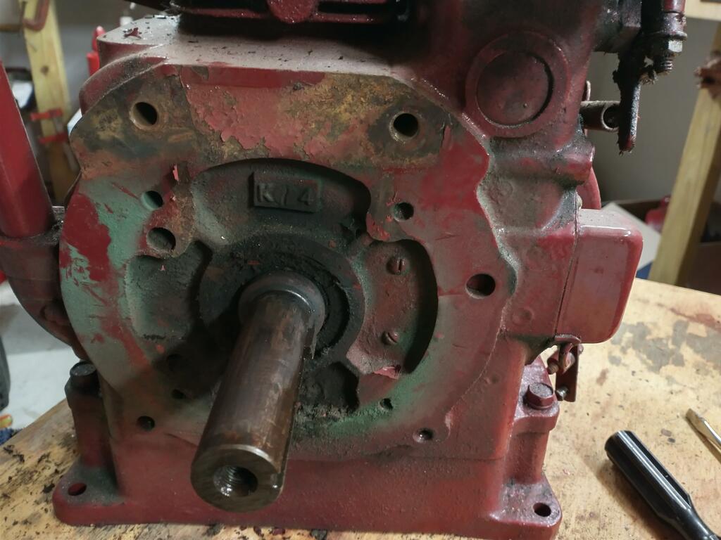

Handy Don 17,628 #126 Posted December 21, 2022 2 hours ago, ebinmaine said: Not sure if I'd be more steady one way or the other. I'll try it out. One of my bench vises rotates so the jaws can be over the bench. I'd think of mounting the Dremel with a big hose clamp to something clamped in the vise and then make some guides out of scrap wood and clamped to the bench to constrain the axle to straight and level movement. Then bits of sheet metal to shim the axle upward as the slot got deeper. Yeah, a bunch of McGuyvering! 1 1 Share this post Link to post Share on other sites

953 nut 70,023 #128 Posted December 21, 2022 Not saying I have ever done this but have you considered slipping an old hub on the axle, locking it down with a set screw, clamping the hub down squarely in your drill press and slowly running a 1/8" drill bit between the hub and the axle then moving up to 3/16" and finishing with a 1/4" drill bit to act as a starter channel. The cast iron hub will be softer and the drill may wander that way but it would remove the bulk of the material and be nice and straight. I just took an axle to our one and only machine shop for a key way and they said it will be ready in a few days and should be about $ 50.00. With the cost of those dermal cut off wheels I think that is a good buy. 4 Share this post Link to post Share on other sites
WHX?? 58,310 #129 Posted December 21, 2022 2 minutes ago, 953 nut said: I just took an axle to our one and only machine shop for a key way and they said it will be ready in a few days and should be about $ 50.00. With the cost of those dermal cut off wheels I think that is a good buy. Yes it is Richard...Took one to a shop once. $200 minimum set up charge. I since married a tractor bro who has a mill. 4 Share this post Link to post Share on other sites
953 nut 70,023 #130 Posted December 21, 2022 6 minutes ago, WHX?? said: $200 minimum set up charge Our local shop has several old manual set up milling machines as well as some CNC machines. The operator can set up small single run operations like the axle in between feeding pieces to the CNC monsters. He really enjoys small jobs because feeding pieces to the CNC is just mind numbing. 3 1 Share this post Link to post Share on other sites
ebinmaine 81,038 #131 Posted December 21, 2022 30 minutes ago, 953 nut said: Not saying I have ever done this but have you considered slipping an old hub on the axle, locking it down with a set screw, clamping the hub down squarely in your drill press and slowly running a 1/8" drill bit between the hub and the axle then moving up to 3/16" and finishing with a 1/4" drill bit to act as a starter channel. The cast iron hub will be softer and the drill may wander that way but it would remove the bulk of the material and be nice and straight. I just took an axle to our one and only machine shop for a key way and they said it will be ready in a few days and should be about $ 50.00. With the cost of those dermal cut off wheels I think that is a good buy. I can't get anywhere near that kind of a bargain around here. Timing either. I've been making a few phone calls over the last couple weeks trying to find a machine shop that can do this for me. Best I can come up with is a 2-month wait time and charges approaching $200 to make a groove in two axles. That's just not gonna happen. If I'm not satisfied with the grooves I can make by hand I'll just order a couple of good used axles from Lincoln at A To Z. 3 Share this post Link to post Share on other sites
SylvanLakeWH 32,764 #132 Posted December 21, 2022 39 minutes ago, 953 nut said: The operator can set up small single run operations like the axle in between feeding pieces to the CNC monsters. He really enjoys small jobs because feeding pieces to the CNC is just mind numbing. Wait... what...? Actually multi-task to increase productivity, profit and customer satisfaction...? Crazy talk... Not. Thats great business!!! You are fortunate. Perhaps you can spread the word on the shop name / contact info so he gets some business and folks in your area can get some sorely needed and rapidly disappearing help... 1 Share this post Link to post Share on other sites

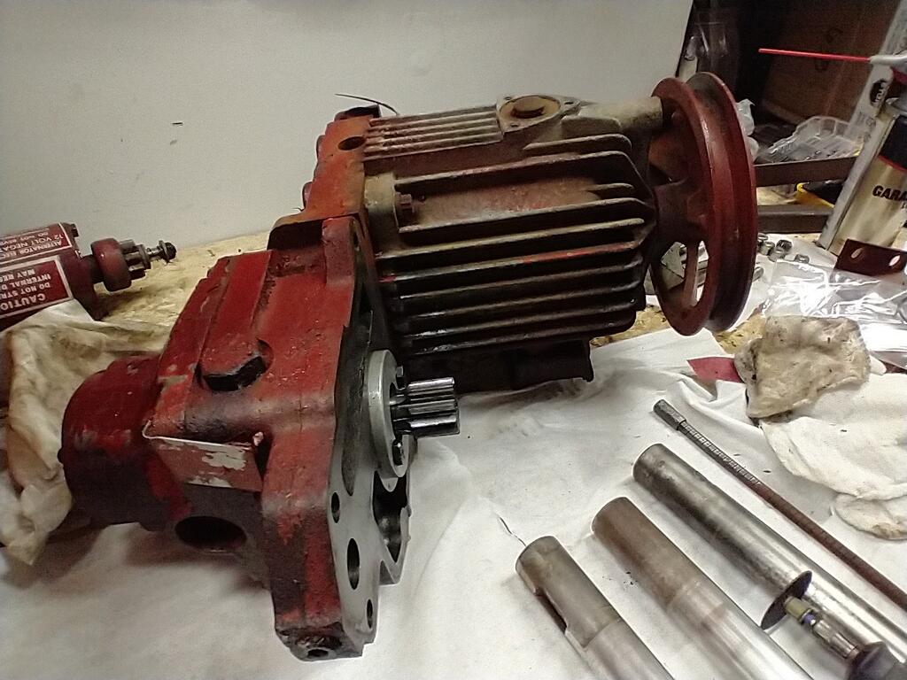

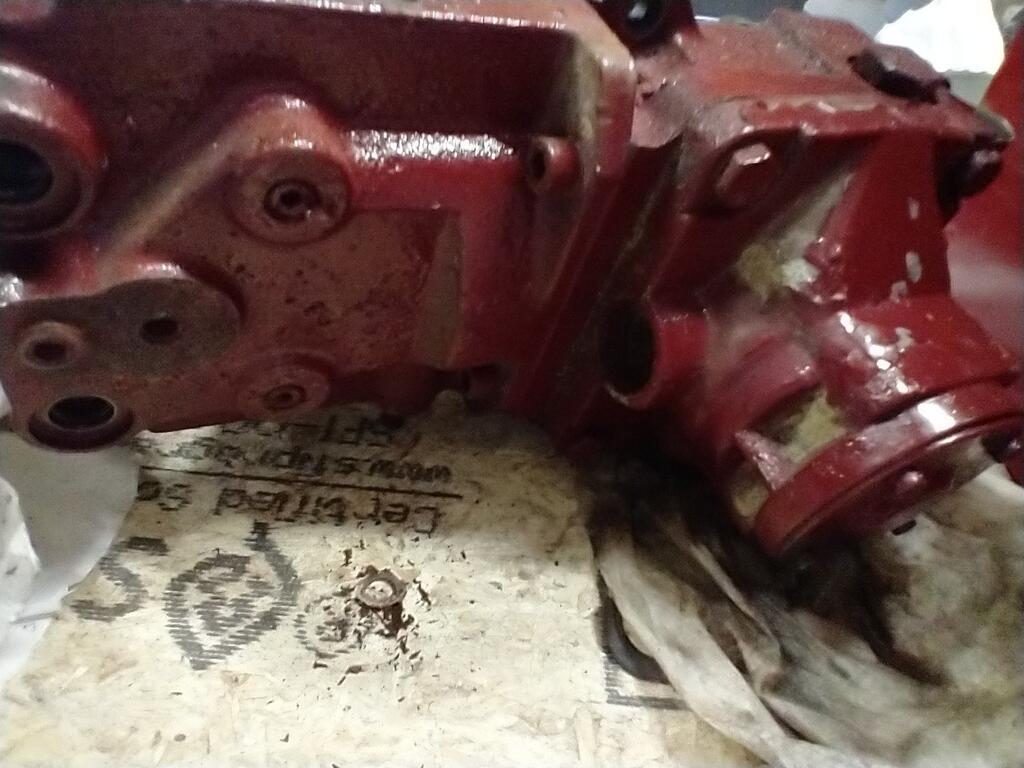

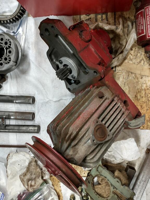

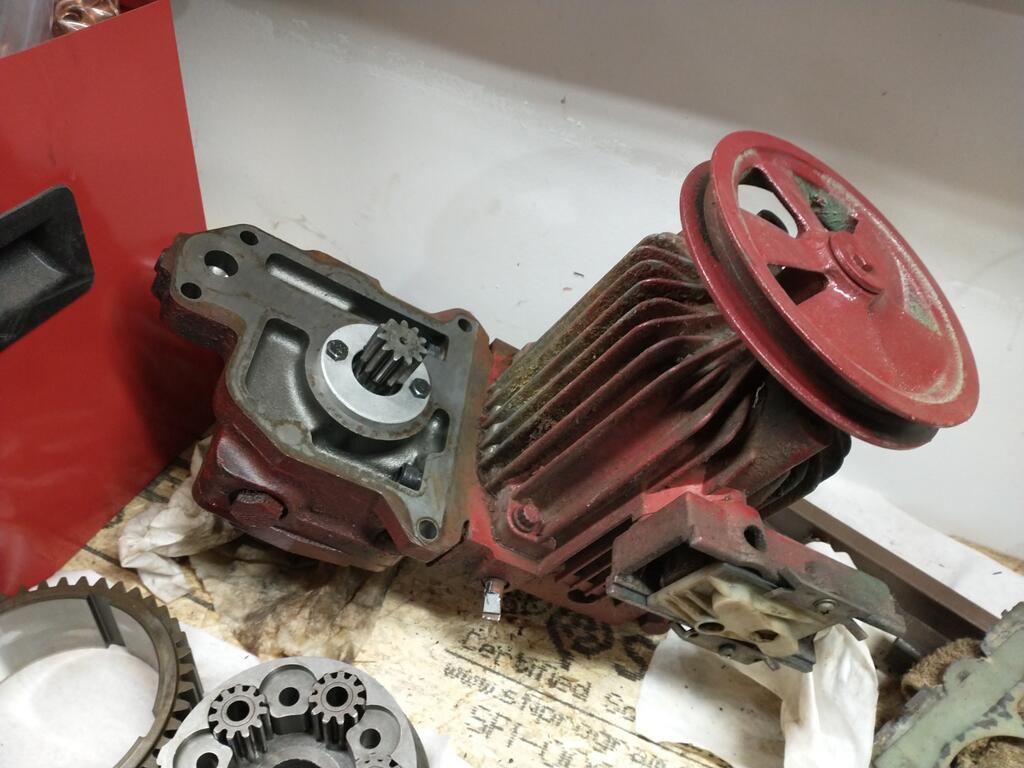

ebinmaine 81,038 #133 Posted December 21, 2022 @daveoman1966 @pfrederi @953 nut Okay folks I need your help. Please do mention people you know that are familiar with these hydros if you like. Over the next few days I'm going to be at the point where we need to clean up the hydro pump and get it repainted and ready for installation. I have the gasket that goes between this surface and the transmission housing. Should I take things apart to check it out? OR .... Knowing the tractor runs and drives just fine... Just leave it well enough alone? What comes apart? Is it O ring or gasket? Can I still get pre-made parts? 1 1 Share this post Link to post Share on other sites
Handy Don 17,628 #134 Posted December 21, 2022 I’m SURE there will be a variety of opinions on this one. Me? Let well enough alone (as long as you are pretty confident that the work ’til now hasn’t introduced any debris into the hydro). 1 1 Share this post Link to post Share on other sites
8ntruck 9,358 #135 Posted December 21, 2022 You got a drill press? Maybe check HF for a drill press vice with an XY table built in. With an end mill chucked in the drill press and light cuts, this should get you close. This set up should work with an end mill chucked in the drill press and light cuts. You might be able to chuck up a 1/4" key way cutter and mandrel and come up with some creative figuring to hold the axle. Again, light cuts, as heavy side loads on the Morse taper in the spindle might cause it to release the chuck. 2 Share this post Link to post Share on other sites
ebinmaine 81,038 #136 Posted December 22, 2022 1 hour ago, 8ntruck said: You got a drill press? Maybe check HF for a drill press vice with an XY table built in. With an end mill chucked in the drill press and light cuts, this should get you close. This set up should work with an end mill chucked in the drill press and light cuts. You might be able to chuck up a 1/4" key way cutter and mandrel and come up with some creative figuring to hold the axle. Again, light cuts, as heavy side loads on the Morse taper in the spindle might cause it to release the chuck. I've considered this as an option and bought and end mill bit along with this 40+ year old one. My maternal grandfather was employed at the Union Twist Drill factory back in the 70s. The big disadvantage I have is that my drill press is some worn and already has a slight wobble at the chuck. Certainly not usable as anything close to an accurate mill. 2 Share this post Link to post Share on other sites

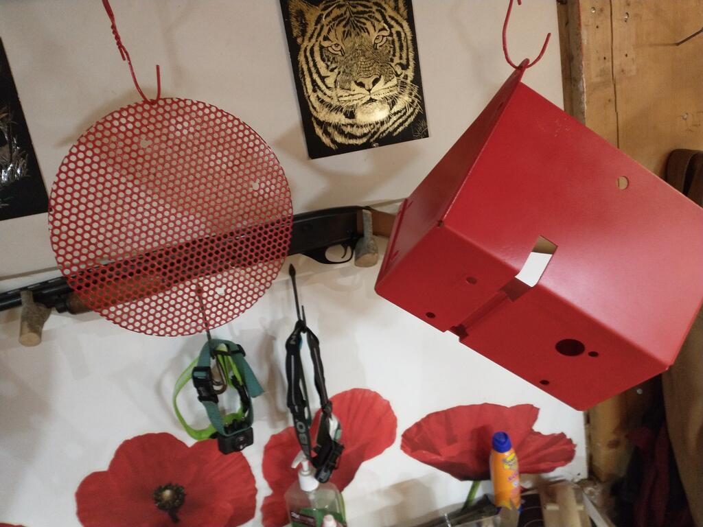

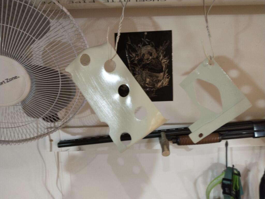

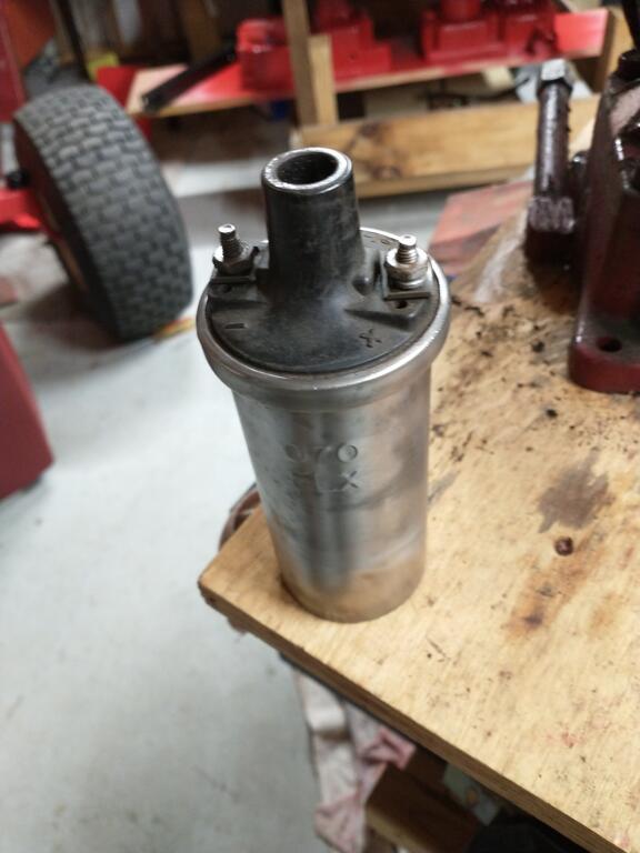

ebinmaine 81,038 #137 Posted December 22, 2022 This evening I set up my NOS KD Tools steering wheel puller for the first time. Used it on the engine drive pulley. Took a bit of penetrating oil and some burning mapp gas to convince the pulley it wanted to come off. I removed the paint from it. The Paint Department sprayed it. I also cleaned up the old Delco Remy ignition coil. She'll paint that later. Trina got a few more pieces sanded cleaned up and painted too. 4 1 Share this post Link to post Share on other sites
Snoopy11 5,731 #138 Posted December 22, 2022 I know money is one thing... that may be the only... but why not just replace the ignition coil now? I'm just thinking along the lines of reliability... Don 1 Share this post Link to post Share on other sites

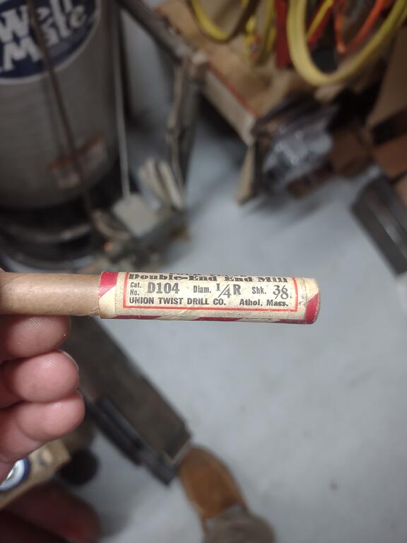

8ntruck 9,358 #139 Posted December 22, 2022 Another possibility is using a smaller end mill to mill the sides of the key way separately in a couple of passes. This way the wobble in the chuck would leave 'waves' in walls of the keyway but not leave the key way oversize. The drawback to that is that it will be be more difficult to keep the centerline of the key way on the center of the axle. Gotta ask - is that end mill a 1/4" radius, or 1/4" diameter. The 'R' right after the size caught my eye. 1 Share this post Link to post Share on other sites
ebinmaine 81,038 #140 Posted December 22, 2022 Just now, Snoopy11 said: I know money is one thing... that may be the only... but why not just replace the ignition coil now? I'm just thinking ALONG THE LINES OF RELIABILITY... Don Oh no no no no no. A coil on an old machine isn't a maintenance item like a spark plug. I'd run a 40 or 50 year old coil instead of a modern garbage pile item. Every. Time. Same with points. I'd clean old points unless absolutely beyond use. (I haven't replaced a set yet!!) I have a couple spare coils setting too. 3 1 1 Share this post Link to post Share on other sites
ebinmaine 81,038 #141 Posted December 22, 2022 8 minutes ago, 8ntruck said: Gotta ask - is that end mill a 1/4" radius, or 1/4" diameter. The 'R' right after the size caught my eye I'd have to check for ya. Share this post Link to post Share on other sites
