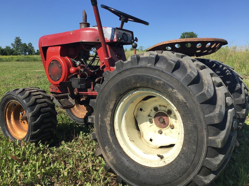

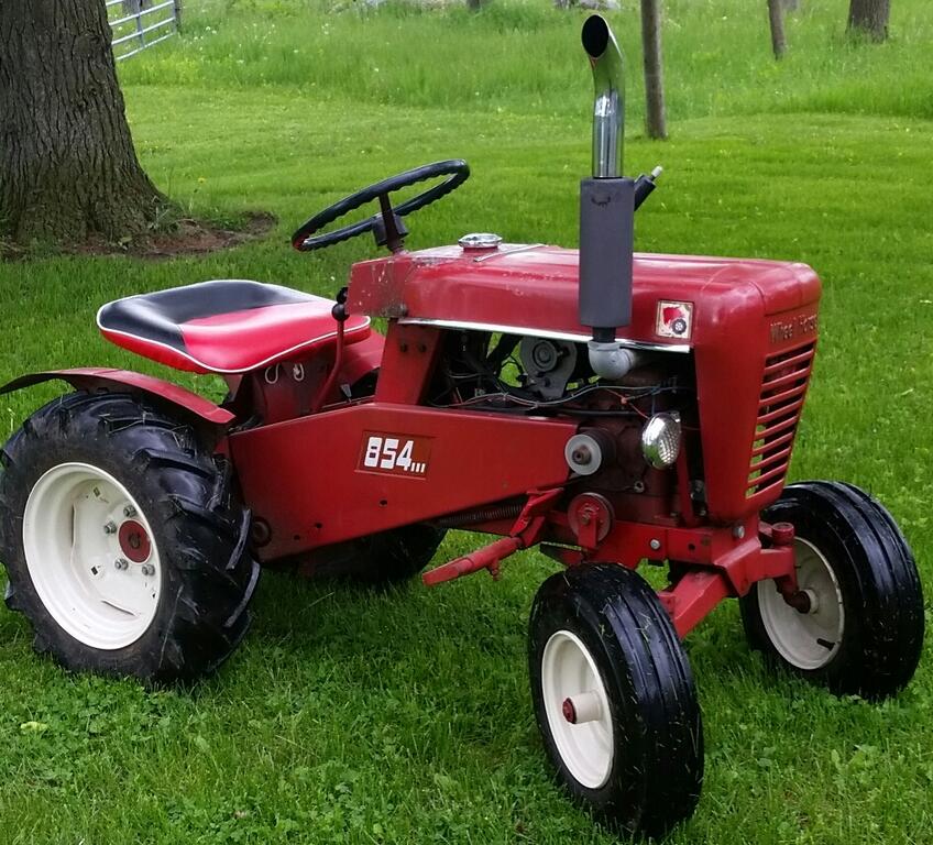

rjg854 13,271 #27 Posted November 26, 2022 You'll really like that 854 once you give it some TLC. A deck and plow gives you 4 season usage. It's a fun, agile and strong for a small tractor. 3 1 Share this post Link to post Share on other sites
Outlier 57 #28 Posted November 26, 2022 @rjg854 Your tractor looks great. can you tell me something about your muffler? 1 Share this post Link to post Share on other sites
rjg854 13,271 #29 Posted November 26, 2022 Jim Kemp makes them, fairly reasonable price wise, and a nice mellow tone. 3 1 Share this post Link to post Share on other sites

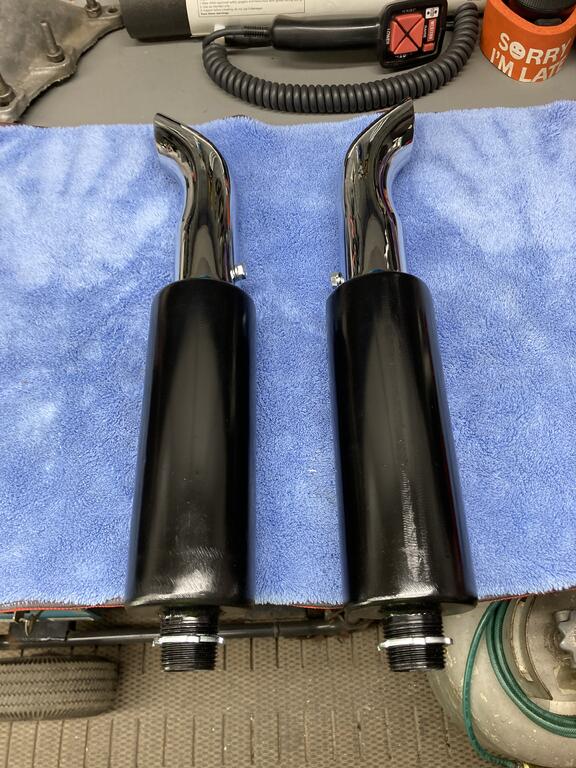

Blasterdad 3,167 #31 Posted November 26, 2022 Nice! I'm glad you found one like you wanted. If it was mine I would run it, a little smoke means she will need some love soon, just make sure she's full of oil. If she starts to knock or make other "funny" noises shut her down! I love my Kohler 8's, I would rebuild it or find a replacement K181 & keep it ORIGINAL. They are not that hard to find as they were used on many things. The muffler you asked about is made by @jimkemp. I bought 2 of then recently, lots of us have them & they are affordable, great quality, & lets face it,...Just look downright COOL. We would love pics when you get her !!! 2 2 Share this post Link to post Share on other sites

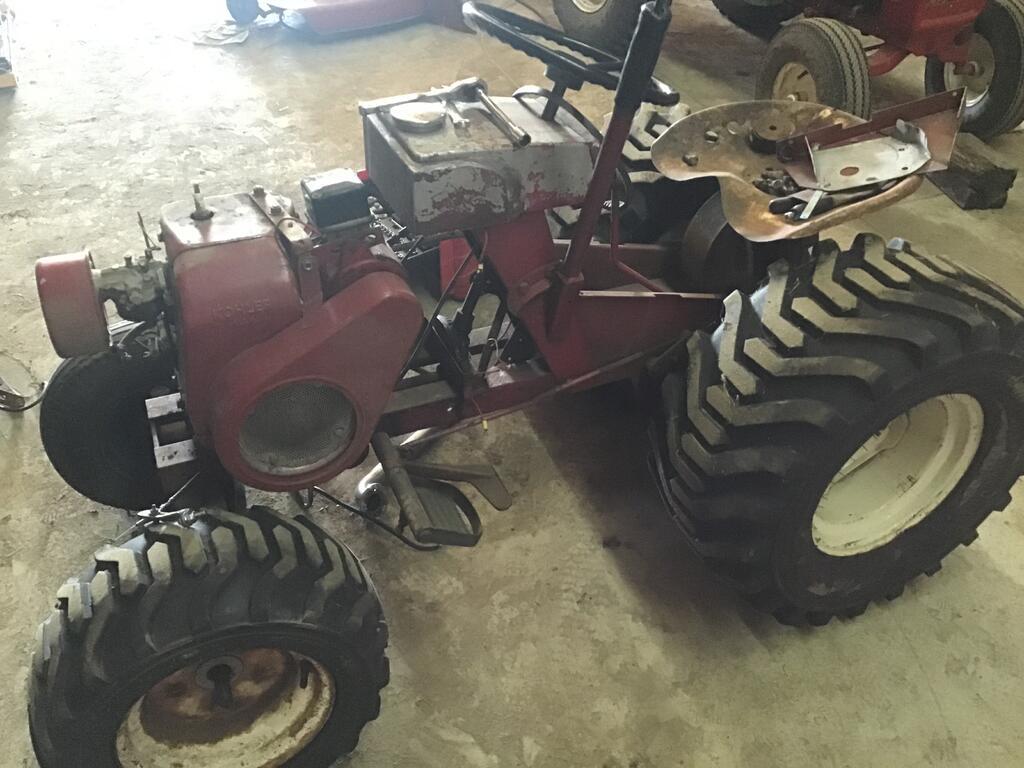

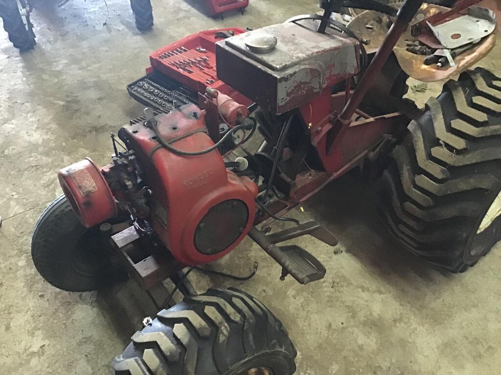

Outlier 57 #33 Posted November 27, 2022 @rjg854 Compared to your 854, I notice I've got something strange going on with my solenoid and starter. Do you know what the heat-sink looking thing is that I've got? is it stock? 1 Share this post Link to post Share on other sites
953 nut 68,194 #34 Posted November 27, 2022 11 minutes ago, Outlier said: heat-sink looking thing is That would be your voltage regulator, they are needed for the charging system. 1 Share this post Link to post Share on other sites

Handy Don 17,209 #36 Posted December 3, 2022 On 11/27/2022 at 1:04 PM, Outlier said: @rjg854 Compared to your 854, I notice I've got something strange going on with my solenoid and starter. Do you know what the heat-sink looking thing is that I've got? is it stock? I'm pretty sure that somewhere along the line that tractor has "had some work done" -- not an issue unless you are going for "original". It is not the original engine. The 854 had a starter/generator version of Kohler 8hp. Your engine has built-in starter and stator for charging (hence the "heat sink" regulator). I'd guess that engine is from a later model (possibly to replace a failed original engine?). This looks like it's from the early 70's. It also might be a 7hp judging from the "short" air cleaner. The engine is missing some of the tins that direct the cooling air around the sides and across the top of the cylinder. The original 854 steering wheel is a somewhat-dished two-spoke and yours is a flat 3-spoke from a different model. I don't see a battery tray on the frame just behind the engine, so I'm not sure where that's mounted. The gas tank (two-piece) and hood stand (holding the tank and the dashboard where the throttle and choke levers are) are definitely '63 or '64. The ammeter is missing (the hole in the dashboard) but the key start switch is there. The wiring for a 70's engine might not have included an ammeter. The metal seat is not original but is, I think, from another WH model. The mower deck looks like a 32" from '63 or '64 in decent condition and the plow is also of the right vintage with the "short" A-Frame. It does look like the plow attaching bracket is in place on the rear axle, too. All this is just info, however. It is not at all uncommon, after 50+ years, to see tractors that have had substitutions and replacements so that they can keep on working! Share this post Link to post Share on other sites

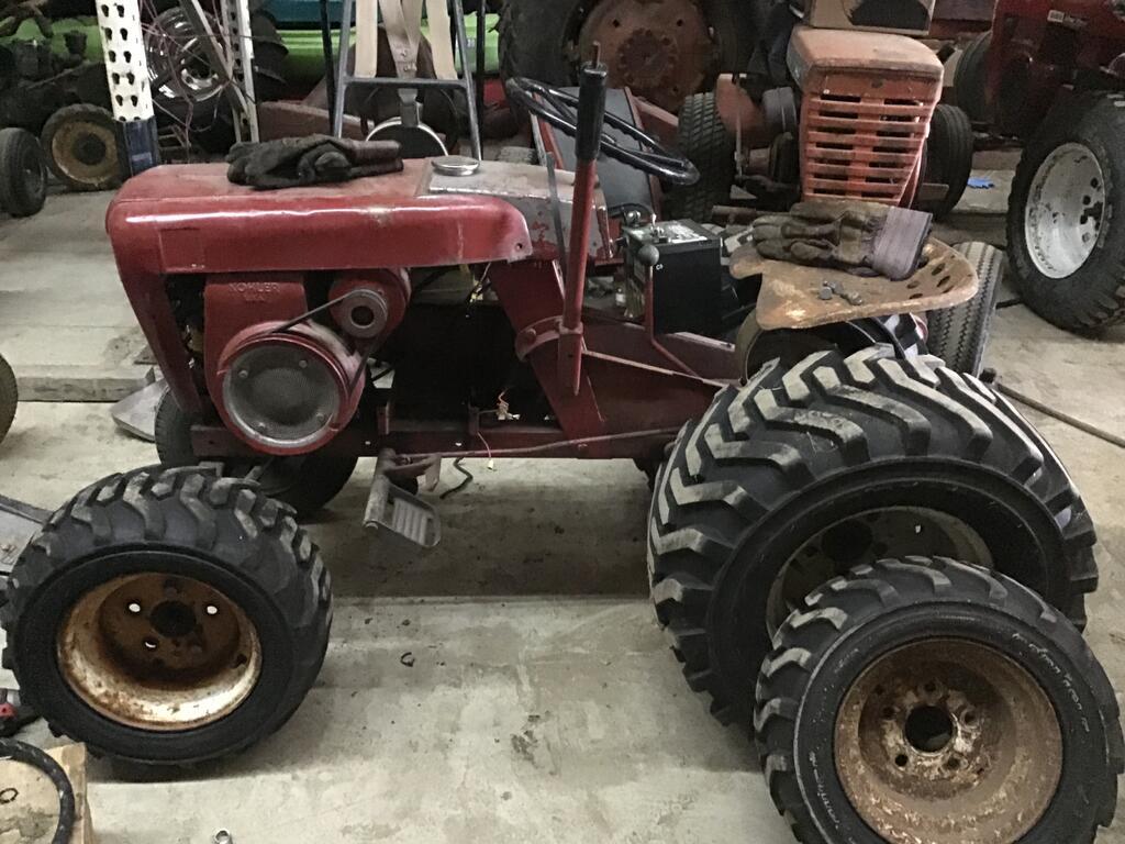

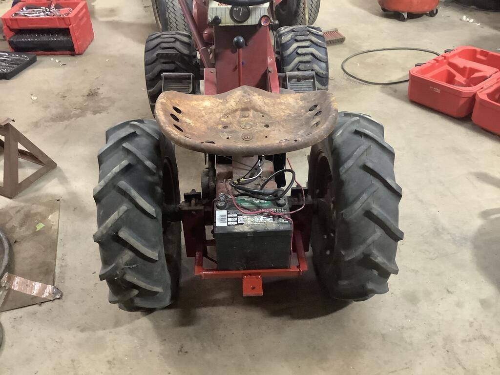

Outlier 57 #37 Posted December 4, 2022 @Handy Don The info is certainly appreciated - The mix of pieces isnt bad, it kinda gives character. As long as they work together well and dont look terribly wrong. When it gets here later this month I'm going to see if I can put the battery back where it belongs. The unprotected terminals contact the seat when someones on it! I did notice that the starter is mounted low, and most of the other 854's I've seen have the starter higher up. With the dual wheels, I wondered if maybe someone had wanted to make a puller. I was worried the rear differential would be locked, but fortunately it sounds like that isnt the case. Has anyone ever put together some sort of live PTO to the rear of one of these older models? In my mind I envision some sort of pseudo-3 point happening. It would be neat to mow the lawn with a miniature rotary mower, just for kicks, with my miniature tractor 3 1 Share this post Link to post Share on other sites

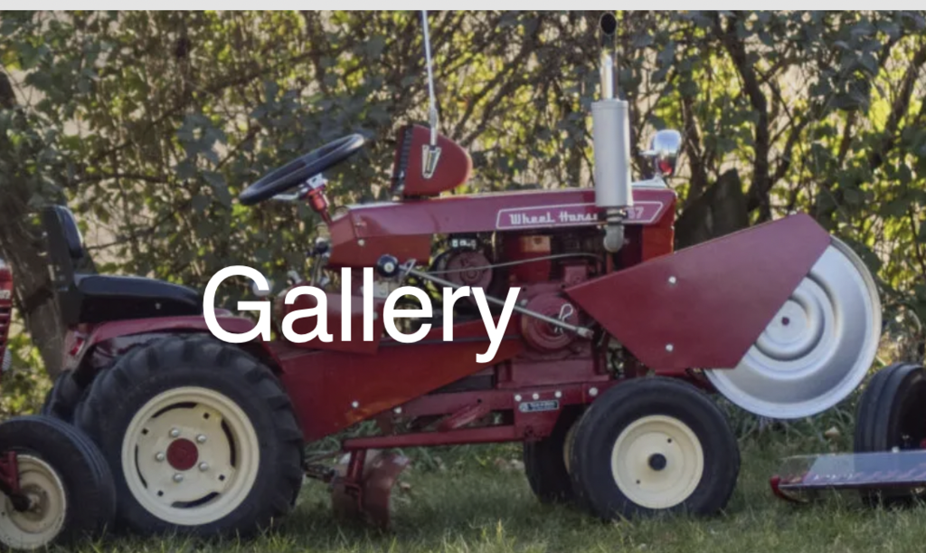

Handy Don 17,209 #38 Posted December 5, 2022 3 hours ago, Outlier said: some sort of live PTO to the rear of one of these older models? In my mind I envision some sort of pseudo-3 point happening Wheel Horse aimed at a particular market segment (for the most part) so live rear PTOs on these small tractors just weren't in the plan. WH offered rear tillers for the higher HP models that were driven by a belt routed under the tractor (and towed model for the lower HP tractors which had its own engine). I know some members have towed powered self-powered mowers. WH did offer a 540 RPM PTO adaptor for the front of tractor using the standard PTO for operating stationary equipment (conveyors, hoists, saws, etc). This tractor has one PLUS an exceedingly rare hood-mounted AM radio! (it belongs to @wheelhorseman). As for 3-points, a number of members have built them. Searching the Topics here will find several threads showing the builds. Enjoy! 1 2 Share this post Link to post Share on other sites

The Freightliner Guy 1,364 #41 Posted December 7, 2022 its awesome i love the duels on the back they're rad. 1 Share this post Link to post Share on other sites
Pullstart 71,015 #42 Posted December 7, 2022 Awesome tractor, congrats! That engine looks like it came from a C-81 or the like, with the starter down low. That took up the real estate of the battery… vs a starter/generator system. A skinny Harley Davidson battery or some other specialty battery might help with your goal of getting it back under the hood. 3 Share this post Link to post Share on other sites
Pullstart 71,015 #43 Posted December 7, 2022 On my “Poppy” build Link here. You can see how much room was between the steering gear and the engine block with the starter generator. When I swapped in the modern starter engine, I lost that space. My battery is now behind the transmission on a custom mount. 3 1 Share this post Link to post Share on other sites
sjoemie himself 3,158 #44 Posted December 8, 2022 On 12/5/2022 at 1:29 AM, Handy Don said: WH did offer a 540 RPM PTO adaptor for the front of tractor Very interesting! Any pictures or more info on that? Share this post Link to post Share on other sites
Handy Don 17,209 #45 Posted December 8, 2022 1 hour ago, sjoemie himself said: Very interesting! Any pictures or more info on that? See post #38. There was one in the Classifieds not too long ago, not sure if it sold. @wheelhorseman and his wife own Wheel Horse Parts and More (a supporting vendor on this site). You can see his PTO unit in several of his gallery pictures on this site. 1 Share this post Link to post Share on other sites
sjoemie himself 3,158 #46 Posted December 8, 2022 @Handy Don thanks for pointing that out, now I feel dumb I thought the giant pulley on the front of the tractor was somekind of diy inertia woodsplitting doohicky.. did'nt notice the PTO shaft at first. Makes sense now that pulley is so big so to get the rpm's down. Pictures have been saved 1 Share this post Link to post Share on other sites
Lagersolut 802 #47 Posted December 9, 2022 On 11/26/2022 at 4:42 PM, Blasterdad said: Nice! I'm glad you found one like you wanted. If it was mine I would run it, a little smoke means she will need some love soon, just make sure she's full of oil. If she starts to knock or make other "funny" noises shut her down! I love my Kohler 8's, I would rebuild it or find a replacement K181 & keep it ORIGINAL. They are not that hard to find as they were used on many things. The muffler you asked about is made by @jimkemp. I bought 2 of then recently, lots of us have them & they are affordable, great quality, & lets face it,...Just look downright COOL. We would love pics when you get her !!! Is he still making these ? Love one of these on my 416 1 Share this post Link to post Share on other sites
Blasterdad 3,167 #48 Posted December 9, 2022 5 hours ago, Lagersolut said: Is he still making these ? Love one of these on my 416 Yes he is, Share this post Link to post Share on other sites
