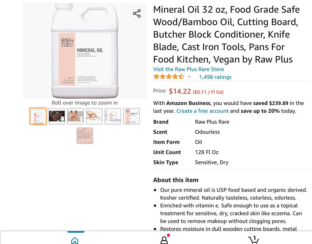

Pullstart 71,482 #4 Posted November 13, 2022 @peter lena what do you think about this stuff? Compared to a gallon of used oil and kerosene or diesel mix? Last year, we spent nearly $100, maybe more, in aerosol treatment. 1 Share this post Link to post Share on other sites
oliver2-44 11,791 #5 Posted November 13, 2022 Just an FYI from years of working with oil and grease at the dams. An oil with a “Food Grade” rating doesn’t mean it is any more environmentally friendly than other oils. It just means it processing methods haven’t allowed any contaminants from the machinery into it. 2 Share this post Link to post Share on other sites

peter lena 10,103 #7 Posted November 13, 2022 @Pullstart would not hesitate in its use , mineral oil , is the basis of , new Hampshire oil undercoating , would try it on paint finish , rub down , let sit , to soak , wipe down with clean soft cloth , done that regularly on neglected paint , get it into all your metal seams , days later the entire seam is creeping with oil lubricant , make sense ? you have stopped the rust / moisture cycle . once you start feeding metal with lubricant , is on constant defense against rust . my wheel horse paint , looks very deep and solid , after recovering neglected grunge , use a palm buffer , with cleaner wax , looks like new paint . this not a 1 and done thing , but it will stop rust , my car doors , trunk area , wheel arches , box channel frame areas , suspension exposure , all oil , heavy open gear lubricant , zero rust , once its in there , its easy to touch up . just a suggestion , try it on an easy access spot , go oily , pete 2 Share this post Link to post Share on other sites

peter lena 10,103 #9 Posted November 13, 2022 @oliver2-44 working at pfizer , virtually everything we were working on was " food grade " making various ingredients for beer , medicine , food , everything was regularly lab tested to verify its status / stability . all of our stainless steel was 316 food grade , all of our , " production change overs " were also lab checked for purity. we also had miles of PYREX clear glass lines , going to and from blue glass lined thousand gallon vessels . all of that led me into the lubrication enhancement usage , for hi heat , failure areas , pete 1 Share this post Link to post Share on other sites
