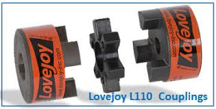

Do you not use the standard rubber lovejoy for cleanliness purposes?  It sure looks like a pull start or hand start coupling, kicking away after it starts, not for continuous positive engagement.,,
This is the Lovejoy Coupler I am familiar with. Like Kevin said the one you referenced would kick out.
Lovejoy Couplings - Octaforce
In Actuality i think the term " Lovejoy" is from the name of the co. that started it. Everybody uses the term "Lovejoy" almost as a slang term. Funny I was working on a dish washer during an afternoon and one of these "lovejoy" ends was seized onto a shaft of a bad wash motor. I needed one bad. I called 3 big industrial suppliers in the city of Rochester N.Y. and asked for a 1/2" Lovejoy coupler. Not one of those mohambies knew what I meant by "lovejoy"  Once I sent them a picture they new what I was talking about. "Oh a motor shaft coupler!" :rolleyes::rolleyes::rolleyes:

This set up would work great, regardless of what they call it. It will only kick out it you rotate it in the wrong direction.

oliver2-44
They will drive one direction and kickout the other direction which makes them easy to remove.  The square shouldered Love Joy would require a tool(  allen wrench) to slide one side of the coupling back to remove the mechanism.
If you want to do the job on the cheap you could get a steering rag joint and slide coupling from an auto dismantler. Should work fine for a light load at low RPMs. Slip joint will be handy for uncoupling it.
