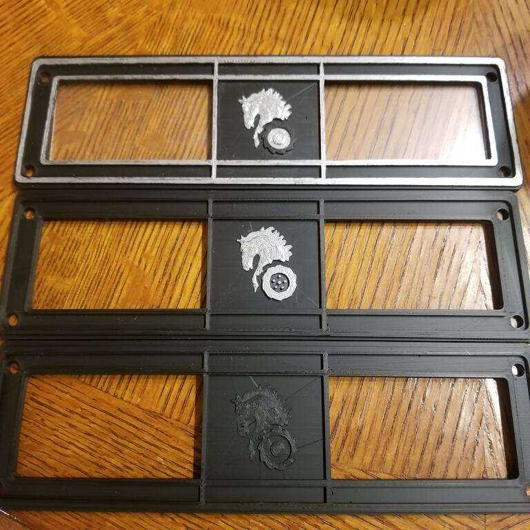

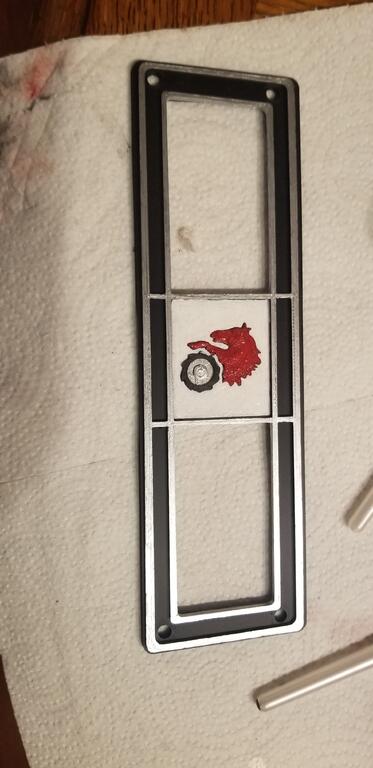

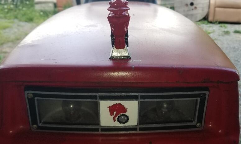

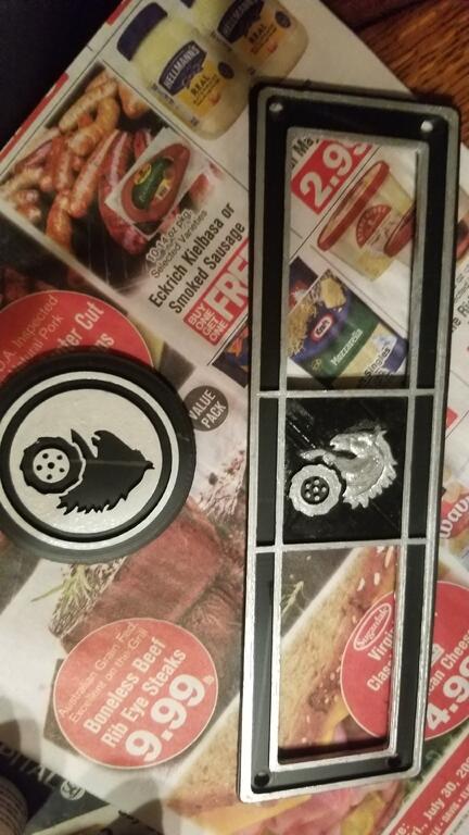

Hey guys!
I'm working on a custom escutcheon plate for my 1975 B80. I wanted a stock look but with some headlights. I bought some bright LED headlights from Amzn and went to work designing in the computer. We have a laser cutter at work so I bought some white acrylic and took a bunch of measurements. I didn't have an escutcheon plate because when I bought the tractor, it was missing... I took a few measurements and cut out a bunch of trial templates for the basic outline. On about the 3rd try, I got exactly what I wanted. I didn't hold the plate's left and right out like WH did, I went a little farther to take up the whole area in that recessed portion. I cut out designs both ways and I liked the look of the whole thing covered.
Here are some of the pictures of the work in progress:
I'll have the finished product later today. Oh, and I also ended up fitting the red outline in there as well. It'll show on the final piece.
