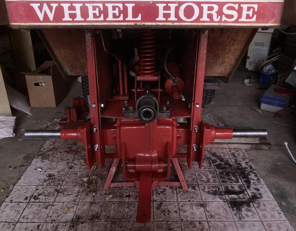

"Manic-Mechanic" 1,485 #1 Posted October 27, 2022 (edited) I am installing freshly rebuilt hydro component's in the 18 auto. Before I close up the Transaxle pre-lubed, what is a better performing oil or fluid? Edited October 27, 2022 by "Manic-Mechanic" Share this post Link to post Share on other sites

"Manic-Mechanic" 1,485 #14 Posted October 28, 2022 (edited) On 10/27/2022 at 5:16 PM, pfrederi said: I have 7 Sunstrand Hydros. 6 are in Charger /Electros and they all run ATF because that's what was in them. the D200 has 10w-30 because that what was in it. All have been using wix 51410 filters, some for many years. (I do think the ATF units are ready to work a bit faster when cold..) Other manufactures using same sunstrand specified different filter/fluids ...usually their own. We aren't using these unit 5 day a week 8 hours a day....Some things do not need to be over thunk.... Yes, true.I would prefer a more powerful tractor and weighed the pro's and con's as I do have an option to go either way. Seems the 10-W-30 is more familiar and yes, it had that in it whenever I picked it up. Thanks everyone for the input and now it's time to just move forwards.... She's back on and ready for the hydro motor... Edited October 29, 2022 by "Manic-Mechanic" 1 Share this post Link to post Share on other sites
