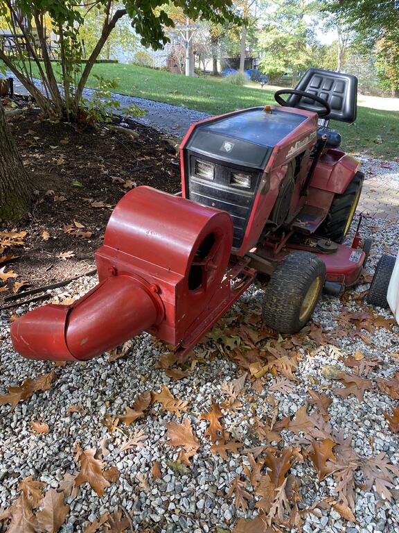

Pullstart 68,938 #11 Posted October 18, 2022 @formariz what is your tractor/blower setup by the way? We all know @953 nut has a slick furnace blower that’ll give a small town a good breeze! 1 Share this post Link to post Share on other sites
formariz 12,354 #12 Posted October 18, 2022 45 minutes ago, Pullstart said: @formariz what is your tractor/blower setup by the way? We all know @953 nut has a slick furnace blower that’ll give a small town a good breeze! 1 2 5 Share this post Link to post Share on other sites
Pullstart 68,938 #13 Posted October 18, 2022 Is that a snowblower shute? Awesome! Share this post Link to post Share on other sites
formariz 12,354 #14 Posted October 18, 2022 5 minutes ago, Pullstart said: Is that a snowblower shute? Awesome! Yes it is. Fashioned after the one from @oldredrider serial #1. My favorite implement. Makes a job that was plain drudgery a real fun one now. 2 Share this post Link to post Share on other sites
