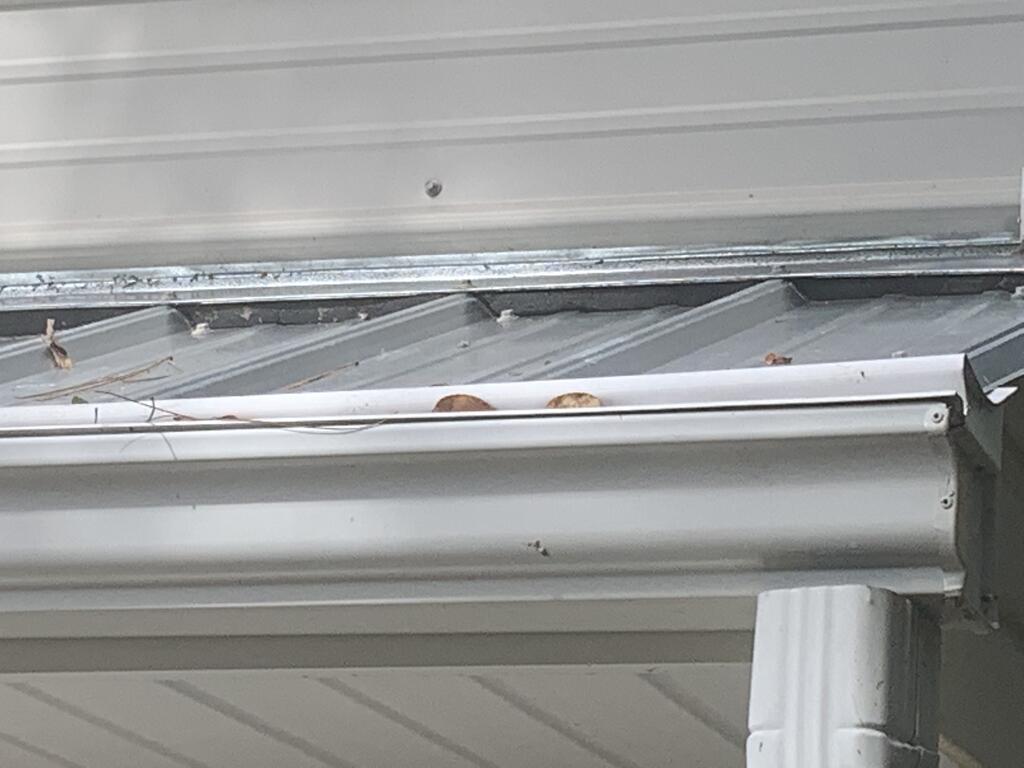

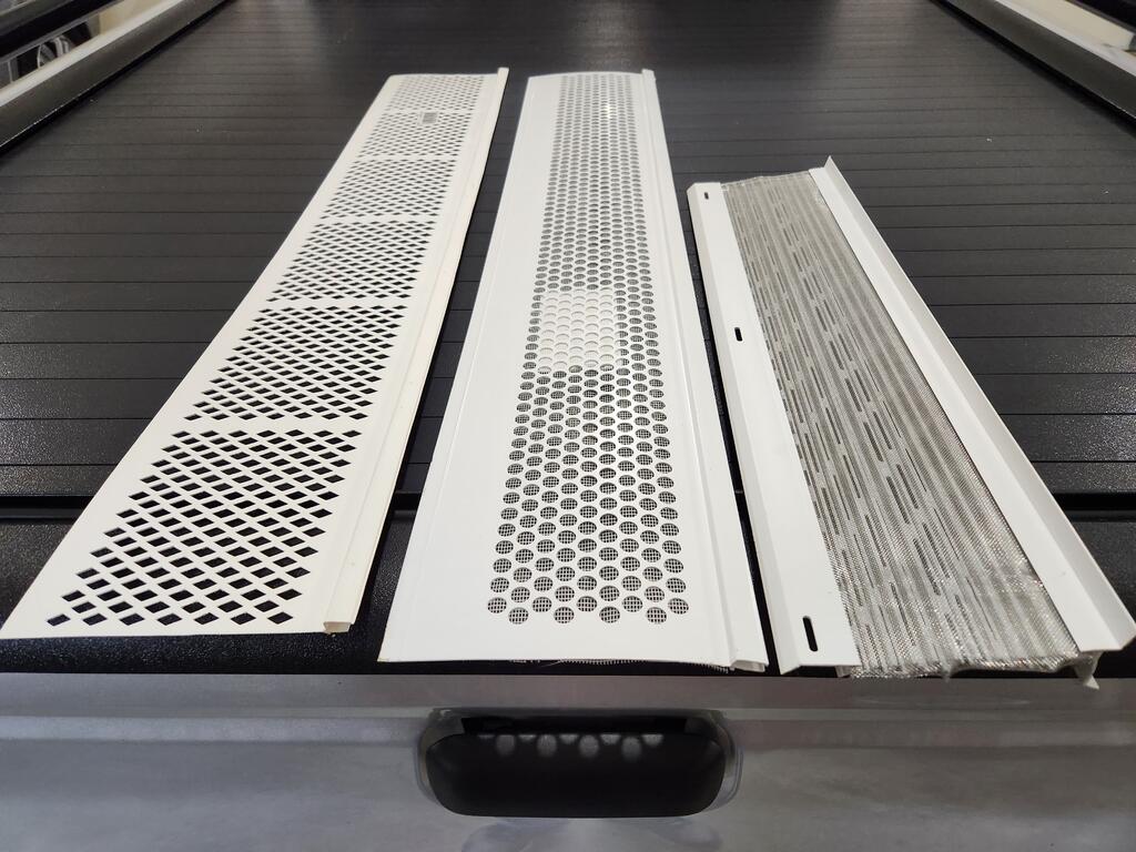

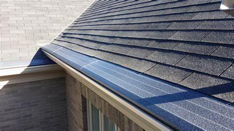

Racinbob 13,199 #9 Posted October 2, 2022 I've always been big on getting water away from the house. Typically that means gutters. I don't think gutters really contribute to ice dams and buildup as long as, like has been said, you have adequate insulation and ventilation in your attic. But there's the issue of cleaning them if leaves are an issue for you. So gutter guards come into play. But they can cause problems too. Here's my 2¢worth based on my experience with them. First, with this internet picture. Avoid these and any of the derivatives out there. Their function is marginal. Leaves and other crap will still get in. They create a perfect wasp hotel. They are intrusive to your shingles. They CAUSE ice buildup. The reason for that is even with great insulation and ventilation under certain conditions water will freeze on them. There are days in the winter where it's below freezing and the sun is shining. The roof absorbs some of that heat, snow melts and it hits the still freezing metal causing it to freeze up. On a previous house we had a horrible problem with ice buildup. We had plenty of insulation and great ventilation AND this style of gutter guards were on the house when we moved in. The first four things I mentioned were reason enough to remove them so I did. Bingo! The ice problem totally went away. We sold that house and moved to the one we're in now. No ice problem but a leaf problem and my bones are getting too old for the constant cleaning to keep them flowing good. I tried several ways to do it from the ground but it was getting old. Enter the gutter guard research. Here are three of the styles I considered. On the left is a low priced unit. I looked at several similar products. The biggest problems I saw was wasps could still get in and pine needles and leaf stems would get themselves stuck. There are also quite flimsy. In the middle in a bit of an improvement and a little more expensive. But the fine mesh you see is just plastic and was coming off right out of the box. On the right is what I consider a major improvement and also more expensive in a major way. A lot stronger and the mesh is stainless steel. I wondered if water would refreeze before it made it through the mesh. Only time could tell me that. We now have these on our house. Last winter we had above average snowfall and I kept close tabs on them. So far absolutely zero issues with ice leaves or wasps. So far I'm loving them. 5 Share this post Link to post Share on other sites
squonk 48,141 #10 Posted October 2, 2022 I looked at those stainless guards too. Holy Crap! $$$$ 1 Share this post Link to post Share on other sites
Horse Newbie 7,405 #11 Posted October 2, 2022 I thought Eavestrough was a small coastal village in northern Maine ! 2 Share this post Link to post Share on other sites
Racinbob 13,199 #12 Posted October 2, 2022 31 minutes ago, squonk said: I looked at those stainless guards too. Holy Crap! $$$$ That was my reaction too Mike but I let the boss lady make the decision. There's similar guards out there that are certainly cheaper and possibly just as good but she was bound and determined to keep me from making that many trips up and down a ladder. 2 Share this post Link to post Share on other sites

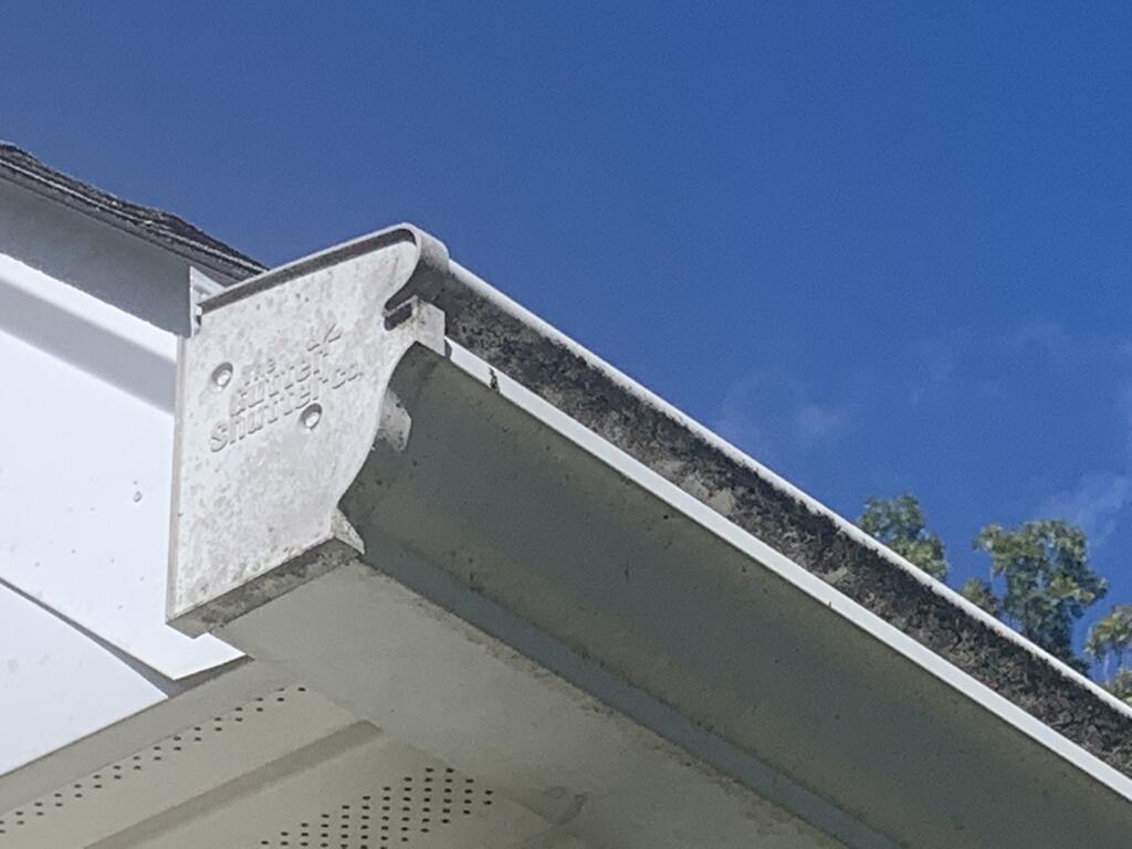

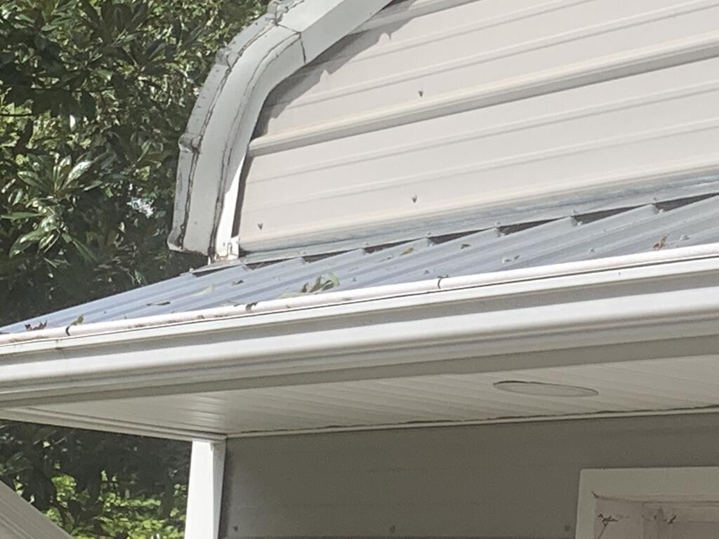

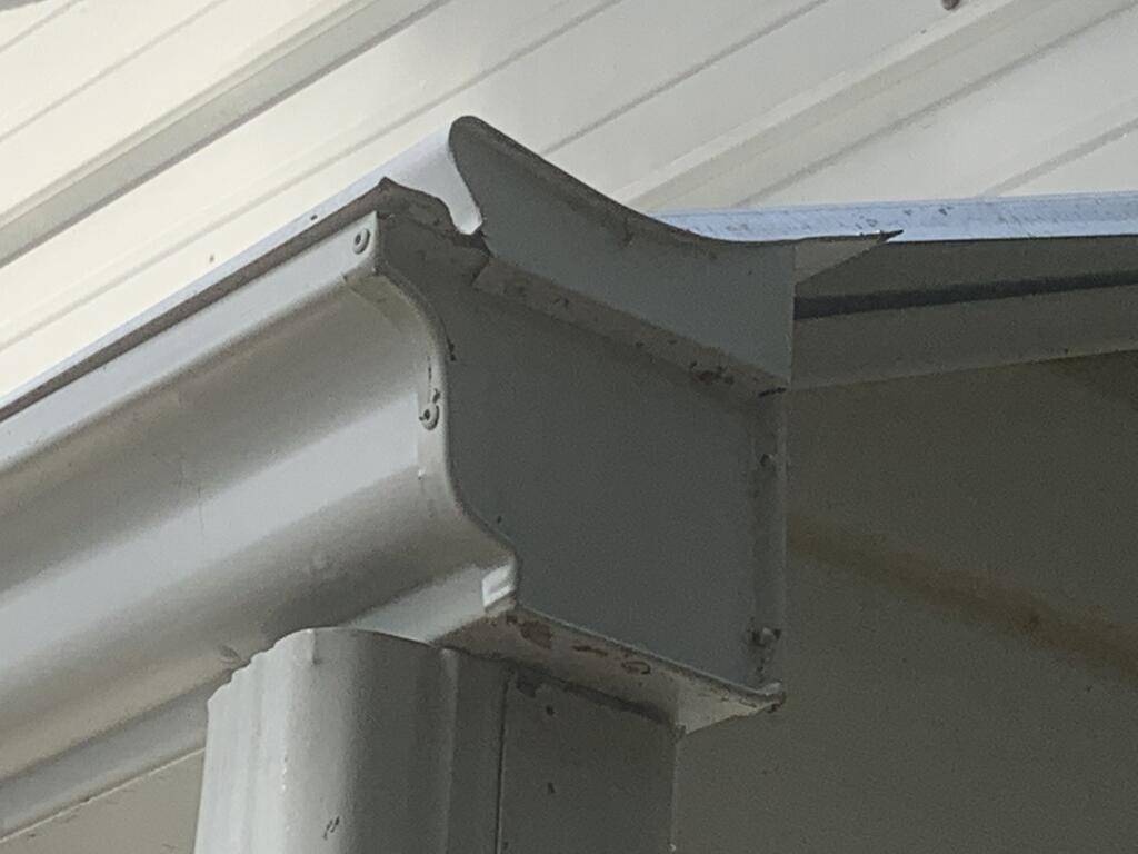

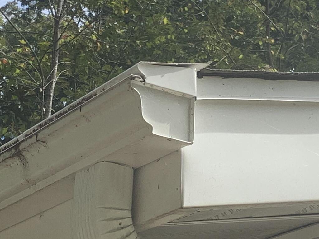

Horse Newbie 7,405 #14 Posted October 2, 2022 When we bought our house (average snowfall about 2 inches every 5 years or so), there were giant White Oaks on our wooded lot. I could see what we were in store for and commenced to getting estimates from gutter companies. We chose the first company that came out and gave us a demo. The Gutter Shutter’s are guaranteed for life against clogging, as are the oversized downspouts. When we have our roof replaced about 3 years ago the roofers discovered deck rot about a foot up from the bottom on significant areas. The rot was caused by improper installation of the starter strip of the shingle roof, not ice dams. The roof job came standard with 2 sheets of OSB , and we needed more. The roofing company allowed me to run to Lowes and buy some instead of paying their price of $75 per sheet. They also installed ice and water shield about 3 ft up from the bottom and valleys. The rot had however caused the facia boards to start pulling away from the ends of the rafters. After the roofers left I went all of the way around the house (about 400 ft) and screwed the facia boards back to the ends of the rafters with 4 inch long screws. By using the long screws I was able to get beyond the ends of the rafters where there was a small amount of rot. To get the screws in I had to remove and replace the tops of the gutters. So I literally hand washed the fronts, tops, and insides of all the gutters on the house. I was quite surprised when I found a very little amount of leaves in the gutters, and nowhere nearly an amount that would cause a clog. When I built my “horse” barn I use gutter from Lowes so that small run is not seamless gutter, but I can live with that. I used the snap on guards that are in the middle of the pic above. I made end caps for the ends to keep birds, not wasps out. I also used those gutter guards on the overhang portion I built onto the front of my shop. 3 Share this post Link to post Share on other sites
