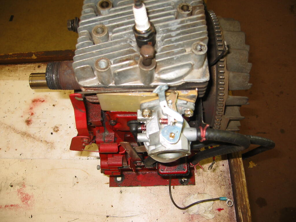

pfrederi 21,302 #4 Posted September 17, 2022 Some 10 hp Techies need a spacer plate to hold the carb out away from the block It is a tapered plate the yellow thing in the picture. 1 Share this post Link to post Share on other sites
pfrederi 21,302 #5 Posted September 17, 2022 I believe the plate is #31959 Share this post Link to post Share on other sites
Dadof2 5 #6 Posted September 18, 2022 Eric, I have the original carburetor and have tried cleaning it. It stays running on full choke only at this point and I am sure I cleaned all of the holes. I also had already bought a new one that was supposed to work for HH100 engines but I have a clearance problem as the choke lever is about half an inch closer to the block compared to the old one. I will try to rebuild it. Paul, I picked up a plate on Ebay just in case my rebuild doesn't work. Thanks for the part number! Share this post Link to post Share on other sites
