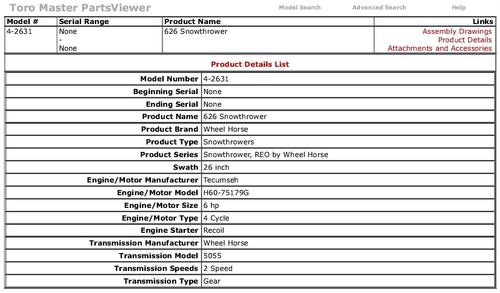

  10. Free
    Snowthrower 26in Walk behind 1968 6hp 4-2631 D&A.pdf 1.0.0
    Details only
    1 page 37KB
    Named a model 626 at Toro
    Uses 5055 transmission
    1968 26" snowthrower model 4-2631

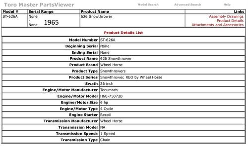

  15. Free
    Snowthrower 26in Walk behind 1965 6hp ST-626A Reo D&A.pdf
    Details only
    Snowthrower 1965 26in model ST-626A

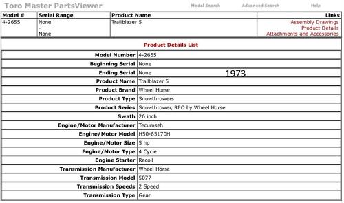

    Snowthrower 26in Walk behind 1973 5hp 4-2655 D&A TIPL sn.pdf
    Parts list from Toro Master Parts Viewer
    4 pages but no main unit illustration
    Details
    1 page
    4-2634 drive belts
    Impeller belt 6506 (4L x 31.91" or 1/2" x 31.91") [Gates 6832]
    Reverse belt 6552 (3L x 30.07" or 3/8" x 30.07") [Gates 6730]
    Transmission belt 6551 (3L x 30.5" or 3/8" x 30.5") [Gates 6731]
    Snowthrower 1973 Trailblazer 5 model 4-2655

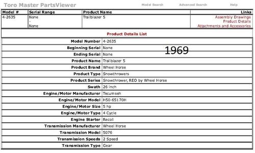

    Snowthrower 26in Walk behind 1969-1972 5hp 4-2635 D&A TPL sn.pdf
    Details - 1 page for each year
    Parts list from Toro Master Parts Viewer - 3 pages for each model but no main unit illustration
    4-2635 drive belts
    Snowthrower 1969 Trailblazer 5 model 4-2635
    Snowthrower 1970 Trailblazer 5 model 4-2635
    Snowthrower 1971 Trailblazer 5 model 4-2635
    Snowthrower 1972 Trailblazer 5 model 4-2635

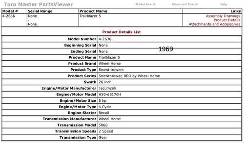

    Updated
  20. Free
    Snowthrower 26in Walk behind 1969-1972 5hp 4-2636 D&A TPL sn.pdf
    Parts list from Toro Master Parts Viewer - 3 pages for each model but no thrower illustration
    4-2636 drive belts
    Snowthrower 1969 Trailblazer 5 model 4-2636
    Snowthrower 1970 Trailblazer 5 model 4-2636
    Snowthrower 1971 Trailblazer 5 model 4-2636
    Snowthrower 1972 Trailblazer 5 model 4-2636

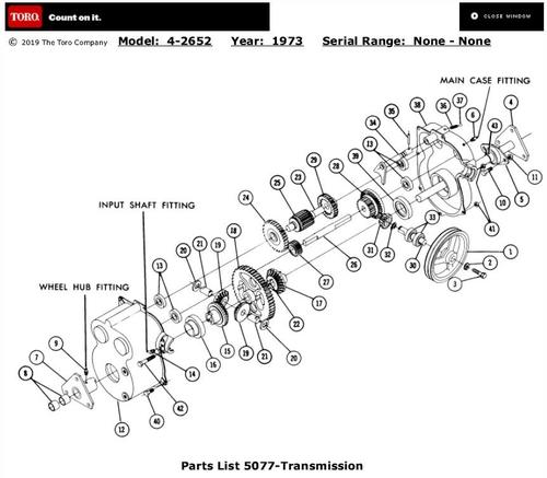

  21. Free
    Snowthrower 26in Walk behind 1973 7hp 4-2652 D&A TIPL SN.pdf
    Illustrated parts list from Toro Master Parts Viewer
    4 pages 208KB
    Details only - No attachment list but there was a 5-4321 32" rear discharge mower deck
    1 page 37KB
    Named a Trailblazer 7 at Toro
    Snowthrower 1973 26in model 4-2652
    1973 serial numbers that have shown up for the 4-2652
    0916406 - model 4-2652-8
    91 downloads

  23. Free
    Snowthrower 26in Walk behind 1967 6hp 4-2631 D&A.pdf
    Details only
    1 page 37KB
    1967 26" snowthrower model 4-2631
    64 downloads
