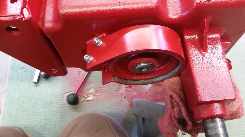

Couple of concerns  here ... brake band not lining up with the brake?? Please tell me the trans does not have to come back apart?

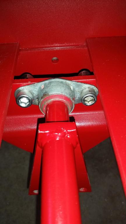

Steering gear, should the fan gear shaft spin in the socket ball or the ball spin in the socket? this was pack full of 50 year old grease but does not show wear. Is ther a way to add a lube zerk here or not needed? Right now because of new paint the ball wants to spin in the socket but cause of the old grease I'm sure it didn't  before.
Fan & support was thinking of adding a zerk here but shows sign of little wear
On the top side tho the socket that accepts the steering shat is quite worn. I guess what I am asking is what can I do now to try and tighten up the steering.?

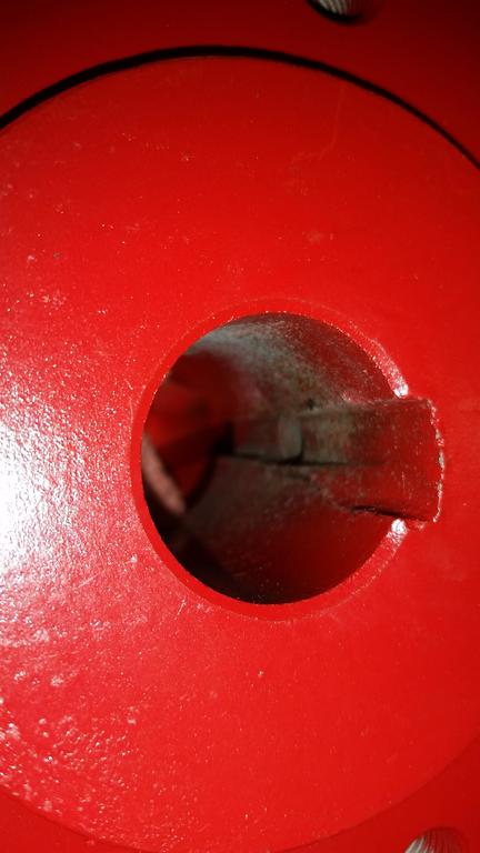

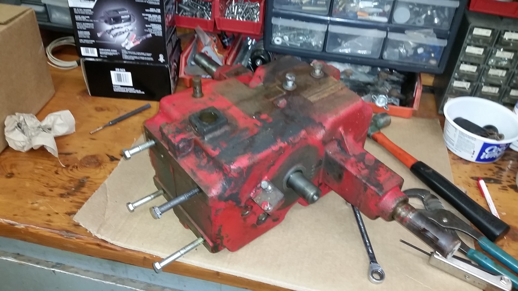

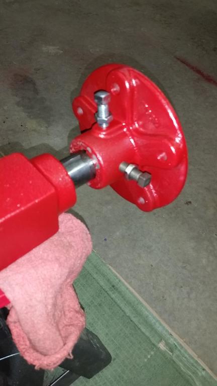

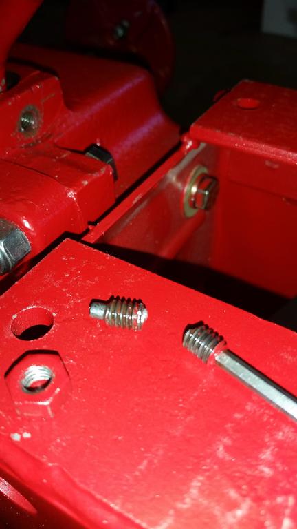

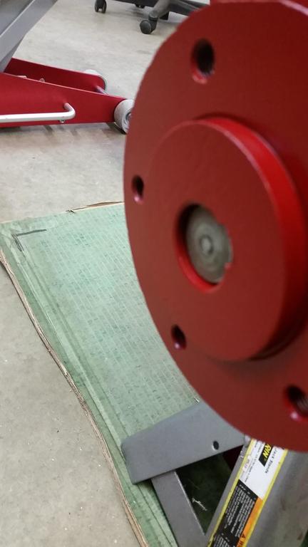

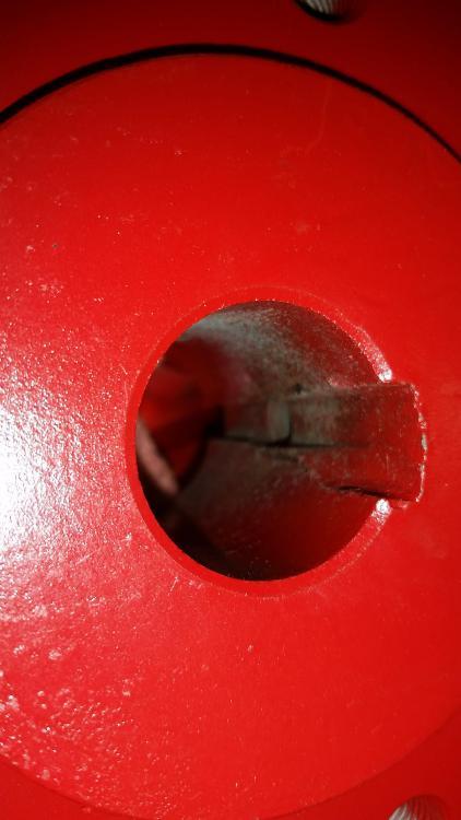

I think the MN boys got me straigtened out on this but is this hub usable? I did do another set screw.
Edited by WHX9
  • Like 7
Its close but they though it was usable. Still some good meat back in the keyway where the set screw is. I could bump out the hub to center the set over the woodruff but this would move out the hub. Here's the keyway.
Bumped out a tad set screw center over the woody..
Edited by WHX9
  • Like 6
Just wondering if you cleaned the paint off of the shaft where the ball sits? I found that having paint on any bearing surface can cause some issues.
This axle & hub look like they could've been a good candidate for my full length key trick. It would suck to take the tranny back apart now though.

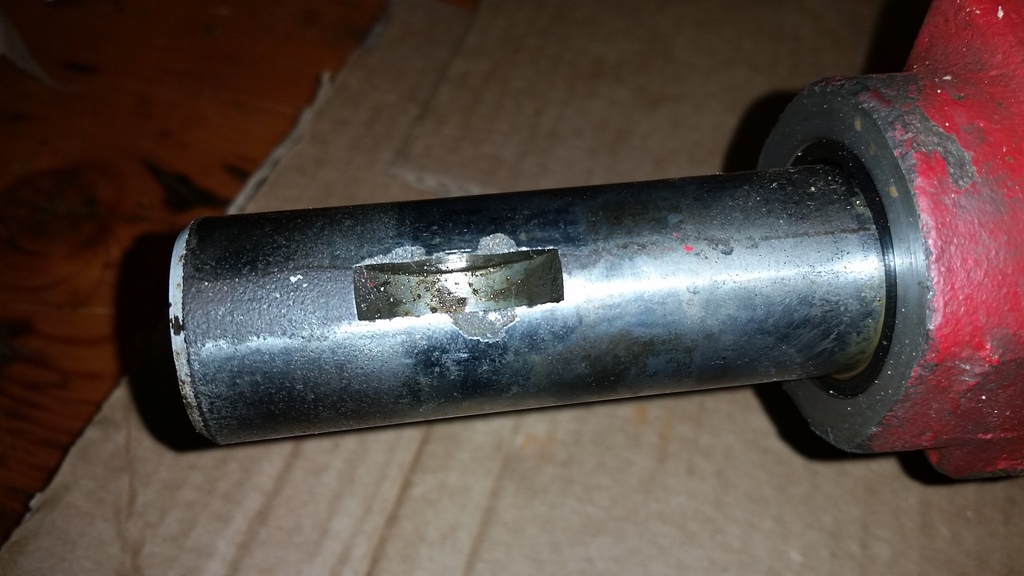

Did just that Dan last nite, on both ends & will pack with grease and run it like that. Once I get the hood stand & dash housing  on will have to see what can be done to avoid the quarter turn of the wheel slop. Fan gear looks good yet but the wheel shaft teeth have some wear. Will have to do a bushing or something  in the trunnion socket that's where most of the slop is going to be. Darn near an 1/8 in play there.  Hindsight being 20/20 I should have done a full length key but I don't have a machining center just down the street! I will run it as is and keep an eye on it. since hubs are out there yet easy enough to swap out if it becomes a problem. The nicks out of the axle aren't as bad as the pic shows and are fairly shallow. Keep the set screws tight & should be ok.

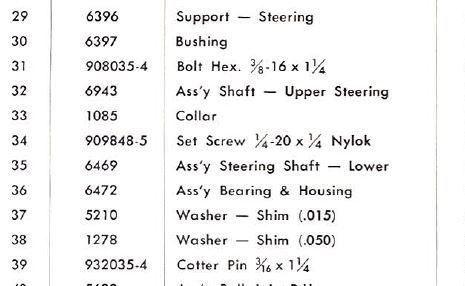

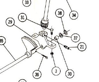

Getting back to the steering gear the IPL shows different size shims in there (37 & 38) as well as a bushing (30). This tractor did not have those on disassembly. I would guess the shims are to keep the fan gear drawn up against the steering shaft?
  • Like 1
Putting these shims in should get rid of your steering slop. If you happen to have some HD wheel bearing shims laying around, they would work perfectly. You could also try a 14ga machine washer, but they are around .075" thick.

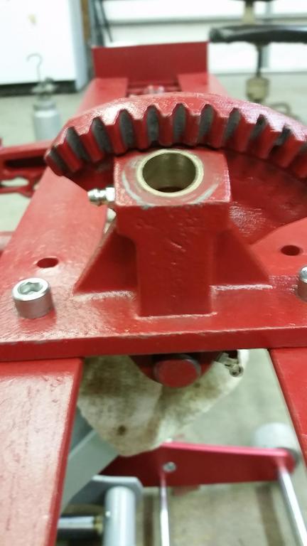

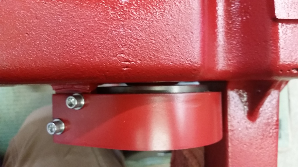

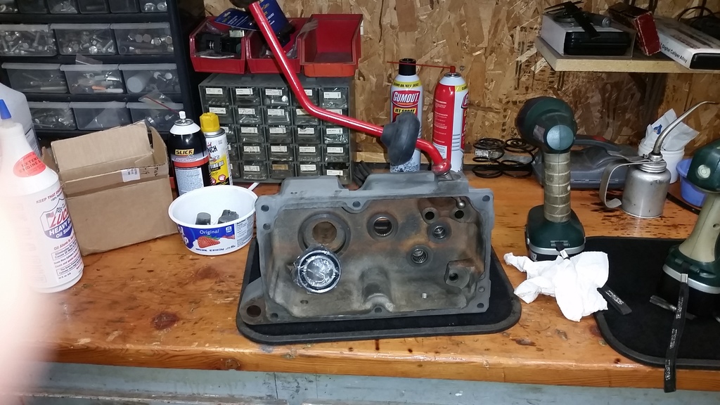

Not much got done this past weekend....weather was way too nice to be inside and trying to get in some late season ice fishing but did work a little with the overhead open. Fitted a bushing in the steering shaft support. Note the zerk in the lower steering shaft support. Not much wear in this area but what the heck I love drilling & tapping cast. The bushing is going to help slop and also toying with the idea of a spring in the lower shaft to keep the fan gear drawn up again't the upper shaft gear instead of shims.

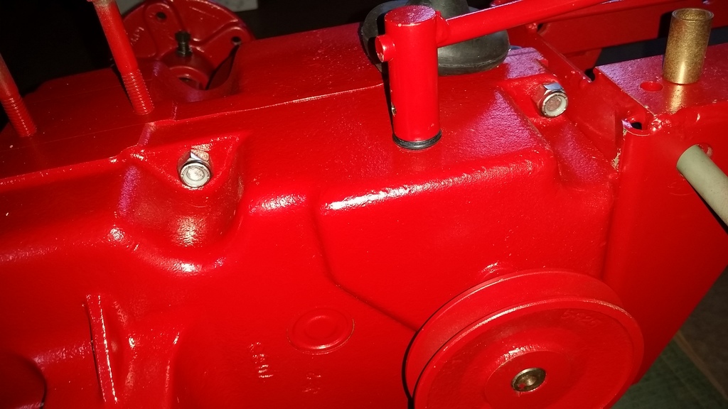

Another small idea here, since I have been know to give a horse a bath once in awhile and get caught in the rain at shows I came up with to (maybe?) help keep water out of the tranny. O-rings to form a seal under the high low shift lever to act as a seal. I noticed ther was some play in the shaft hole where water could seep in. I would venture to guess the o-rings will rot out over time but it took all of a minute in the o-ring assortment kit to do and :wicked: cheap!

It can't be seen on my pics since I painted tranny black, however I pilfered your idea and similarly added orings to the high low shifter. Kudos!

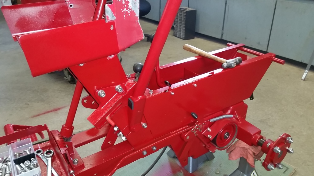

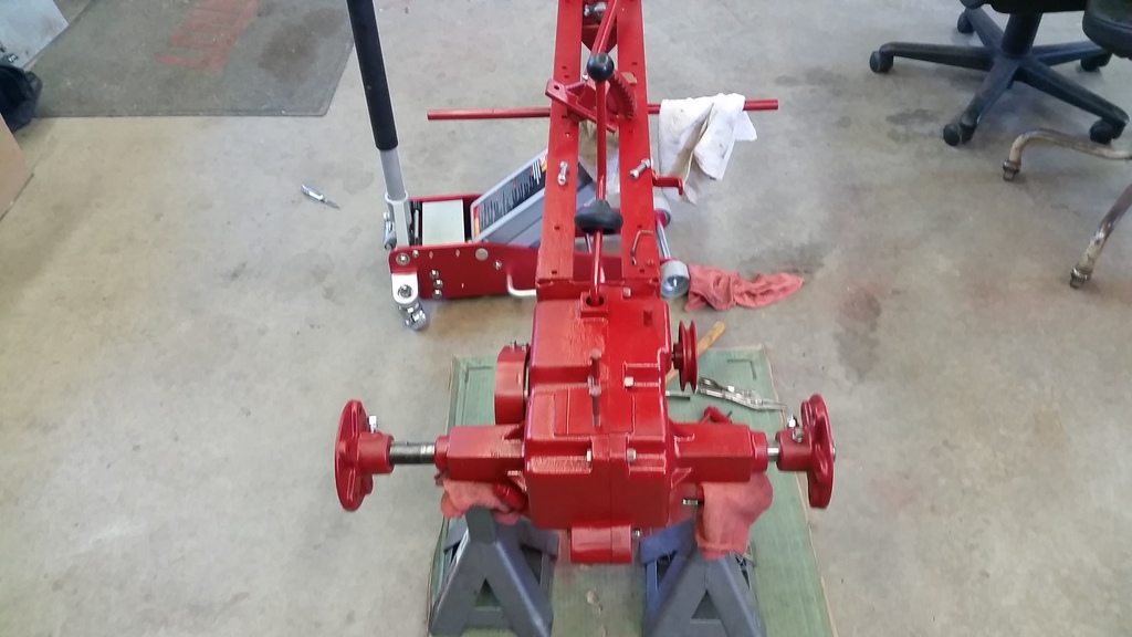

The whole weekend to myself for a change, well almost, but did mange to get a few things done on this project. If I would get off my keester and get some rear rubber ordered would have a roller!

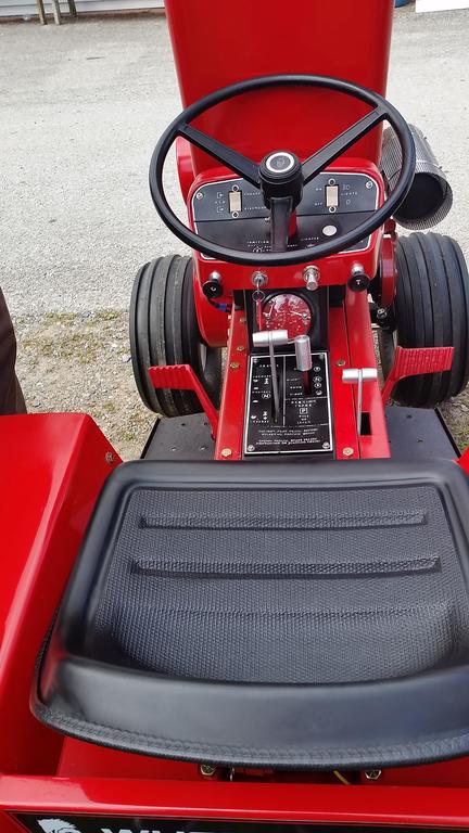

Fitting the dash housing up. Plan on polishing the dash, no paint just clearcoat. Saw another tractor that was done like that and was kinda cool so see how it looks. Can always paint it down the road if it doesn't look right.
It was in the cards that these rims get finished.....52 pickup anyone... @achto says you get a better finish if you use all RED cards! :lol:
  • Like 9
