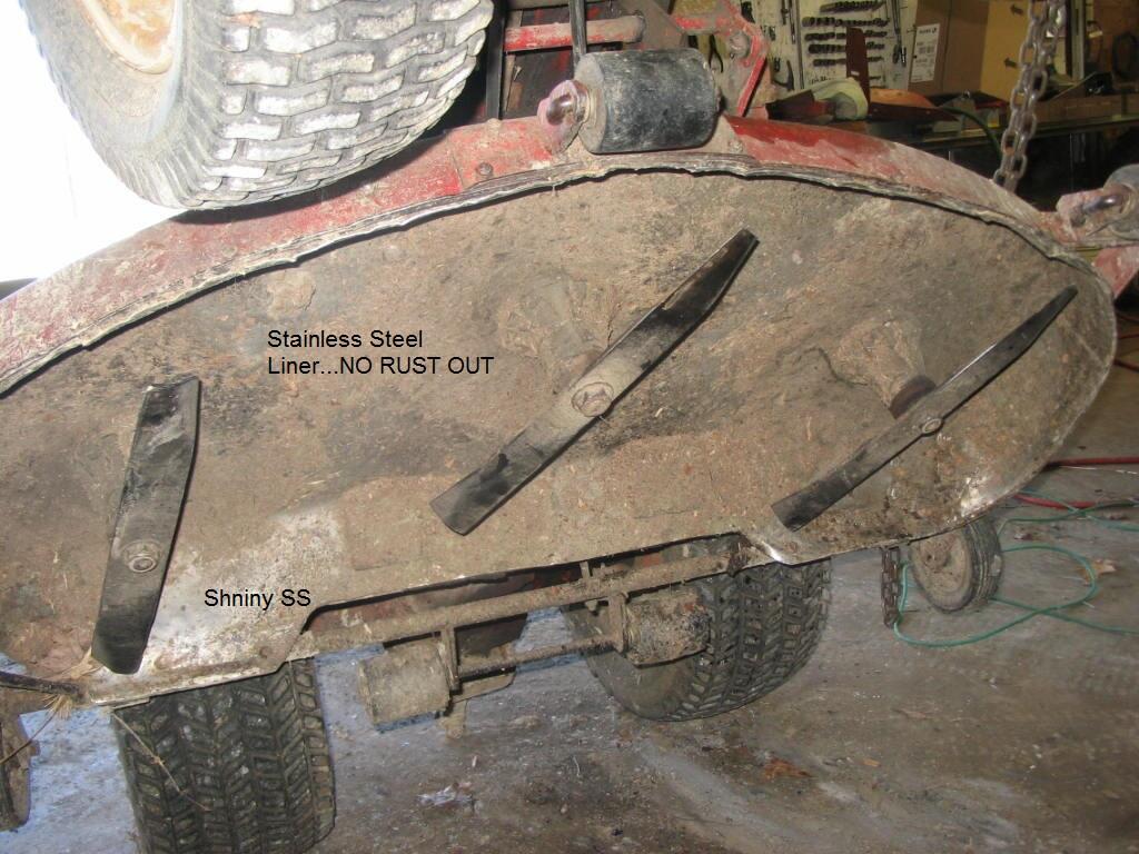

daveoman1966 3,884 #3 Posted September 10, 2022 30+ years ago, I made a stainless steel liner for my 48" deck. Not tuff to do, and lasts FOREVER...or LONGER. Take ALL the hardware off of deck shell. Make a cardboard template of the deck flat surface, trimming out ALL the bolt and spindle hole locations. Transfer that template to a sheet of SS and cut it out. Use a 2nd piece of SS about 4-5" wide 60" or so long, and tack it around the inside FRONT vertical face of the deck. NO MORE RUST....EVER! 3 2 Share this post Link to post Share on other sites
