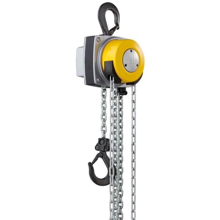

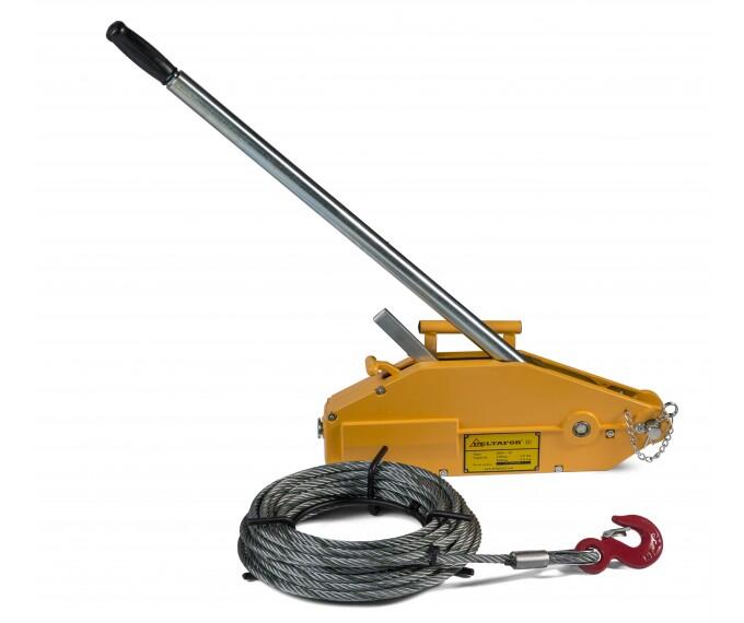

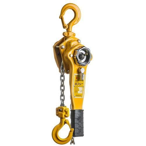

sjoemie himself 3,112 #31 Posted September 6, 2022 (edited) @ebinmaine long story short, for light and medium duty, lets say up to half a metric tonne you'll be fine using a cable type come along. Short story long : This is for vertical transport only. It's construction makes it unpleasant to use horizontally even though it COULD do it. Pro: - has an emergency brake. Prevents load from dropping suddenly. - Has stopper on end of chain. - Easily move (very) heavy loads. - Easy to switch from 'lift' to 'lower' Con: - moves slow. - chain can get in the way - heavy This is for vertical and horizontal transport. Shorter chain and ratcheting handle makes it suitable for all kinds of lifting and pulling. Pro: - Universal use, (good ones) also has a emergency brake. Prevents load from dropping suddenly. - Has stopper on end of chain. - Easy to switch from 'lift' to 'lower' - Easy to use and setup - Relatively small and lightweight Con: - moves slow. - chain can get in the way This is for horizontal pulling only! It's construction makes it easy to use in a horizontal manner and eventhough you COULD use it to lift, you really SHOULD NOT. See instruction manual. Pro: - easy to use - moves medium loads pretty fast - looooong cables are available for long distance use (can be daisy chained). - relatively light compared to working range (length) Con: - doesn't have stopper on end of cable. - Does not have an emergency brake. - Difficult to control when switching from pull to release. I've worked at a rental company for 12,5 years and among other things I took care of getting chainfalls, come alongs and cable pullers anually inspected. Also gave instructions to collegues and clients what (not) to do with equipment like this. Studied many manuals to answer much of the questions those people had. Hope this info helps. If you have a potential purchase on your radar and would like some more advice, let me know. Edited September 6, 2022 by sjoemie himself Typo 1 4 Share this post Link to post Share on other sites

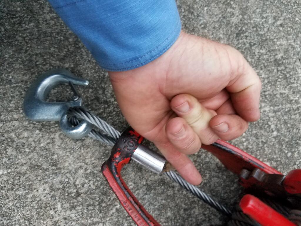

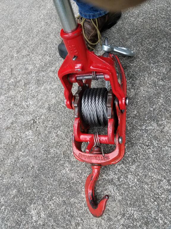

GAJoe 852 #35 Posted December 13, 2022 On 9/6/2022 at 5:55 AM, ebinmaine said: I need to pick up a couple of medium duty hand winches or come alongs and I was wondering what you folks use. My specific usage would be for assistance in pulling trees over that have hung up partially standing, moving a dead tractor once in awhile, possibly pulling one up onto a trailer or truck. Do you use a chain winch or cable winch? Do you use a different method? Do you recommend for or against any particular brand? Thoughts comments questions suggestions appreciated. I guess these wouldn't qualify as medium duty. They are built like a Wheel Horse; heavy, strong, powerful and can be refurbished. Almost forgot, RED. That's a 5/16" wire rope, duel paw, cast iron. 2 Share this post Link to post Share on other sites
ebinmaine 79,297 #36 Posted December 13, 2022 8 minutes ago, GAJoe said: I guess these wouldn't qualify as medium duty. They are built like a Wheel Horse; heavy, strong, powerful and can be refurbished. Almost forgot, RED. That's a 5/16" wire rope, duel paw, cast iron. WOW! That's a hand winch! Share this post Link to post Share on other sites
GAJoe 852 #37 Posted December 13, 2022 Check out their site for the history. It dates back to 1934 I believe. https://www.wyeth-scott.com/ 1 Share this post Link to post Share on other sites
GAJoe 852 #38 Posted December 13, 2022 The guys on here saying that cable will work you harder than chain reminds me of my first adventure with my Wyeth-Scott More Power Puller. I had just finished the refurbish and looking for an opportunity to put it to the test. I had called my 88 year old Dad and he was freshly upset again that when the state widened the road in front of his house they made the driveway steeper than it already was. He didn't get off his clutch fast enough or it was slipping and wound up off the driveway and stuck in the leaves. He was going to hand truck his big battery powered winch up there the next day to pull it back onto the drive. I made the drive down early the next day and got set up to impress my Dad with my new hand winch. He came out to supervise and I got hooked up to the truck to his satisfaction. He was standing in the open driver door so I warned him to get clear. I started pumping the handle and the cable pulled tight. It got so tight that I draped my coat over it. The truck began moving but each couple inches was a work out. I was now getting the hardest cardio' work-out in years and the Ford Ranger had only moved a couple feet. I had just about decided that this hand witching was for the birds when my Dad started yelling " HOLD IT! HOLD IT! LET ME RELEASE THE PARKING BRAKE! Oh my gosh it got easier. A memory for life that brings a laugh now. Sorry to be long winded but I thought that you guys might enjoy. 4 Share this post Link to post Share on other sites
