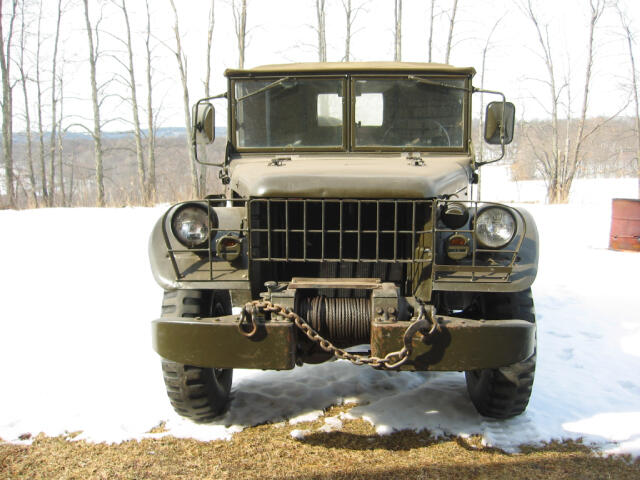

pfrederi 21,005 #10 Posted September 6, 2022 Beats hand winching...8,000lbs and have a snatchblock to make 16,000 2 8 1 Share this post Link to post Share on other sites
ri702bill 12,701 #11 Posted September 6, 2022 (edited) 19 minutes ago, pfrederi said: 8,000lbs and have a snatchblock to make 16,000 6x6 Deuce and a half??? I see from your signature that it might be a M37 Dodge - Powerwagon. Edited September 6, 2022 by ri702bill 2 Share this post Link to post Share on other sites
pfrederi 21,005 #12 Posted September 6, 2022 23 minutes ago, ri702bill said: 6x6 Deuce and a half??? I see from your signature that it might be a M37 Dodge - Powerwagon. 1953 M-37 1 1 Share this post Link to post Share on other sites
The Freightliner Guy 1,364 #13 Posted September 6, 2022 Sweet truck wouldn’t recommend the sand dunes much to much wheel hop from the vids I’ve seen Share this post Link to post Share on other sites
ebinmaine 80,103 #14 Posted September 6, 2022 37 minutes ago, pfrederi said: Beats hand winching...8,000lbs and have a snatchblock to make 16,000 Love the idea but it's just a hair too big for our trail system. 2 3 Share this post Link to post Share on other sites

pfrederi 21,005 #22 Posted September 6, 2022 (edited) 1 hour ago, ebinmaine said: I should clarify that. I don't mind cutting wider pathways. It's the bridge or two that would be restrictive by size. I have a fording kit. M-37s don't need no stinking bridges... Can do 42" depth without putting the kit on... Edited September 6, 2022 by pfrederi 1 2 1 1 Share this post Link to post Share on other sites
