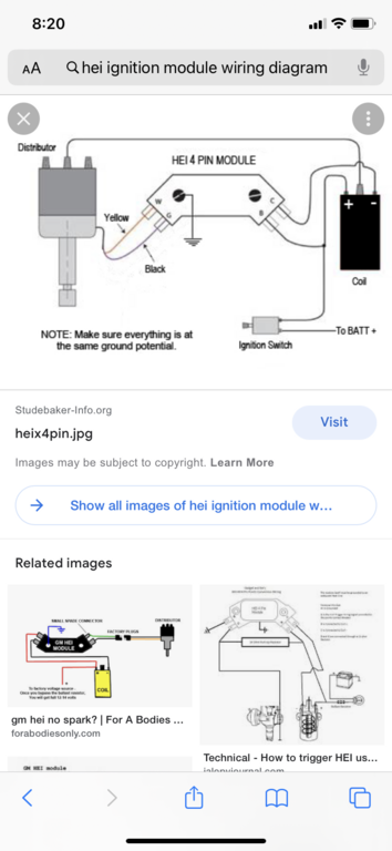

Snoopy11 5,731 #29 Posted August 23, 2022 (edited) 6 minutes ago, ebinmaine said: Check this one out.... I wish I had more electrical knowledge... 'dat stuff seems complicated to me... (I know it's not... but electrical stuff is not my cup of tea...) Basically my understanding is that, power is flowing through the sensor, (circuit gets completed when the trigger points pass the sensor)... that triggers the coil to fire. Okay, makes sense. BUT what I don't understand is what the HEI module does...? Don Edited August 23, 2022 by Snoopy11 Share this post Link to post Share on other sites
ebinmaine 81,139 #30 Posted August 23, 2022 My understanding is that the module is sort of like the switch that actually turns the power on and off to the spark plug 1 Share this post Link to post Share on other sites

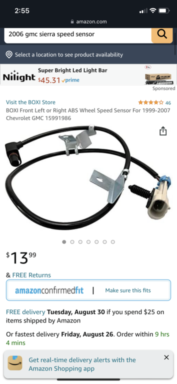

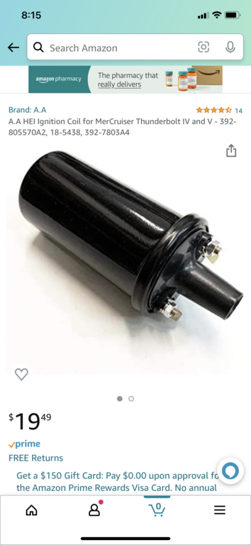

Heatingman 977 #36 Posted August 24, 2022 (edited) @Snoopy11 here are the parts and a simple schematic. Dont need to be those exact brand parts but should look the same, and you can probably find some stuff at a junk yard. The HEI modules are usually tucked inside the distributor. Think its like 1990’s to early 2000’s tech. also maybe somewhere like rock auto or something has them cheaper. The HEI module needs to be mounted to a good ground, as thats what it switches to the ignition coil - the ground path. in the schematic, the yellow and black wires would go to the wheel speed sensor wires instead. And if you do end up doing this, make the wheel speed (pick up sensor) bracket adjustable, as its distance from the pins on the flywheel is what advances and retards the spark timing. Edited August 24, 2022 by Heatingman 3 Share this post Link to post Share on other sites

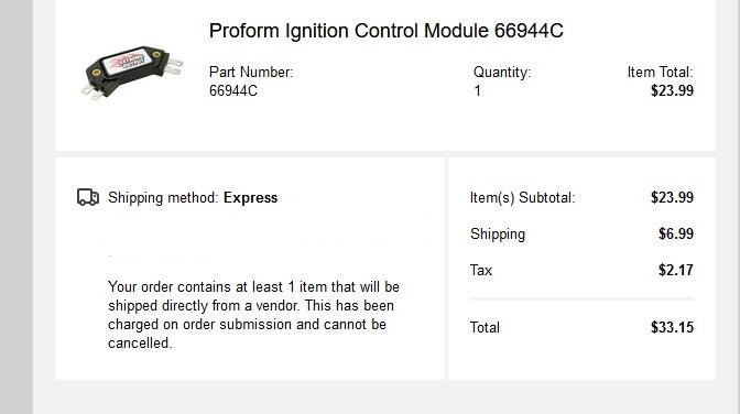

Snoopy11 5,731 #38 Posted August 24, 2022 So, I just bought a Proform 66944C control module. I believe I have a coil around here somewhere although @peter lena may have to send out the search party to find me once I go looking for it... I am in the hunt for a speed sensor now. Only problem is... this engine is falling to other priorities here on the funny farm. Every day something new breaks around here... now it's the golf cart. I guess my parts will just sit in the back of the truck with the engine until I get caught up around here... Don 1 Share this post Link to post Share on other sites

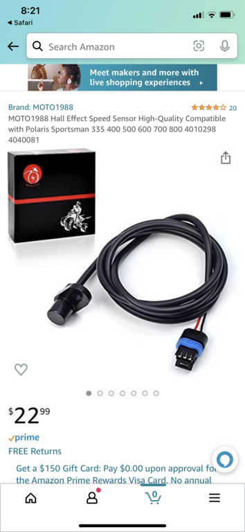

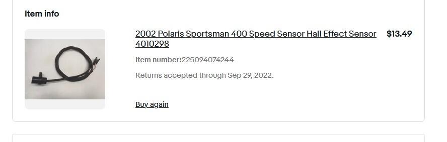

Snoopy11 5,731 #43 Posted August 24, 2022 Hey @Heatingman... one question for you. So... the hall effect sensor obviously comes with 3 wires... red, white, and black. Can you tell me how those get wired? Don Share this post Link to post Share on other sites

Heatingman 977 #46 Posted August 24, 2022 3 hours ago, Snoopy11 said: Hey @Heatingman... one question for you. So... the hall effect sensor obviously comes with 3 wires... red, white, and black. Can you tell me how those get wired? Don I may have selected the wrong speed sensor type. I thought that one was a 2 wire. The white must have blended into the background. Hopefully you can return that if need be or cancel the order. Let me find a 2 wire version. Share this post Link to post Share on other sites
Heatingman 977 #47 Posted August 24, 2022 Heres a 2 wire version. My apologies. Share this post Link to post Share on other sites

Snoopy11 5,731 #49 Posted August 24, 2022 3 hours ago, Heatingman said: Hopefully you can return that if need be or cancel the order. Uh oh... it already shipped... Don Share this post Link to post Share on other sites
ebinmaine 81,139 #50 Posted August 24, 2022 23 minutes ago, Snoopy11 said: Uh oh... it already shipped... Don Amaz'n ? It's returnable... No worries. 1 Share this post Link to post Share on other sites
