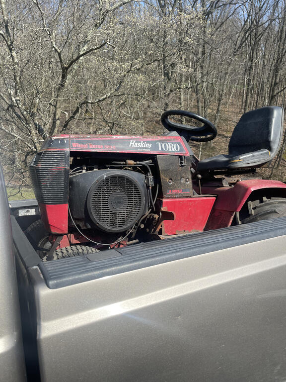

Desko 686 #1 Posted August 17, 2022 I figured I should start a thread for my 520 so here goes. Earlier this year I happened to pick up a 520-8 that had seen better days but it was a model I always wanted so I made the 10 hour round trip to go and get it. It didn't run or even crank when I got it which turned out to be a bad 9 pin connector and some safety switches so with those temporarily jumped out and a fresh battery the onan came to life had a surge to it and needed choke to stay alive but judging by the color and smell of the fuel it had been many years since it ran. Fast forward to now and some updates in between on the "what have you done to your wheel horse" thread I've been slowly pulling it apart and gathering parts as needed. It has an electric lift that I'm changing back over to manual lift due to preference and the electric lift seems to hit the support of the hood stand. So today I finally got it down to just a frame and axles to start the process of deep cleaning it! Attached below is a picture of the day I brought it home and now. 8 4 Share this post Link to post Share on other sites

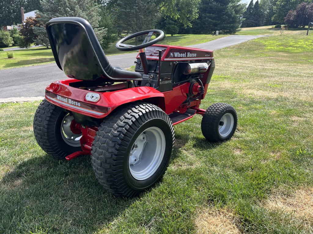

stevebo-(Moderator) 8,742 #2 Posted August 18, 2022 Looks like your gonna do it right. I used victory red auto paint which is a Gm color. Spot on. 1 Share this post Link to post Share on other sites

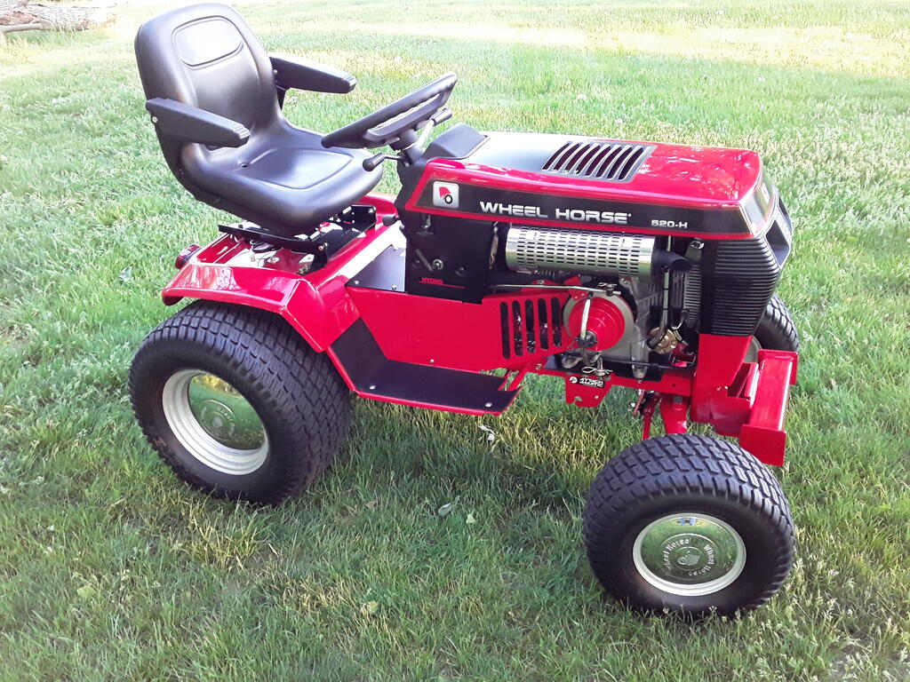

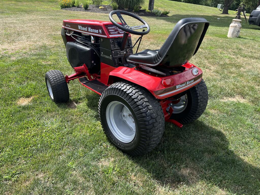

stevebo-(Moderator) 8,742 #4 Posted August 18, 2022 The correct wheel color is silver not white. Here is my 417 I just finished and is spot on the correct color. Sprayed using gun of course 6 5 Share this post Link to post Share on other sites
c-series don 12,473 #5 Posted August 18, 2022 @stevebo I can’t believe you posted that picture with a missing tail light lens. You know better than that!! 1 7 Share this post Link to post Share on other sites
ineedanother 2,870 #6 Posted August 18, 2022 31 minutes ago, stevebo said: The correct wheel color is silver not white. Here is my 417 I just finished and is spot on the correct color. Sprayed using gun of course No argument here and that's a pretty machine! I'm putting the Navajo White on a c-160 and I think the correct wheel color is debatable so I'm just going with a classic look. 2 1 Share this post Link to post Share on other sites

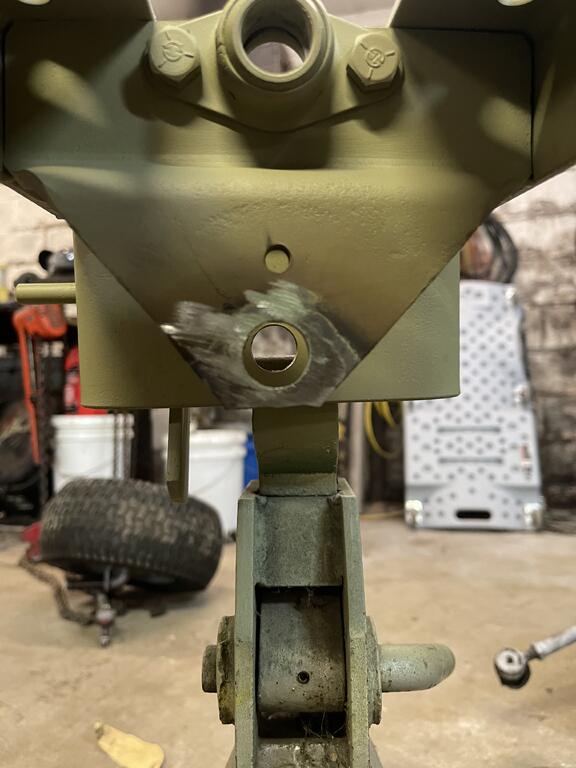

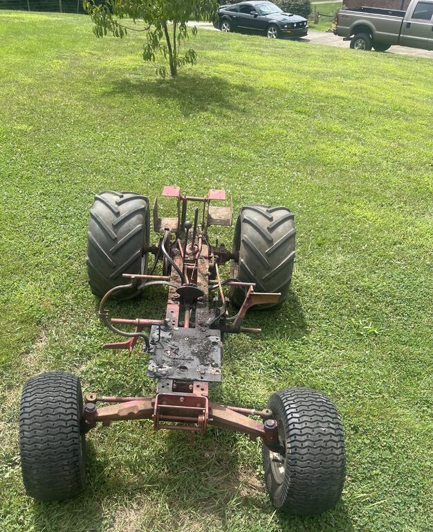

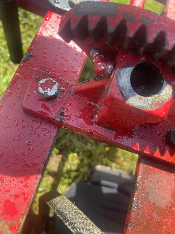

Desko 686 #10 Posted August 19, 2022 So with some more cleaning from yesterday it's actually red under all that grime and grease. I did find that the lower steering support is broken which would explain the out of wack steering wheel and the skipping of teeth from time to time. No worries we'll get it welded back together and good as new! 3 1 Share this post Link to post Share on other sites

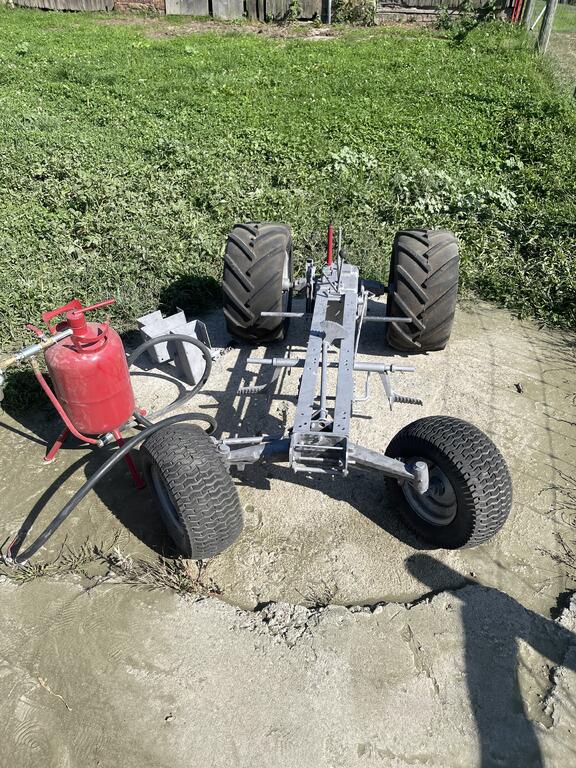

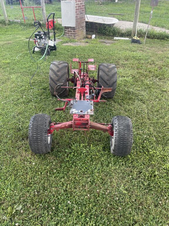

Desko 686 #11 Posted August 20, 2022 Just like the sheet metal I decided to sand blast the frame and axles it takes some time but I think it turned out well. A coworker gave me the little HF 20lbs pressurized blaster and overall no complaints with it you just have to keep an eye on the dryer to make sure you don't get any moisture in it. I'm going to try and get the rest of the parts stripped off it so I can get some etching primer on it this weekend. 4 1 Share this post Link to post Share on other sites
ineedanother 2,870 #12 Posted August 20, 2022 37 minutes ago, Desko said: Just like the sheet metal I decided to sand blast the frame and axles it takes some time but I think it turned out well. A coworker gave me the little HF 20lbs pressurized blaster and overall no complaints with it you just have to keep an eye on the dryer to make sure you don't get any moisture in it. I'm going to try and get the rest of the parts stripped off it so I can get some etching primer on it this weekend. Looks good. I have that same blaster but have only used it a couple times. Medium coal slag, or something else? Share this post Link to post Share on other sites
Desko 686 #13 Posted August 20, 2022 58 minutes ago, ineedanother said: Looks good. I have that same blaster but have only used it a couple times. Medium coal slag, or something else? I'm using fine coal slag in it seems to work really good. If you can keep it from clogging you can blast just as fast as you can move. It took just under 50lbs to do all that. 2 Share this post Link to post Share on other sites
Desko 686 #14 Posted August 24, 2022 Well the weekend has came and passed but it was productive. I pulled it down the rest of the way to paint starting with the rear hubs and did they put up a fight! I broke about 3 pullers before getting both of them off and had to rig the last one together to get the last hub the rest of the way off. Once it's all painted I'll be replacing all the seals in the transmission because they were leaking from the get go. The lower steering support we tried welding ended up breaking while letting the weld cool so a newly used on is on order. I didn't catch it before I painted but the axle pin hole was also wore out so we welded it up and punched it back out to 3/4". There's been a lot of bent of messed up parts on this old girl and it only has 400 hours on it! 4 Share this post Link to post Share on other sites

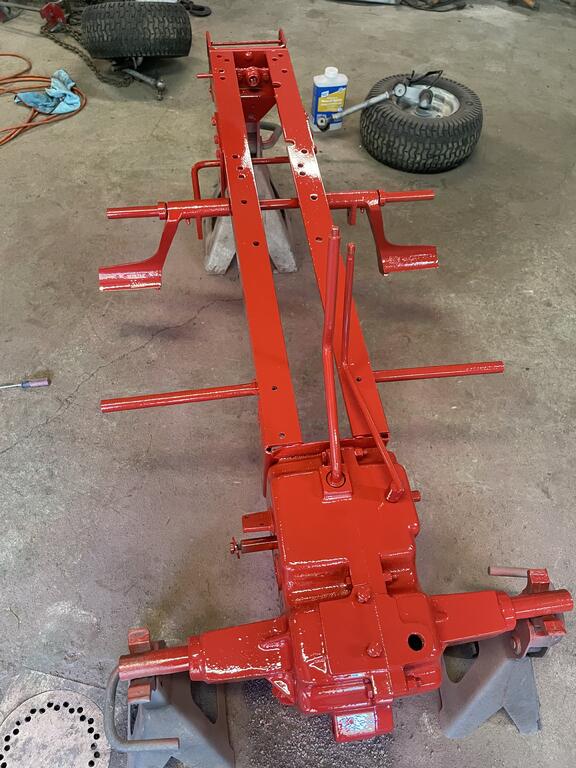

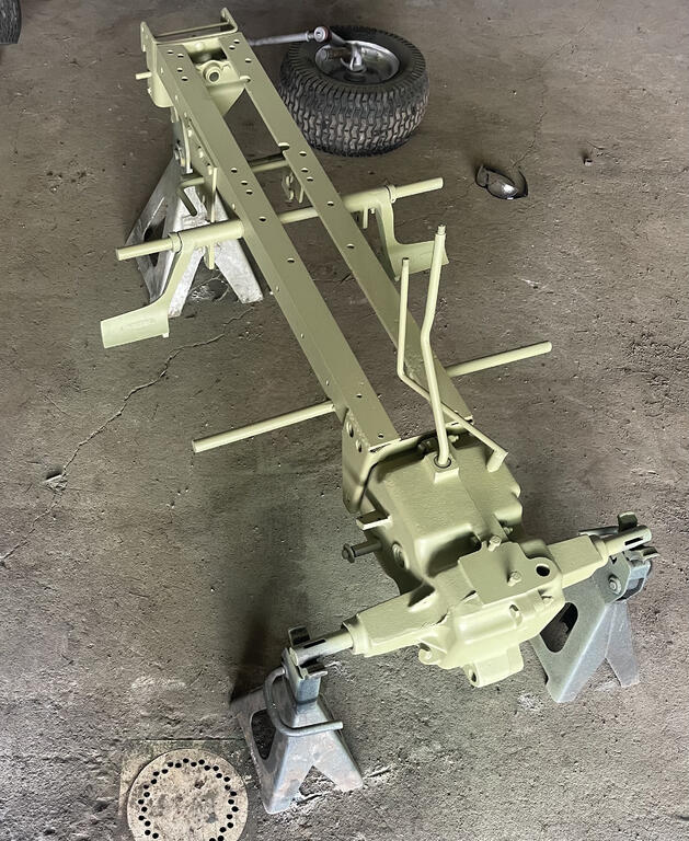

Desko 686 #15 Posted August 26, 2022 Well the frame is red! It's a little brighter then I thought it would be but I'm happy with it. My question is when did WH/toro start using zinc plated pins for the tach a matic system? I noticed on my 94 416H that they're all zinc plated along with most if not all of the bolts. From what I can tell this 520 has never been repainted and the bolts and pins etc were all painted red and that's how I did it while painting it also while I like the attention to detail look I'm trying for the originally the way it came as possible look because it will still be a worker with a 60" deck under it. 2 Share this post Link to post Share on other sites

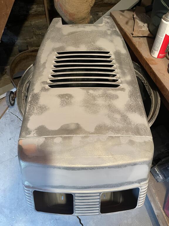

Desko 686 #19 Posted October 3, 2022 Well it's been a hot minute but I did have time to get back on the 520. I started with the hood which was in poor shape to say the least. So with some bondo, filler primer, and lots of block sanding I got it fairly smooth and straight. I went to paint the rest of the tins and miscellaneous parts and I don't know if it was a paint or thinner problem or even a me problem lol but I sprayed it on and it looked good then in no time flat the fender pan paint started to sag then the belt guards followed. The hood turned out nice which is what's weird to me because all the pieces were prepped exactly the same aside from mixing up more paint. So now we wait for it to dry and sand it all back smooth and try again. 4 1 Share this post Link to post Share on other sites

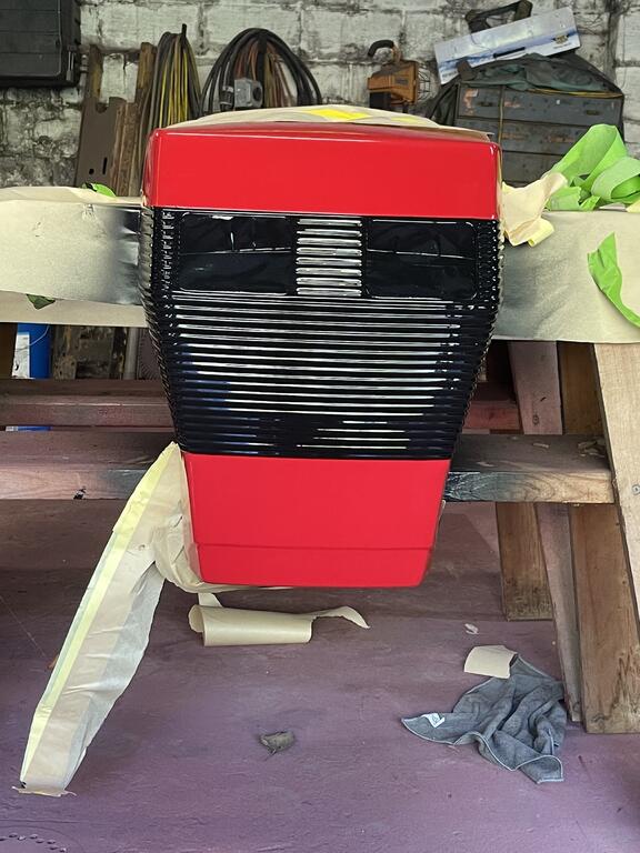

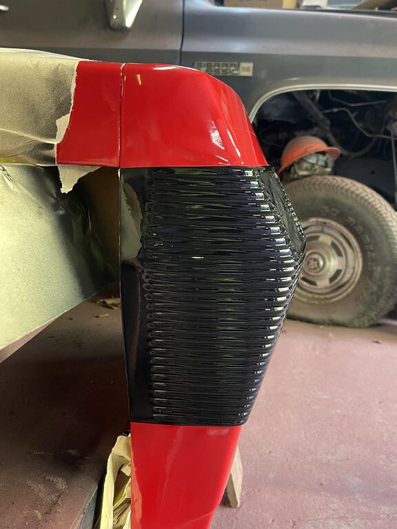

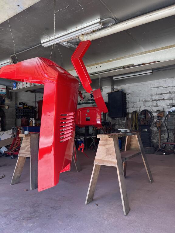

Desko 686 #22 Posted September 7, 2024 Well the hood has it’s signature satin black front. It turned out fairly well but it certainly was nerve wracking making sure I got it right and masked off properly. My only gripe and maybe it’s me being critical is having to cheat the tape line on the RH side so it lined up properly with the rest of the hood. But this hood was twisted and some spot welds were broke out along with the grill being pushed in so all things considered I’ll take it 7 Share this post Link to post Share on other sites
peter lena 10,070 #23 Posted September 7, 2024 @Desko nice work on that ! your empty frame pictures , thinking a 5/16 steel brake line inside the corner edge of frame for a fuel line , then compression swage lok fittings for shorter rubber hose connection from tank to carb , reducing the fuel hose break down scenario , just a thought , pete 1 Share this post Link to post Share on other sites

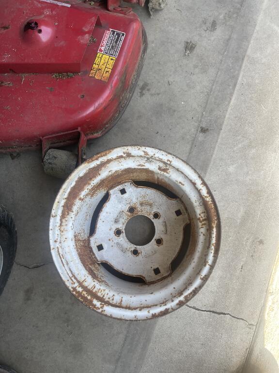

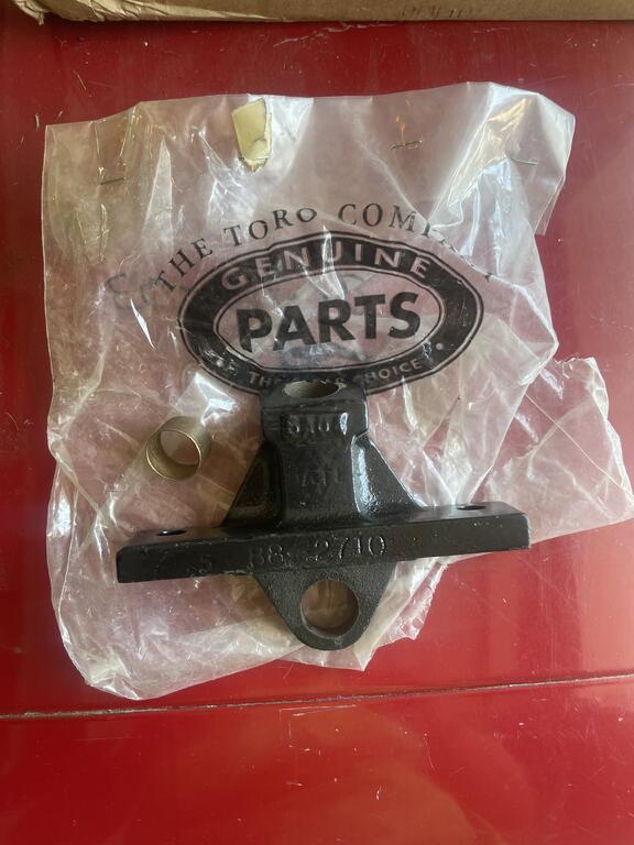

peter lena 10,070 #24 Posted September 8, 2024 @Desko made the change over to STA BIL fuel storage additive years ago , since then no fuel hose break down at all , changed out all existing rubber lines , with fresh hose and 2 filters 1 large close to tank , another small close to carb , no debris at all frome cleaned tank , also zero debris in carb bowl . add an ounce of stabil to all my tank top offs , and no fuel issues , regularly get after chronic issues , and eliminate them . very often just a small improvement to original set up , washers , snug up , lubrication , functional observation , back of dash pto lever set up , improvement , works effortlessly . pulley function , tracking , is basically LUBRICATION FAILURE . all my outer bearings , are lucas heavy duty polyurea , RE GREASED , quiet solid very smooth . like a chronic problem to show me the way , to modify and eliminate it . glad to see your set up , good job , pete 1 Share this post Link to post Share on other sites
