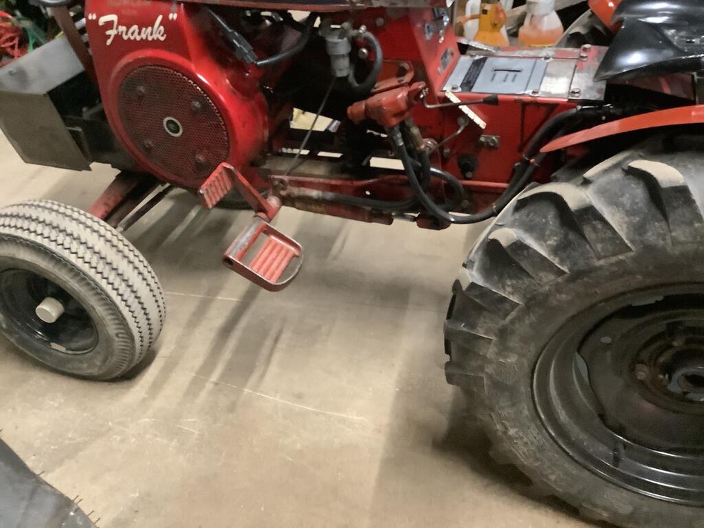

Pullstart 71,561 #6 Posted August 15, 2022 You can fit a shaker plate engine without the plate on a Frank-enstein! 1 Share this post Link to post Share on other sites

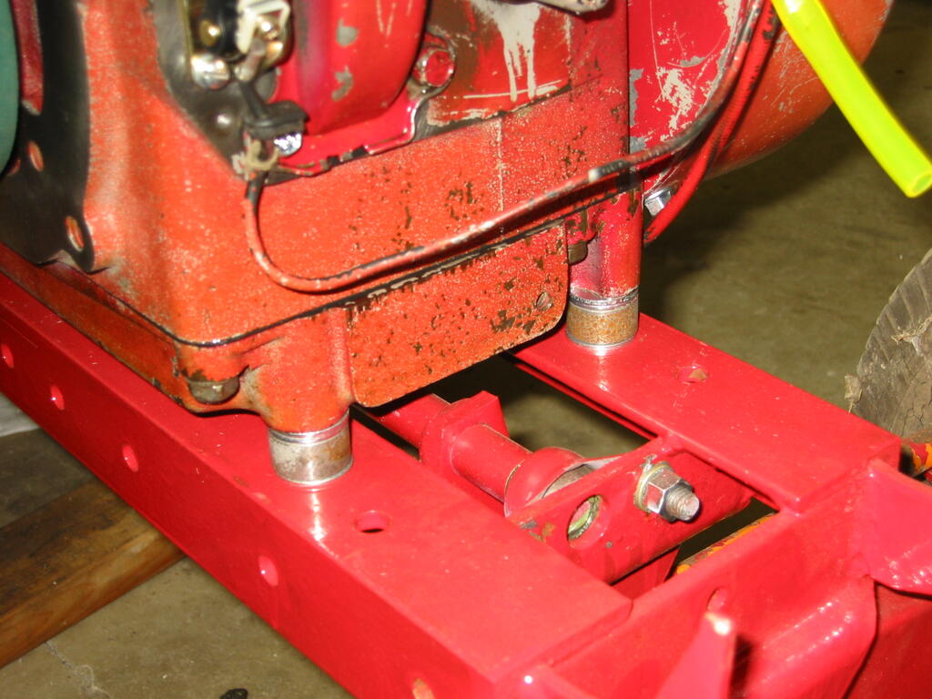

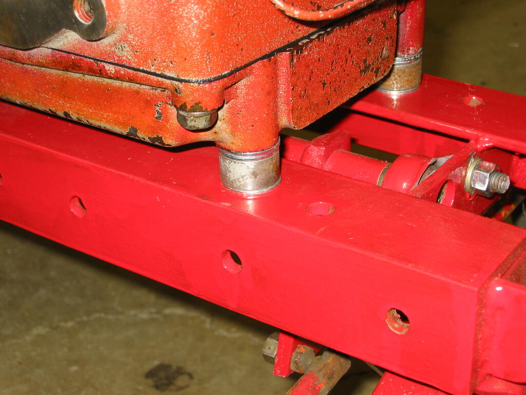

pfrederi 21,342 #7 Posted August 16, 2022 Small base blocks as used for shaker mounts will not directly accept the bigger oil pans. No heed to change anything just get some spacers and you may have to drill two new holes in the frame. Put a Shaker mount K341 with the small oil pan on an Electro12 frame. No drive pulley Belt guard mods needed. PTO worked also 2 1 1 Share this post Link to post Share on other sites
