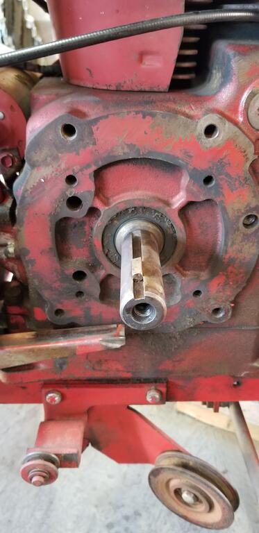

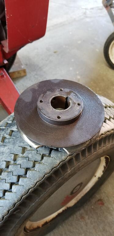

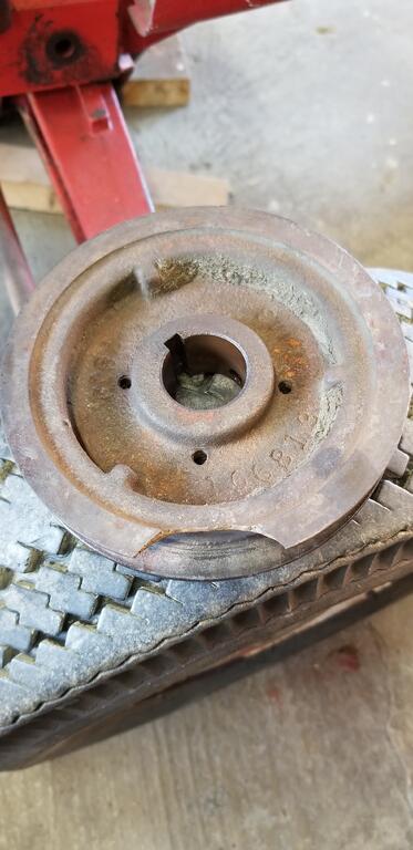

Mike'sHorseBarn 3,656 #1 Posted August 12, 2022 I'm switching my electro 12 back to an electric clutch. In the process I found that the drive pulley has a chunk missing out of it. My question is do I use this pulley and put the electric clutch on the outside of the drive pulley or do I need a pulley altogether? This is my first time messing with an electric clutch so I'm not sure. If I use that pulley I'll have to probably locate another one. Share this post Link to post Share on other sites
Ed Kennell 46,982 #2 Posted August 12, 2022 (edited) Since you have it off, I would replace it if you can find one. Having said that, I have used Vee pulleys with that type of chunk missing w/o any problems. Just round off and smooth the broken edge to prevent any belt wear. Just curious, why go back to an electric clutch? Edited August 12, 2022 by Ed Kennell 1 Share this post Link to post Share on other sites
Mike'sHorseBarn 3,656 #3 Posted August 12, 2022 34 minutes ago, Ed Kennell said: Just curious, why go back to an electric clutch? I'm not planning on using it to mow as the deck is shot and being that an electric clutch is why they called it an electro, I decided to switch it back. 2 Share this post Link to post Share on other sites
TractorEd 675 #4 Posted August 12, 2022 (edited) 1 hour ago, Mike'sHorseBarn said: I'm not planning on using it to mow as the deck is shot and being that an electric clutch is why they called it an electro, I decided to switch it back. I would replace it if possible. And I think keeping it as original as you can is a great idea. Edited August 12, 2022 by TractorEd 1 Share this post Link to post Share on other sites

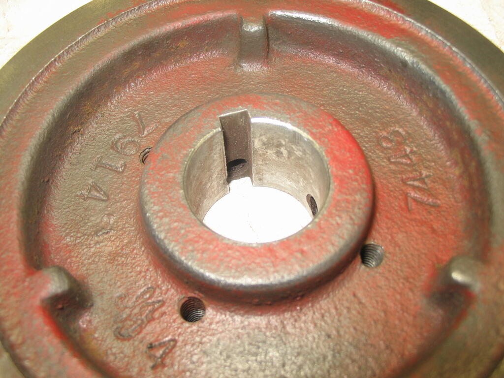

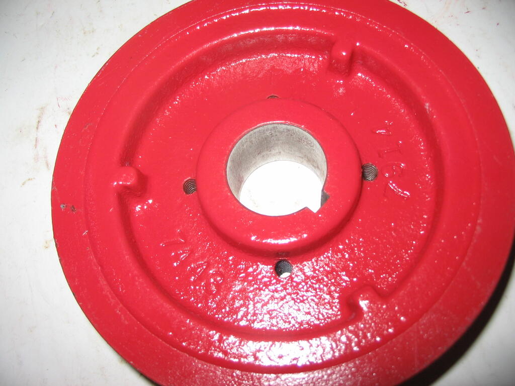

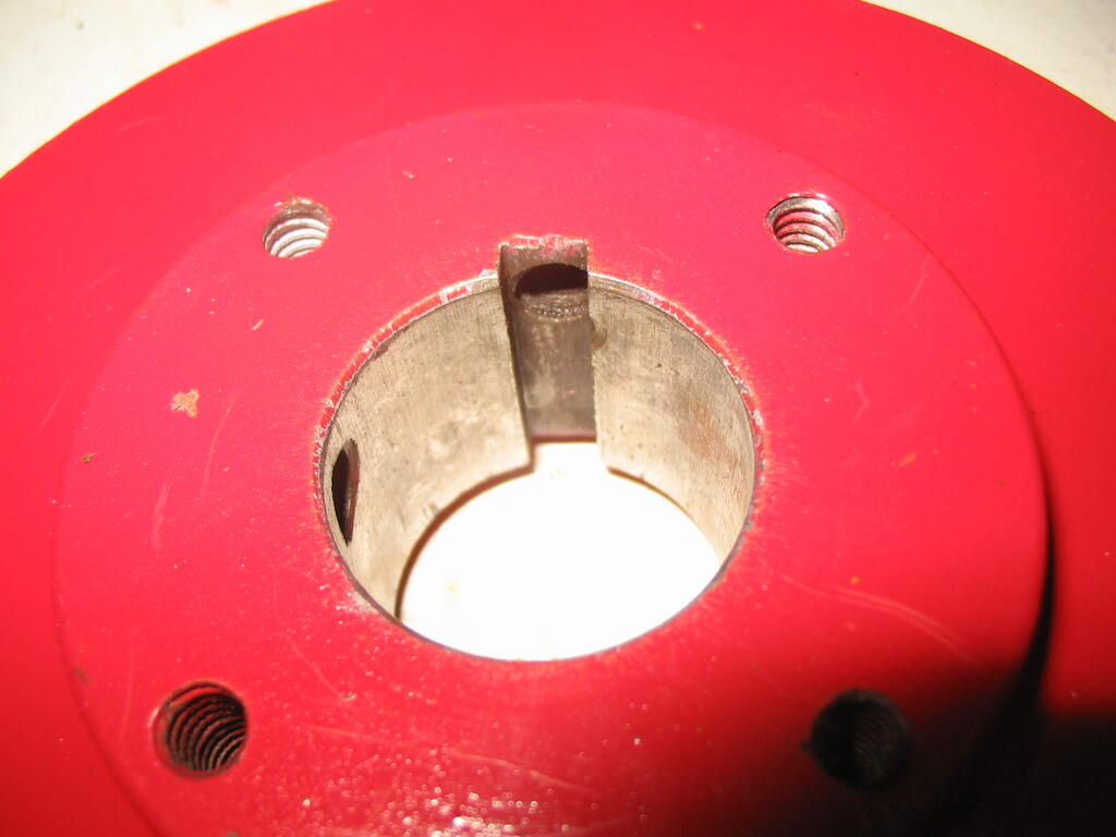

daveoman1966 3,884 #5 Posted August 12, 2022 (edited) The back of your engine pulley is # 106813 #7443 #7914 . A new one is is available for just over $240....(Yeah..that's $240) This is the exact same V-Pulley I have from a C-120 Auto (Kohler k301s)...yours for $75. No chips, no rust, for 1-1/8" crankshaft. Edited August 12, 2022 by daveoman1966 2 1 Share this post Link to post Share on other sites

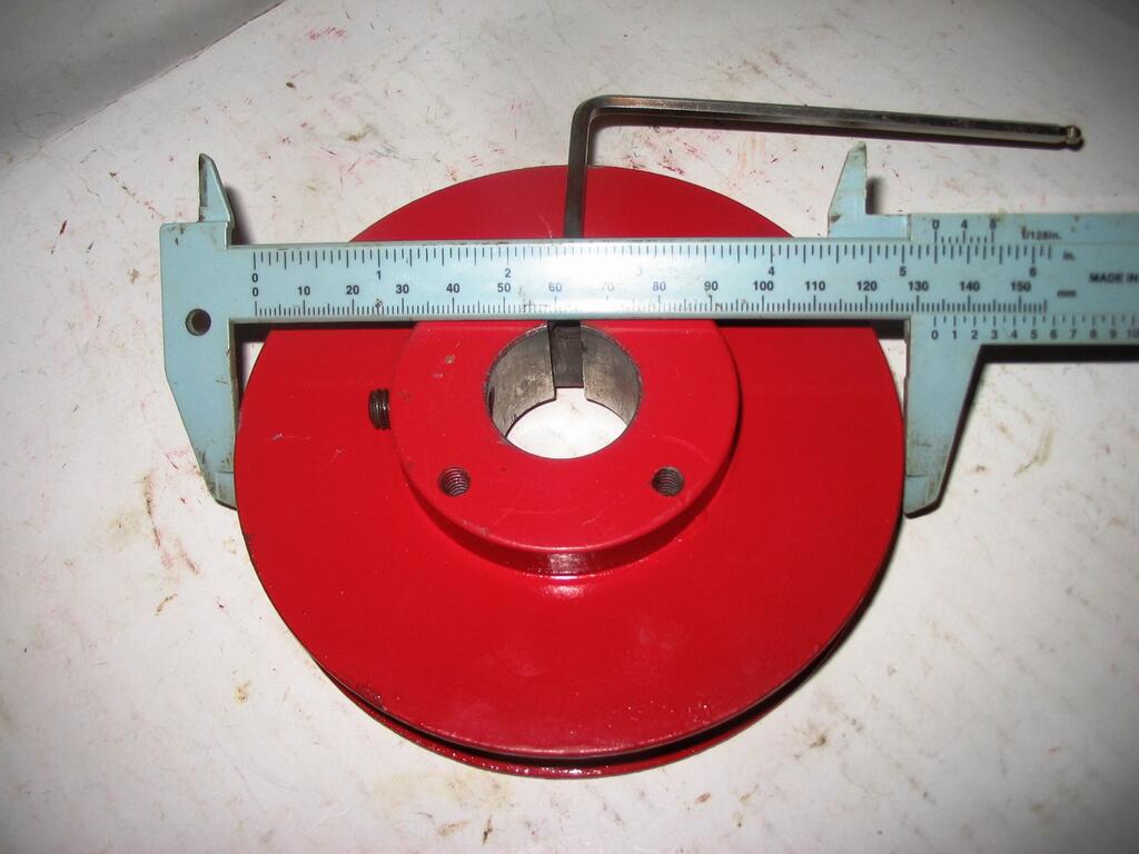

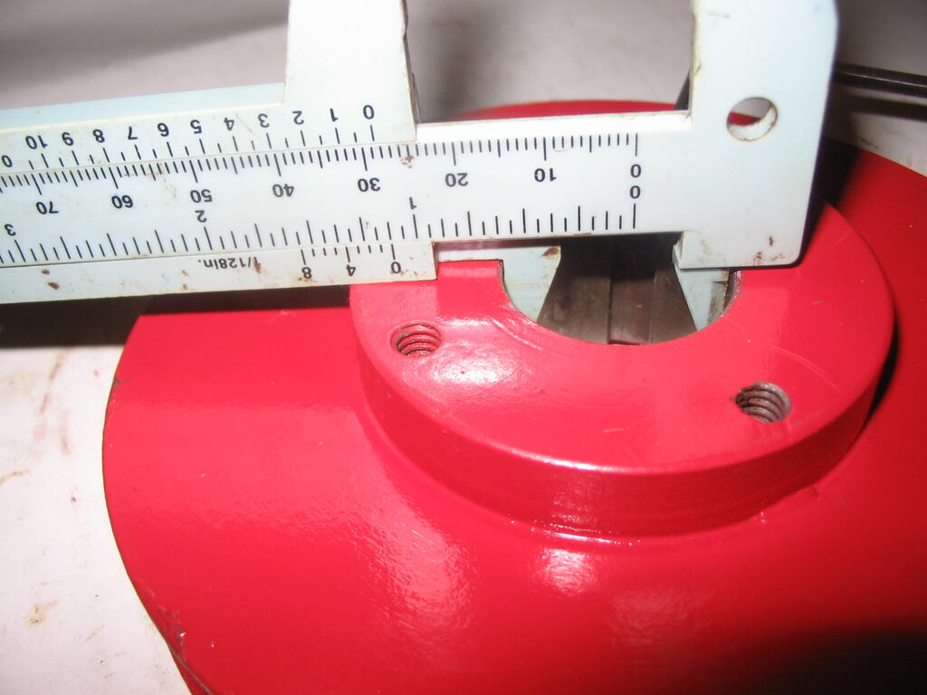

953 nut 68,500 #6 Posted August 12, 2022 With an electric clutch you do not need the four bolts that retained your clutch disk when using a manual clutch. Any five to five and a half by 5/8" pully with a 1 1/8" bore will be fine. 3 Share this post Link to post Share on other sites
