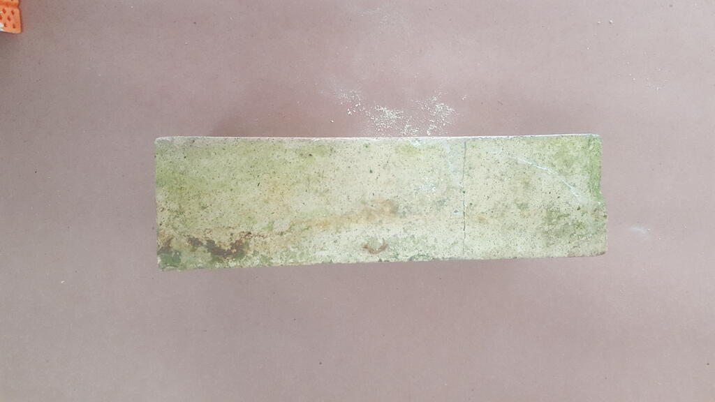

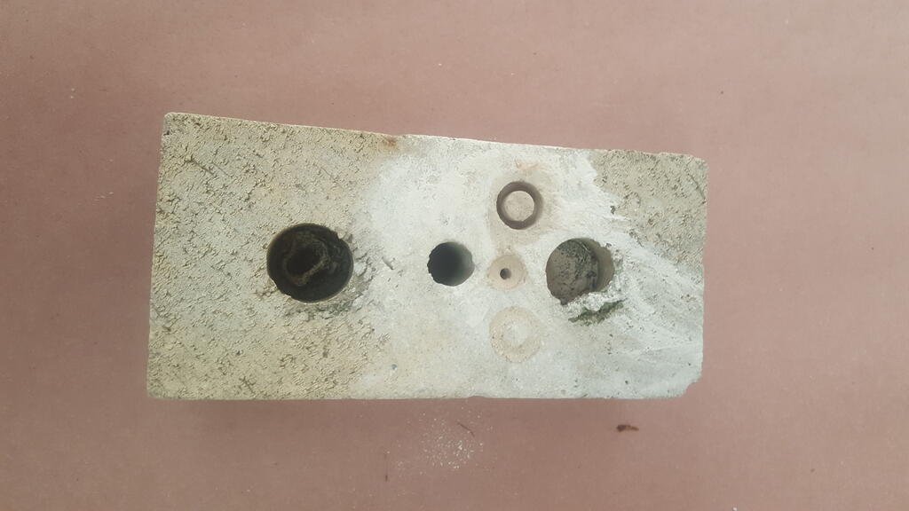

Gregor 4,848 #5 Posted August 9, 2022 (edited) This is one of the bricks. Some of them sat "RistokraT". The building is 2 bricks thick, so drilling the mortar lines is out of the question. I did manage to drill into this brick on my drill press, with carbide bits, and water, but it's slow going, and not practical for a building. I would just as soon use tapcons if possible Edited August 9, 2022 by Gregor 1 Share this post Link to post Share on other sites

sjoemie himself 3,228 #10 Posted August 9, 2022 1 hour ago, rjg854 said: SDS hammer drill Yeah that.. kinda got lost in translation. We have 'klop-boormachines' (knocking-drill) and 'hamer-boormachines' (hammer-drill). People like to mix those up unfortunately. @Gregor drilling bricks on a drillpress is no good. The machine lacks the hammer function you desperately need when drilling brick, or concrete for that matter. Also adding water does probably more harm than good. Only with diamond tipped coring-drills (for large holes 1" and up) as @wallfish mentioned water is your friend. 1 1 Share this post Link to post Share on other sites
