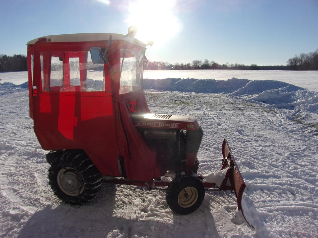

bds1984 1,519 #12 Posted August 8, 2022 The 520H is one tough horse. I've been using my 1988 520H for the last seven winters for plowing and pushing snow into piles over four feet high without skipping a beat; all four wheels are ag tires with wheel weights and the rears are loaded. The Achilles heal for these machines is the valve seat issue on the rear cylinder (which mine suffered from), but with proper cleaning of the cooling fins and adding ventilation holes on the belt guard, the life of the Onan can be extended greatly. Unfortunately, my first 520H came to me as a roller so I installed an M18 Kohler from a yellow machine and have never looked back or doubted the durability of the Eaton 1100 transmission in it. My second 520H (and first running Onan) just arrived last week and will be used for lawn duty as I much prefer the hydro transmission and gear reduction steering setup over any 8-speed for mowing. I can tell you the Onan is a much more thirsty beast of an engine compared to my 315-8 and C165, easily double the fuel consumption, but the exhaust note sure is sweet! 5 Share this post Link to post Share on other sites
