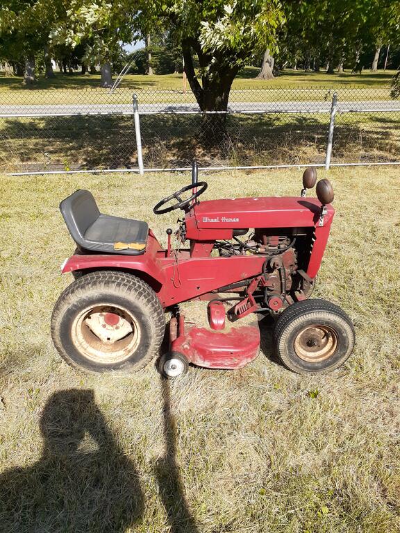

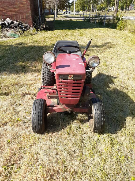

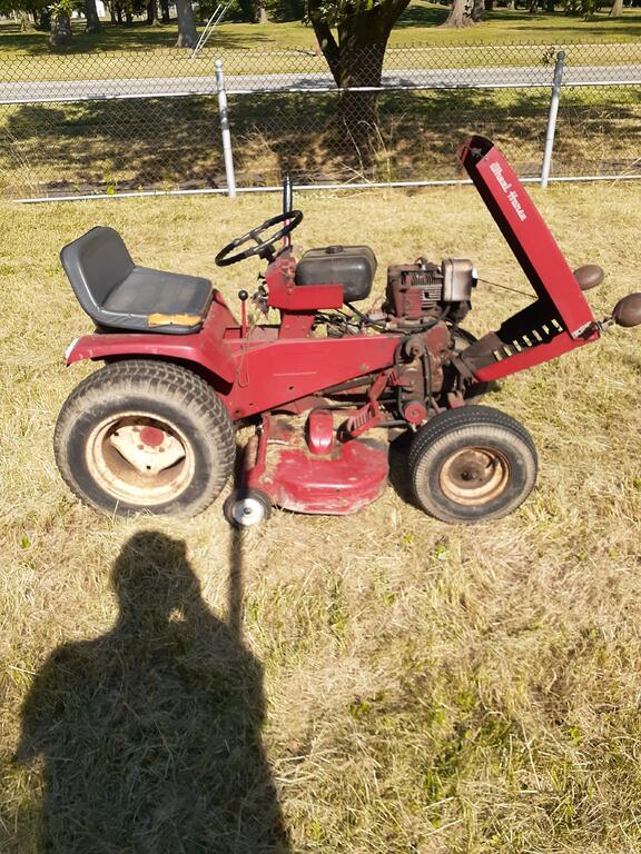

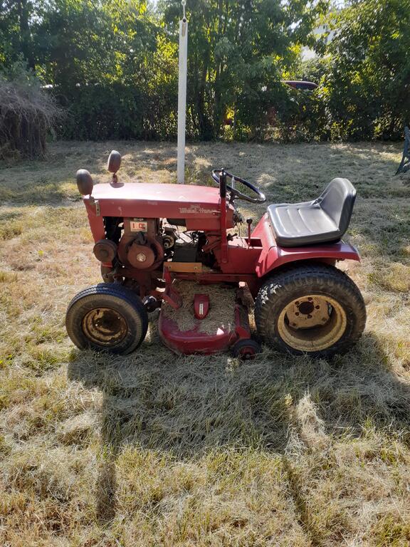

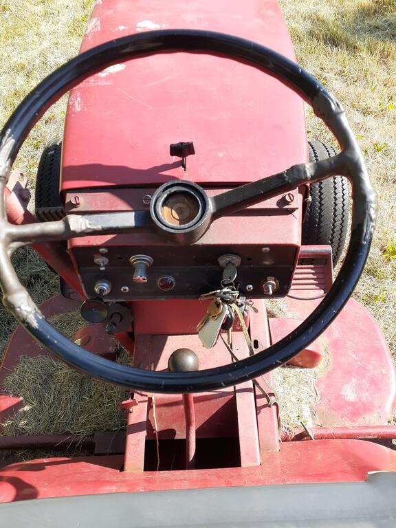

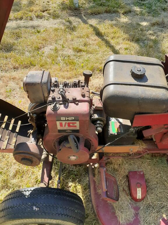

Dieseltu 26 #1 Posted August 4, 2022 Good day, I bought this wheel horse to mow grass. It was on CL. I had been mowing this grass pictures for about 30 years with a Honda push mower but I can,t do it all the time. I was looking for something narrow like a snapper but they're difficult to find also so I started looking for anything narrow. So I bought this wheel horse because the lady replied and its in nice shape. I was told it was a 1957. But I did a little looking and it looks more like a 60s Wheel horse. I drove it home and it cut the grass, after I figured out how to get the deck to run. I went backnm then went back next day, and it starts right up easy. It's my first rider and I flipped it over geting it in the truck. and bent the seat and broke the tail lights off. It came with a snow plow but I couldnt move it so I left it. It cuts about 3 times as fast as the honda so im real happy. Saying that I wish I knew what year it is to get some parts I guess. The tie rods loose. front tires, taillights, maybe fix the choke but it works . Its gonna need something eventually. So heres the pictures fire away. Thank you. 4 4 Share this post Link to post Share on other sites
Pullstart 69,548 #2 Posted August 4, 2022 Sorry to hear about it flipping over, they tend to be rear heavy when they are off camber! Most recommend if power loading, walk beside it You’re right at thinking it’s a 60’s model. In ‘65 they went to the square hood and seat pan vs. round hood and round fenders. In ‘64. The diamond imprint would be where the model decal is, but direct under the dash on the tower should be a model and serial ID plate. Either way, the engine should be a Tecumseh or most likely Kohler but if that Briggs runs well, leave it as is. You could easily reference any 60’s model, it much changed in the gear jammer world. We’ll reference, say an 857. That would be 8 hp, electric start gear drive, ‘67 build year. That will get you what bolt on items are needed for sure. Have fun on your “new” rider! They are better built than anything from a store these days! 2 1 Share this post Link to post Share on other sites
Pullstart 69,548 #3 Posted August 4, 2022 As for front tires, model isn’t really specific. Just getting something to fit the wheel like an 18x6.50-8 will be enough to get what you’re looking for. There are vendors like WheelHorsePartsAndMore, K&B Horse Parts, or A-Z Tractor in our vendor site that could hook you up with many of the items you need. https://www.wheelhorseforum.com/forum/92-vendors/ 3 Share this post Link to post Share on other sites

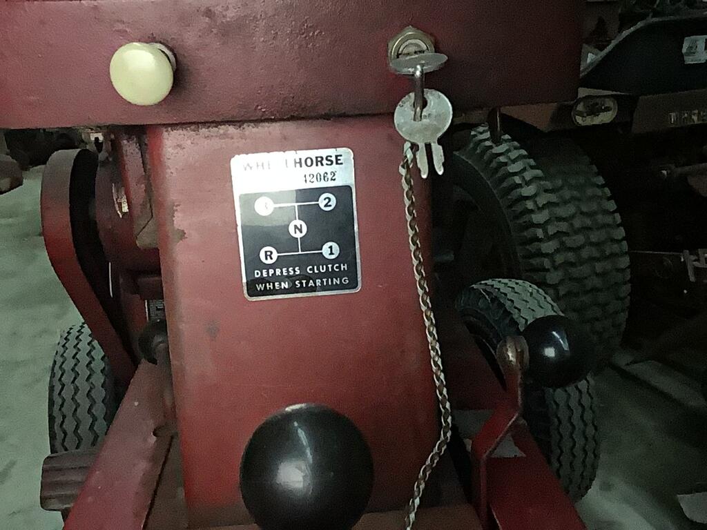

Pullstart 69,548 #8 Posted August 4, 2022 4 minutes ago, Dieseltu said: The transmission has a low high and reverse Are there two shift levers? It looks like a “3 speed” to me… so you should have 3 forward gears plus reverse. If you have a second lever that movers left to right, it would be a “6 speed” having high and low range… and it would have a limited slip differential too! Those were available in ‘67 model years I believe. Share this post Link to post Share on other sites

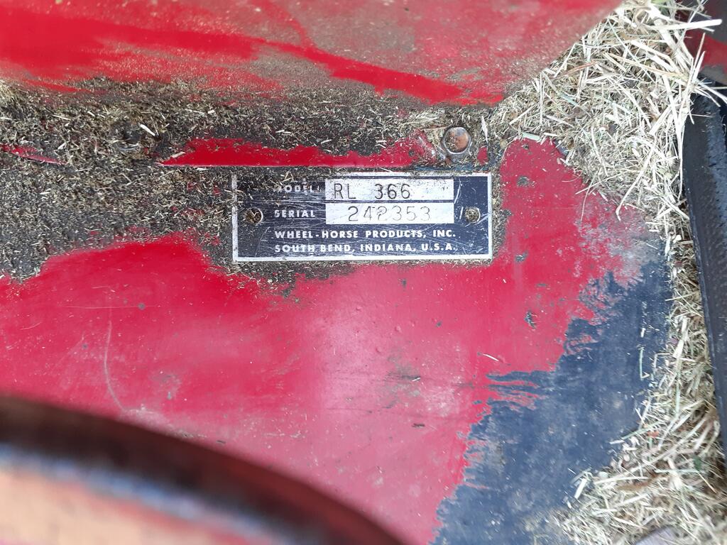

Pullstart 69,548 #9 Posted August 4, 2022 5 minutes ago, Dieseltu said: That tag is for your mower deck. There should be another direct under the dash. Here are some files on the deck: https://www.wheelhorseforum.com/search/?&q=RL-366&search_and_or=or&sortby=relevancy 1 Share this post Link to post Share on other sites
Dieseltu 26 #11 Posted August 4, 2022 The transmission has a low which is right and a high which is left. And reverse is in the middle you pull it back and left. if its got 3 forward i didnt find it yet. Right there where the shifter is sitting is neutral 2 Share this post Link to post Share on other sites
Horseoholic 258 #12 Posted August 4, 2022 Could it be a model 856 (1966) ? if the mower deck is original , doesn't the serial tag on the deck saying RL366 specify it being a 36'' deck 1966 model ? 1 Share this post Link to post Share on other sites
Retired Wrencher 6,554 #13 Posted August 4, 2022 Like Pullstart said just look under the steering wheel dash. small plate like on your deck. Not sure if that is the original engine, but if it runs good that is ok. Keep it clean blow it off after use. Grese and oil two main things for maintenance. Once you find the plate everything will fall into place. Enjoy it take care of it. 2 1 Share this post Link to post Share on other sites
Pullstart 69,548 #14 Posted August 4, 2022 1 hour ago, Dieseltu said: The transmission has a low which is right and a high which is left. And reverse is in the middle you pull it back and left. if its got 3 forward i didnt find it yet. Right there where the shifter is sitting is neutral different tractor, but same shift pattern as shown. 4 Share this post Link to post Share on other sites
Retired Wrencher 6,554 #15 Posted August 4, 2022 (edited) I just looked in model list first year the installed Brigs was 1971. Edited August 4, 2022 by Retierd Wrencher 1 Share this post Link to post Share on other sites
squonk 45,999 #16 Posted August 4, 2022 (edited) Not the original engine. . Best guess it was a 65 605 or 655 which would have had a Tecky on it that probably blew up and someone slapped on the Briggs Edited August 4, 2022 by squonk 2 Share this post Link to post Share on other sites
953 nut 65,012 #17 Posted August 4, 2022 The "Short Frame" square hood models were introduced in 1965 (model 855 and 1055) and the same tractor continued the following year as the 856 and 1056 with no changes. The 1967 857 was a continuation of the 855 and the only change was the seat. Since your has seen some changes done by previous owners the ID tag below the dash would be the only way to know for sure but parts from any of the above mentioned models are interchangeable. Lowell @wheelhorseman at https://wheelhorsepartsandmore.com/ can fix you up with the tie rods and most other mechanical parts you need. This manual should be helpful. 2 Share this post Link to post Share on other sites
squonk 45,999 #18 Posted August 4, 2022 Also not original gas tank & Throttle cable is missing 1 Share this post Link to post Share on other sites
kpinnc 17,686 #19 Posted August 4, 2022 Nice tractor. I'd just service it and keep running as-is. 3 Share this post Link to post Share on other sites
D_Mac 9,334 #20 Posted August 4, 2022 (edited) i like it. Short frame square hoods are my favorites. With all the work that has been done to it knowing the exact model really isnt going to mater much. You have the ID tag for the deck if ever you need a part for that. The engine is not original, the lights are not original so any information on wiring or engine parts you are not going to find with a model number. As far as the rest of it those 60s models are all pretty much the same. The good news is the cigarette lighter is original ! Please tell me it works ! Look under the dash panel for the ID tag. Might be painted over, may have to clean it. I would blow all that grass off it, clean it up, lubricate and grease all fittings. Cool looking tractor. My guess would be it is an 856. Welcome Edited August 4, 2022 by D_Mac 5 Share this post Link to post Share on other sites
ACman 7,715 #21 Posted August 4, 2022 Like the others have said the Model and serial # tag is a brass tag underneath the dash right in front of shifter knob. It’s tucked up in there so it’s easily missed.and might be painted over so you may need to scrape it off . This tag reads T 1055 so 10=10hp 5=electric start and the last 5= year. In this case 1965 . Good luck with your purchase 3 Share this post Link to post Share on other sites
