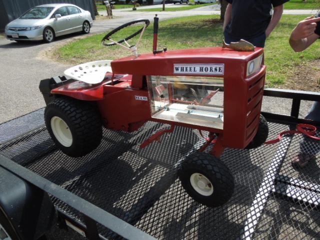

wallfish 20,699 #11 Posted August 2, 2022 I did an electric Lawn Ranger a while ago and used a starter generator from a cub cadet or simplicity as the motor since they spin the correct direction with a belt to the trans. 1 deep cycle marine battery ran it. It had an onboard charger/ maintainer so just plug an extension cord to it and it was ready to go. Not good for long rides but it went well around at one of the shows. It had a full blown fish aquarium under the hood, lights, bubbles etc etc. Built for a friends young daughter that liked that show Tanked so it wasn't here for very long. I don't know how long one of those S/Gs will last doing that. 3 Share this post Link to post Share on other sites
SylvanLakeWH 32,722 #12 Posted August 2, 2022 Very cool! Any pics? I was wondering if a single 12v motor and battery would do the trick… simpler and cheaper… never thought of a starter generator… would have a strong enough shaft I guess hey? 1 Share this post Link to post Share on other sites
wallfish 20,699 #13 Posted August 2, 2022 12 minutes ago, SylvanLakeWH said: Any pics? S/G is mounted below the frame. You can see it right below the belt guard. You can also see the black plastic battery box behind the rear fender mounted to the rear of the trans. Not filled and not set up with fish here as they were picking it up. I left that up to her to decorate it however she liked. Acrylic tank. Had to seal the top and get creative to vent it so it wouldn't splash water out. 1 2 3 Share this post Link to post Share on other sites

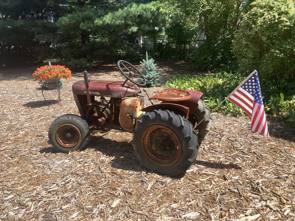

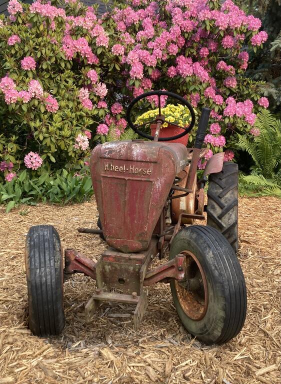

SylvanLakeWH 32,722 #20 Posted March 17, 2025 (edited) @oliver2-44 nudged me to resurrect / reconsider this thread / concept... thx! May consider a 3 hp Predator or a battery powered unit as shown in post 1. Pros I have it in my yard It's a It looks cool Cons Transmission is locked up... Front wheels pretty bad Back wheels pretty bad Engine locked up it is sun-kissed...to say the least... I love it where it is... yard art. If i don't get any roller offers at @Pullstart's plow day next week, me thinks I will go this route... Thoughts / advice / ideas welcome... Edited March 17, 2025 by SylvanLakeWH 2 1 Share this post Link to post Share on other sites
