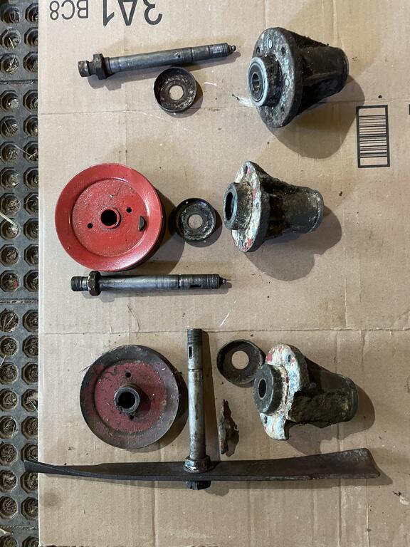

Snoopy11 5,731 #2 Posted August 1, 2022 Dave... shoot me over a picture of your spindles... let the anthropomorphic beagle do some digging... I might have an idea... Don 2 Share this post Link to post Share on other sites
davem1111 2,373 #3 Posted August 1, 2022 15 minutes ago, Snoopy11 said: Dave... shoot me over a picture of your spindles... let the anthropomorphic beagle do some digging... I might have an idea... Don The spindle and shaft at the top of the picture are the 5/8" one. Spindle shaft is worn badly where the blade sits, and needs to be replaced. I would need to get a 5/8" side pulley to use with that one also. The other 2 are the 3/4" ones. As mentioned, the "good" housing is missing its grease seal. I don't know yet how hard those are to replace but what's left of it doesn't want to come out easily. The shaft with that one has a little wear on it but should be usable. The other housing is cracked, and I also cannot get the darn blade off. I've tried heating the bolt red hot, lots of PB Blaster, even cutting into the nut... afraid if I do much more it will damage the shaft beyond use anyway. Both 3/4" pulleys are in good shape. Missing one Woodruff key but it's around somewhere. 1 Share this post Link to post Share on other sites

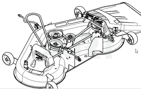

davem1111 2,373 #16 Posted August 2, 2022 (edited) To get slightly back on topic here .... @Snoopy11 had suggested earlier that I look at some JD deck spindles as a possible replacement. It would seem to me at the prices for the OEM WH spindles & shafts, that someone would have evaluated some others, but maybe not. Anyway, I see several things here that might not work, but might... on the WH spindles, the distance from the deck to where the blade rides is about 3-3/4" to 3-7/8". It's hard to tell on the JD ones but they may be pretty close. More of a concern are these things. First, these spindle housings have a tapered top then a raised ring, while the WH ones just have a flat top with a raised ring that goes through the hole in the deck. This might require some shimming, grinding or a combination of both. The bolt hole spacing does not appear to be the same. I'm not opposed to drilling new holes in a deck to mount a spindle that otherwise is workable, but that leads to the next problem. The blades and pulleys would <obviously> need to be replaced also. Blades, not really a problem as long as the length is the same or are a little longer and can be ground down to proper length. Pulleys are another matter. These decks seem to have more idlers and don't appear to use a stacked double pulley for the drive. I suppose buying some properly sized "extra" pulleys and welding them together may be an option. This kit for example, comes with 3 spindles, 3 blades, a belt, and 4 pulleys, which all appear to be flat idlers, which makes no sense. Most of these seem to have a star pattern on the blade center hole, which I think is a good idea. Some of them have a star pattern for the pulley center hole, which is fine if I can get the right diameter V pulleys to go on them, plus a 5/8" V drive pulley to weld on top of the center one. I have concerns about the height of the pulleys, which might make the original guards too low, but new ones could be made. Clearance from the deck attachment mechanisms might be an issue though. From this diagram, at least on this deck, all the spindles are driven by V pulleys, which makes a lot more sense than flat. Maybe those are sold separately. This one has 2 flat idlers that I can see. The bottom line is, if I can adapt some other Mfg. stuff to the WH deck, I can probably have all new except the shell, wheels and rollers for maybe $300-400 less than going with WH parts. Maybe this is a pipe dream? Maybe it would be easier to just get a JD deck and adapt it to mount on a WH? (that idea ought to rile a few people up... ) Come on, gang! You only use 10% of your brain! Try applying at least another 10% to this and we'll have answers! Maybe we can develop a modified refresh package for WH decks that we can sell! Edited August 2, 2022 by davem1111 Share this post Link to post Share on other sites
Snoopy11 5,731 #17 Posted August 2, 2022 24 minutes ago, davem1111 said: don't appear to use a stacked double pulley for the drive N0... the newer JD units don't use a double stacked pulley... 1 big 0zz belt runs from the PT0 to the deck pulleys... However, if you stay looking at older models, such as the LX176... you'd be closer to the WH design. The LX176 uses a double stacked pulley design. I think it only uses 2 blades though... Don 1 Share this post Link to post Share on other sites
