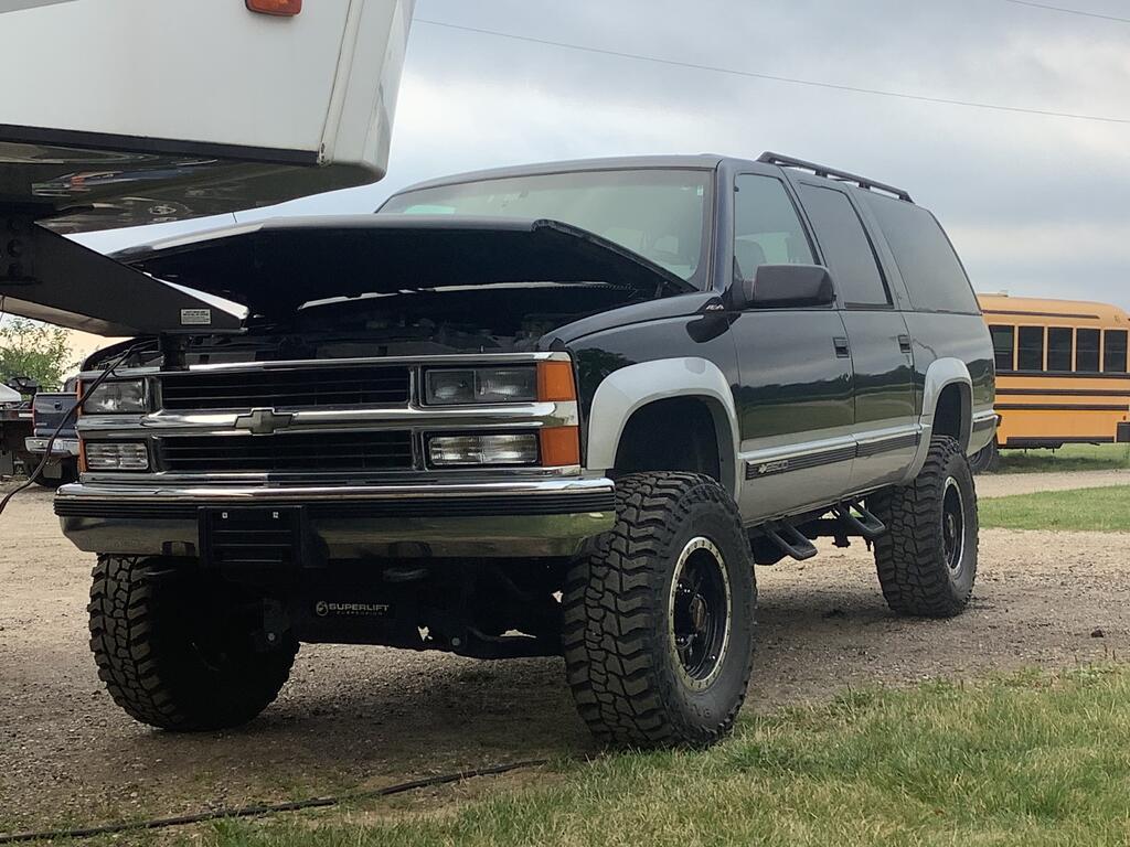

Pullstart 69,806 #1 Posted August 1, 2022 Any experts in this stuff? I can install it, but haven’t ever gotten into the nitty gritty about it. I installed a Kenwood eXceleron powered head unit, 4 Rockford Fosgate door speakers and a 10” powered Fosgate sub in my wife’s daily driver. The deck is supposed to be able to push the speakers without an amp and the sub has it’s own. Today, I ordered a 120 amp relay and assorted wiring to install for the sub power feed because if it sits for more than 2 days, it kills the battery. Seems the communication between the head and the sub never tells it to shut off? Basically, her ‘15 LTZ suburban had a Bose sound system and it had nice crisp, clean sounds whether high, mid or low, and we are trying to duplicate that. Without this… Another dead battery. Share this post Link to post Share on other sites

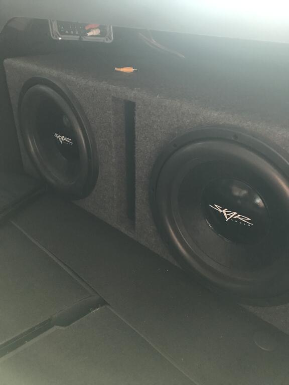

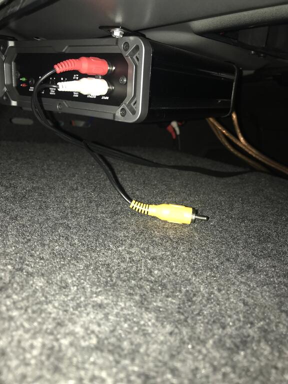

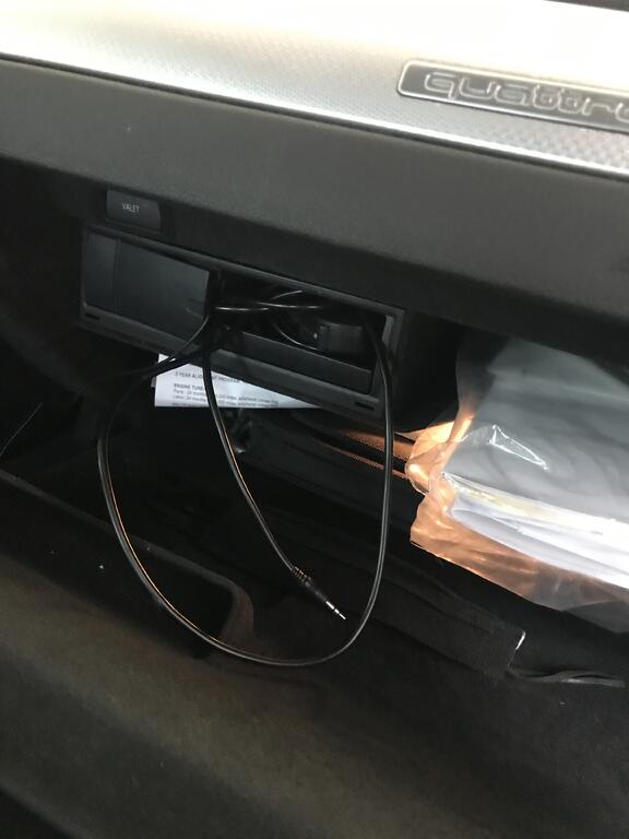

The Freightliner Guy 1,363 #14 Posted August 1, 2022 My brother also has a led strip and a sub woofer and it doesn’t seem to die his car is a 2009 Audi A4 Quattro 1 Share this post Link to post Share on other sites
