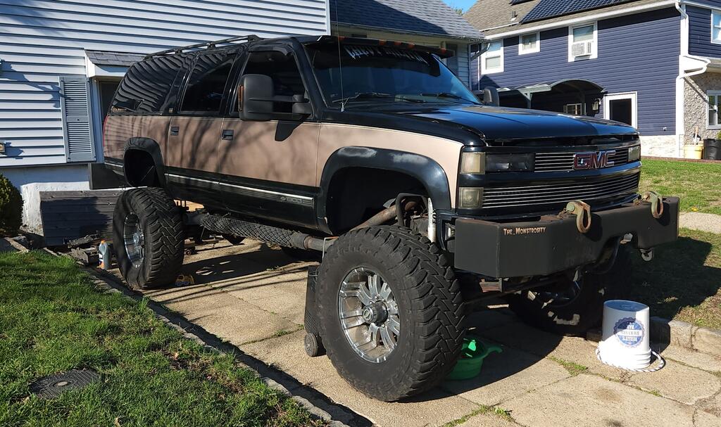

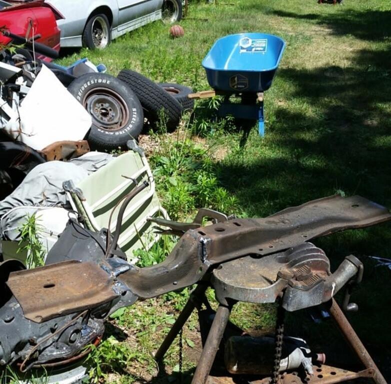

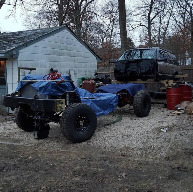

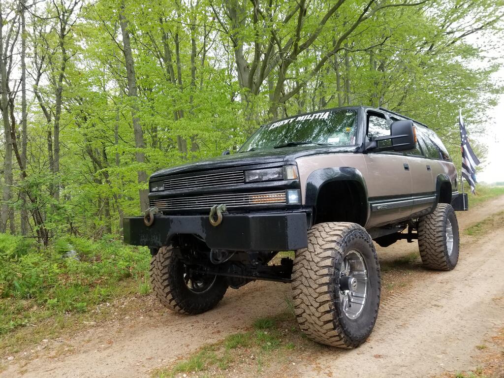

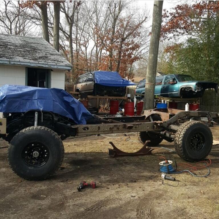

Monstrosity 1,153 #6 Posted July 28, 2022 (edited) 9 hours ago, SylvanLakeWH said: I am fearful that one of your precious children may strain themselves getting into or out of that lifted device that creates global warming… She’s watching you… Then you'd really won't like this one she's diesel too NICE SUBURBAN!! @Pullstart Edited July 28, 2022 by Monstrosity 3 1 Share this post Link to post Share on other sites
Pullstart 71,016 #7 Posted July 28, 2022 1 hour ago, Monstrosity said: NICE SUBURBAN!! @Pullstart Wow, that’s a beast! More info please! What diesel, what front axle, did you build it? I should’a just gone with a solid axle swap, the front alignment is still off enough to chew on the tires more than I’d like. Lots of tire rotations planned… but my wife on average drives it 6 miles a day so the 454 setup isn’t too costly to operate. Share this post Link to post Share on other sites

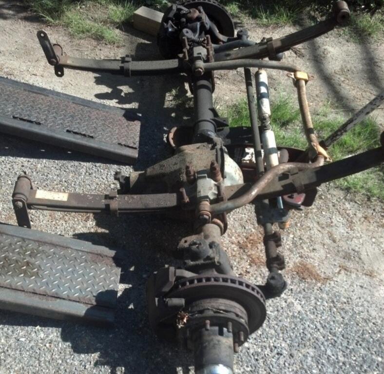

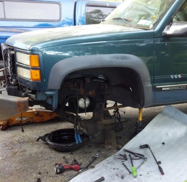

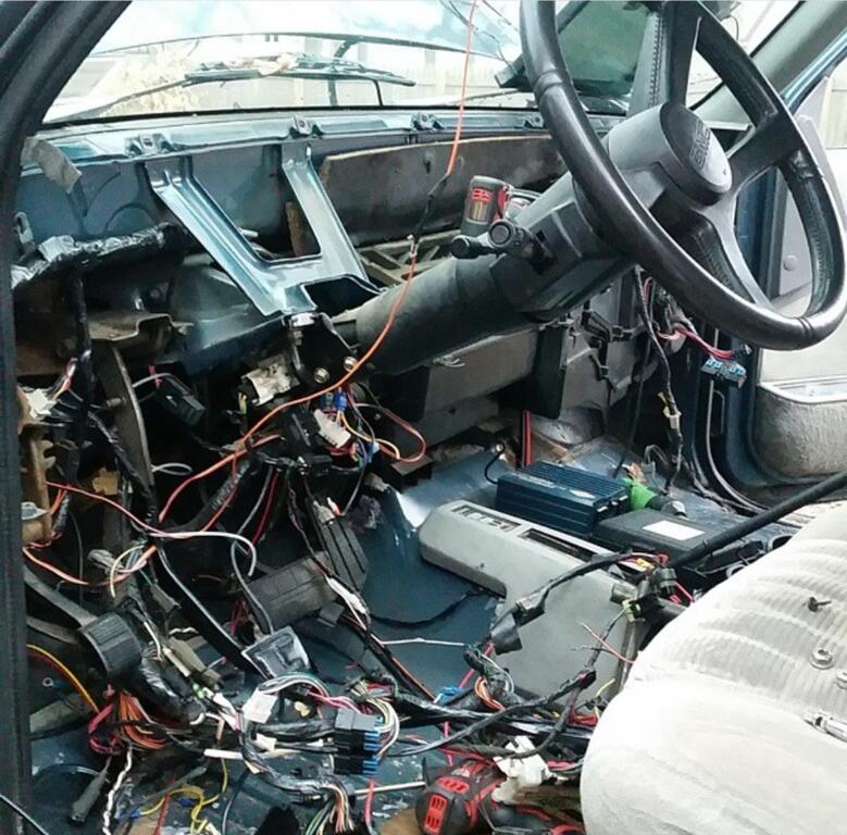

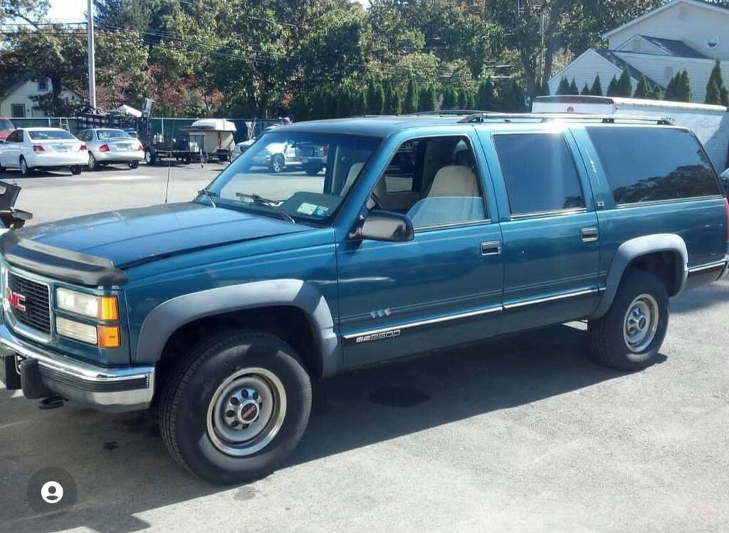

Monstrosity 1,153 #9 Posted July 29, 2022 15 hours ago, Pullstart said: Wow, that’s a beast! More info please! It's a 6.5 TD, manual conversion nv4500, np205 cast iron transfer case, Dana 60 King pin front axle, corp14 3.5inch tube big brake rear axle, body swapped with 1500 floor was starting to rot in the blue body. 2 1 1 Share this post Link to post Share on other sites
