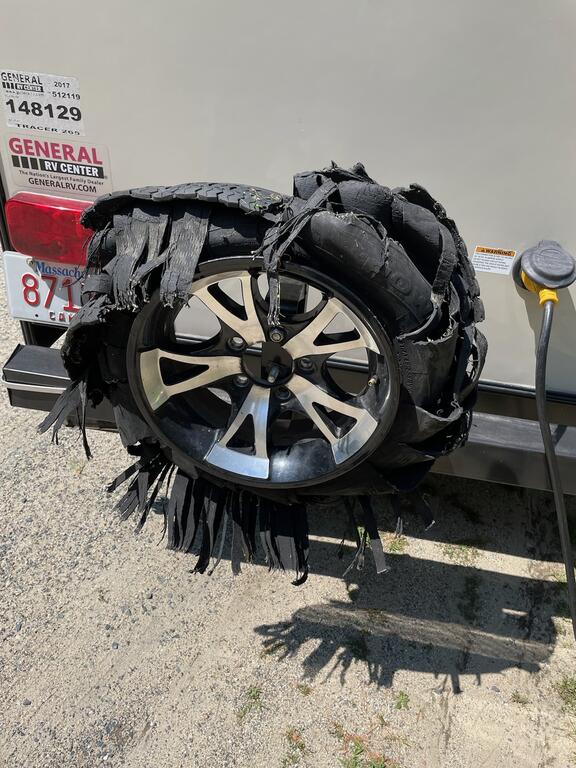

ebinmaine 78,384 #1 Posted July 22, 2022 Take a couple minutes to closely inspect the load range and air pressure requirements on your trailer tires. Do this right and save the hassle of what happens in the picture below... This is a C Load Rated tire that was on a trailer with 3 D Load Rated tires. This is in no way shape or form a good idea and in some states is illegal. Whether it is the towed vehicle or towing vehicle the Load Ranges MUST MATCH. Yes. I know it's hot. 🔥 That's all the more reason why you should do this RIGHT NOW. ... Before you use the trailer. Be safe out there people. 9 Share this post Link to post Share on other sites

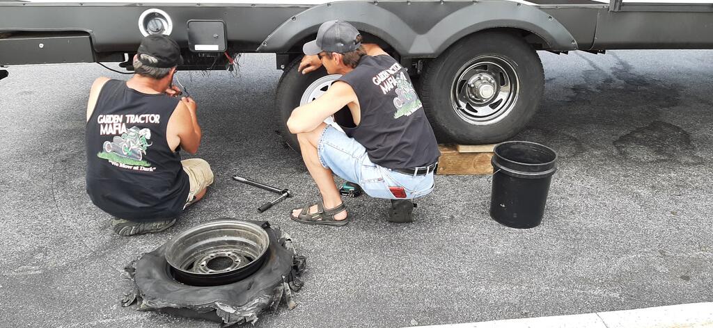

WHX?? 56,180 #3 Posted July 22, 2022 $hit happens.....tires & pressures correct. Dan was pulling his bros camper with all mismatched tires, standard procedure for his bro go figure. and had an incident. Guy should just figure on replacing them every 2-3 years. 5 Share this post Link to post Share on other sites
lynnmor 8,755 #4 Posted July 22, 2022 Since a D rated tire was replaced it too was likely a China Bomb. Six year old Chinese tires is something that I don't want. 2 Share this post Link to post Share on other sites

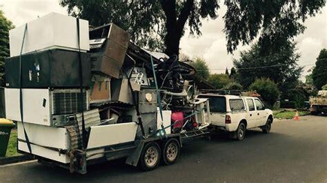

SylvanLakeWH 31,129 #12 Posted July 25, 2022 What can possibly go wrong… 1 1 Share this post Link to post Share on other sites
sjoemie himself 3,106 #13 Posted July 25, 2022 @76c12091520h that is very sad to hear. @lynnmor agreed. It sometimes amazes me what and HOW some people load (onto) their trailers. They seem to have no clue about securing a load and/or weight distribution. We have a law that stated that your load was secure as long as you used a cargo net, yes even with for example sand or a big heavy piece of machinery. Now luckily the policy makers have changed that law to state that 'every load should be secured properly in such a way that it can not fall off the trailer' or that 'if it does fall off it does not cause harm or damage'. Unfortunately most (private) persons did'nt get that last message and still use only the stupid friggin' net Share this post Link to post Share on other sites
