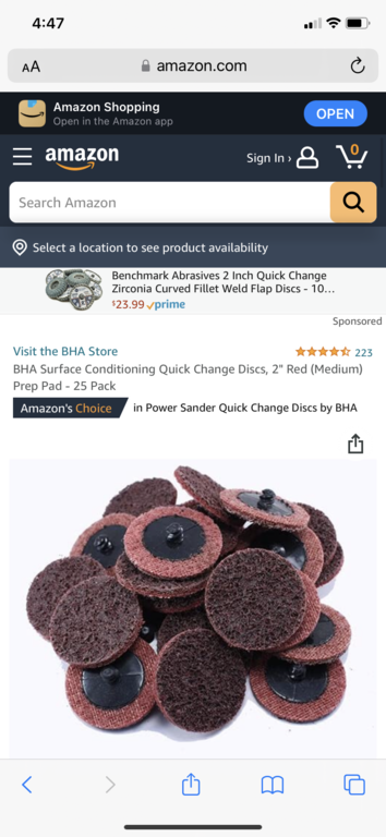

Jeff-C175 7,211 #8 Posted July 7, 2022 aka "Metal Prep" A 'needle scaler' comes in handy sometimes for rust removal in areas that you can't get to with sandpaper, wire wheel, etc... In the future, forget about a wire wheel for paint and rust removal. These things are the bee's knee's. MUCH MUCH faster than a wire wheel and does a much better job of it. 4 Share this post Link to post Share on other sites
Heatingman 977 #9 Posted July 7, 2022 1 hour ago, Jeff-C175 said: aka "Metal Prep" A 'needle scaler' comes in handy sometimes for rust removal in areas that you can't get to with sandpaper, wire wheel, etc... In the future, forget about a wire wheel for paint and rust removal. These things are the bee's knee's. MUCH MUCH faster than a wire wheel and does a much better job of it. I use something like that on the angle grinder. They are smaller though. Made by 3M, and HF has some knockoff version for much less then the 3M ones and seem to work just as well. Id really like to sand blast the entire thing, but Id need to set up a temporary containment structure to do it. The blasting cabinet only works for small parts. 1 Share this post Link to post Share on other sites
Heatingman 977 #10 Posted July 7, 2022 This is the style Im talking about. 1 1 Share this post Link to post Share on other sites
