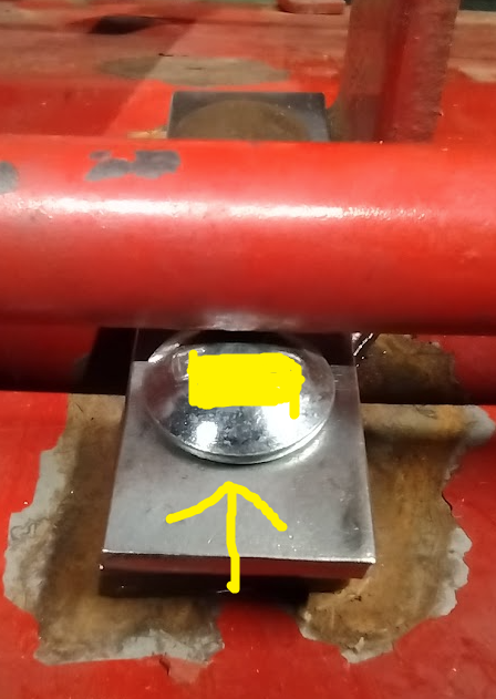

Jeff-C175 7,211 #5 Posted June 18, 2022 @Goldnboy @daveoman1966 Thanks guys! I've already repaired the ones I have, they'll probably hold up if I reinforce them... but that's the trouble actually! I can't put anything on TOP of the bracket because there is already barely room for the nut and bolt already with the rod for the gauge wheels installed. I'm glad I thought to check before I welded a piece on! But, I'll figure something out... It appears that there is 'forward pull' on these brackets when the deck is lifted, or even when mowing, as this is where the deck is 'pulled' forward from, same as on the 48" deck that I reinforced over the winter. That's what caused these to crack I believe. 2 Share this post Link to post Share on other sites
Jeff-C175 7,211 #6 Posted June 18, 2022 16 minutes ago, JoeM said: does the gauge wheel shaft run over the top of the bent area? It does... and that's why there's no room to strengthen the bracket by scabbing a coupon on top of it! 1 1 Share this post Link to post Share on other sites
JoeM 10,317 #7 Posted June 18, 2022 7 minutes ago, Jeff-C175 said: That's what caused these to crack I believe. for sure and one good hit in the front of the deck or in some cases several 1 Share this post Link to post Share on other sites
Jeff-C175 7,211 #8 Posted June 19, 2022 1 hour ago, JoeM said: for sure and one good hit in the front of the deck or in some cases several Funny thing is that the shell doesn't seem to have any evidence of that being the case! It's straight as can be. A hit or hits hard enough to bend those thickazz brackets would surely show something on the front. 2 1 Share this post Link to post Share on other sites
cod 136 #9 Posted June 19, 2022 8 hours ago, Jeff-C175 said: @Goldnboy @daveoman1966 Thanks guys! I've already repaired the ones I have, they'll probably hold up if I reinforce them... but that's the trouble actually! I can't put anything on TOP of the bracket because there is already barely room for the nut and bolt already with the rod for the gauge wheels installed. I'm glad I thought to check before I welded a piece on! But, I'll figure something out... It appears that there is 'forward pull' on these brackets when the deck is lifted, or even when mowing, as this is where the deck is 'pulled' forward from, same as on the 48" deck that I reinforced over the winter. That's what caused these to crack I believe. A random thought. Any chance that instead of using the carriage bolt and nut, you could thicken the tab that mounts on the deck and thread it? You'd still have to run the bolt up from the bottom side of the deck but it looks like you've got a 3/8 to 1/2 gap over the bracket now. Perhaps a thicker and wider tab would reinforce that whole area. Good luck! 1 Share this post Link to post Share on other sites
Jeff-C175 7,211 #10 Posted June 19, 2022 (edited) 6 hours ago, cod said: could thicken the tab that mounts on the deck and thread it? Good thought! Gonna think about it some. Downside to that would mean that a hex head bolt would be sticking out into the discharge path rather than a smooth carriage bolt. I'm probably just going to cut a rectangular coupon to sit on top of the bracket so both bolts pass through it, no welding for now, and hopefully I'll still be able to get the lower nut on. There should be enough clearance for that to fit under the gauge wheel rod. Since nobody has replied that they've also seen the same issue, I'm going to assume that it is not a rampant issue and was caused by some sort of abuse that a P.O. inflicted and hope it doesn't happen again. If it does, then I'll look for a more extreme solution. Edited June 19, 2022 by Jeff-C175 2 Share this post Link to post Share on other sites
Jeff-C175 7,211 #11 Posted June 19, 2022 1 hour ago, Jeff-C175 said: Downside to that would mean that a hex head bolt would be sticking out into the discharge path rather than a smooth carriage bolt. Actually... I must not have noticed when I disassembled the deck, but the two bolts under the gauge rod HAD to be facing down with the nut on the underside, because the nut and bolt already do not fit facing UP ! Soooo... Since those two have to face down anyway, I will have room to scab a piece of steel on top of the bracket for some extra strength. 3 Share this post Link to post Share on other sites
Jeff-C175 7,211 #12 Posted June 22, 2022 (edited) Today I made up a pair of 'sandwich' plates that fit on top of the brackets from some fairly thick steel. Installing the carriage bolt with the head on top it just clears the gauge wheel rod. I'm going to try this idea first and see how it holds up. It occurs to me that the bolt head being against the gauge wheel rod will actually help the situation by spreading some amount of the 'pull' to the gauge rod brackets. Tomorrow should be good weather so I'm going to start cleaning up the shell getting ready for paint... Edited June 23, 2022 by Jeff-C175 1 3 Share this post Link to post Share on other sites

Snoopy11 5,731 #18 Posted June 24, 2022 On 6/22/2022 at 7:20 PM, Jeff-C175 said: Installing the carriage bolt with the head on top it just clears the gauge wheel rod. If it hits or is a little too close for your liking... you could always grind the top off a tiny bit... Don 1 Share this post Link to post Share on other sites
