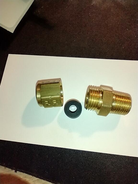

rmaynard
The original steel tubes from the fuel pump to the carburetor were installed using Parker-Hannifin anti-vibration fittings. They were like compression but used a rubber compression ring to hold the tube and absorb vibrations from the engine which were causing leaks.
The steel tube connections were superceded by flexible fuel lines.
