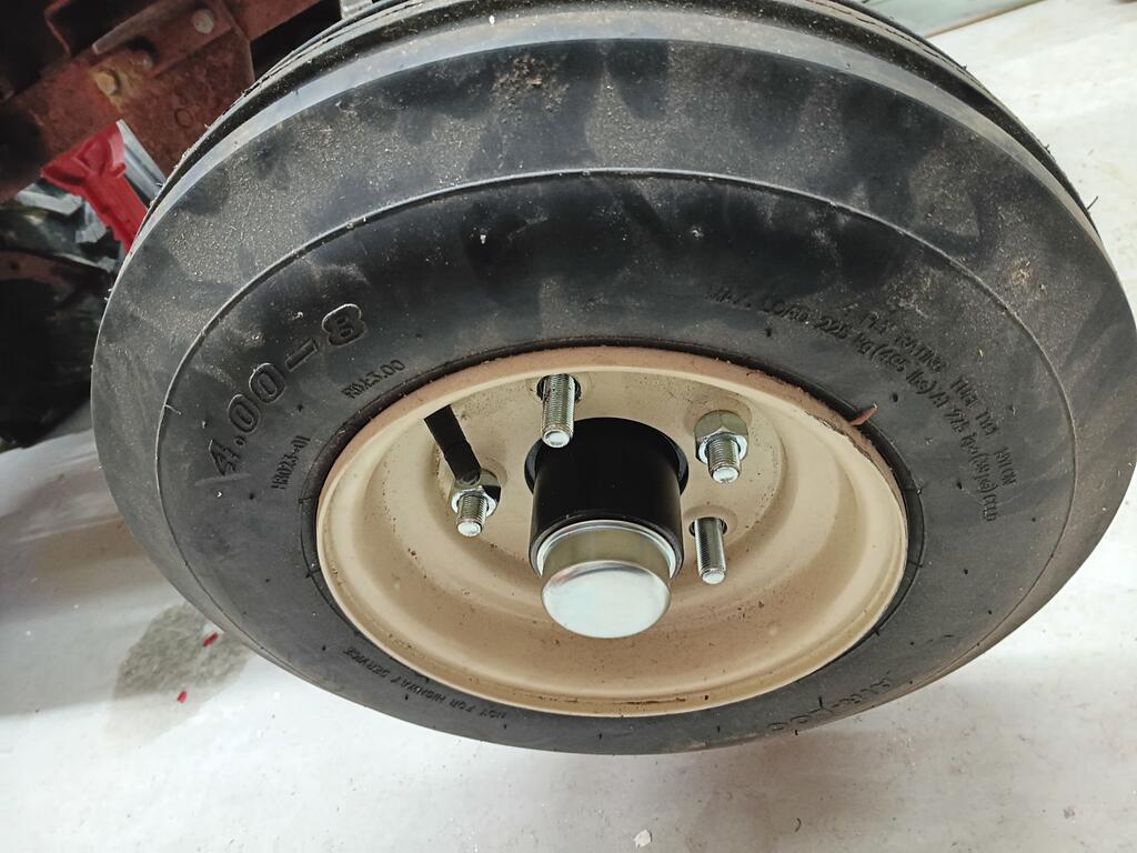

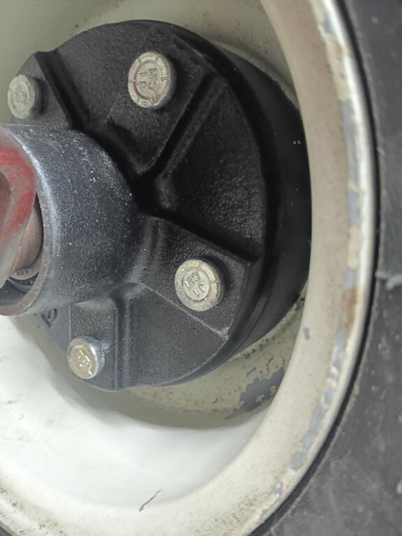

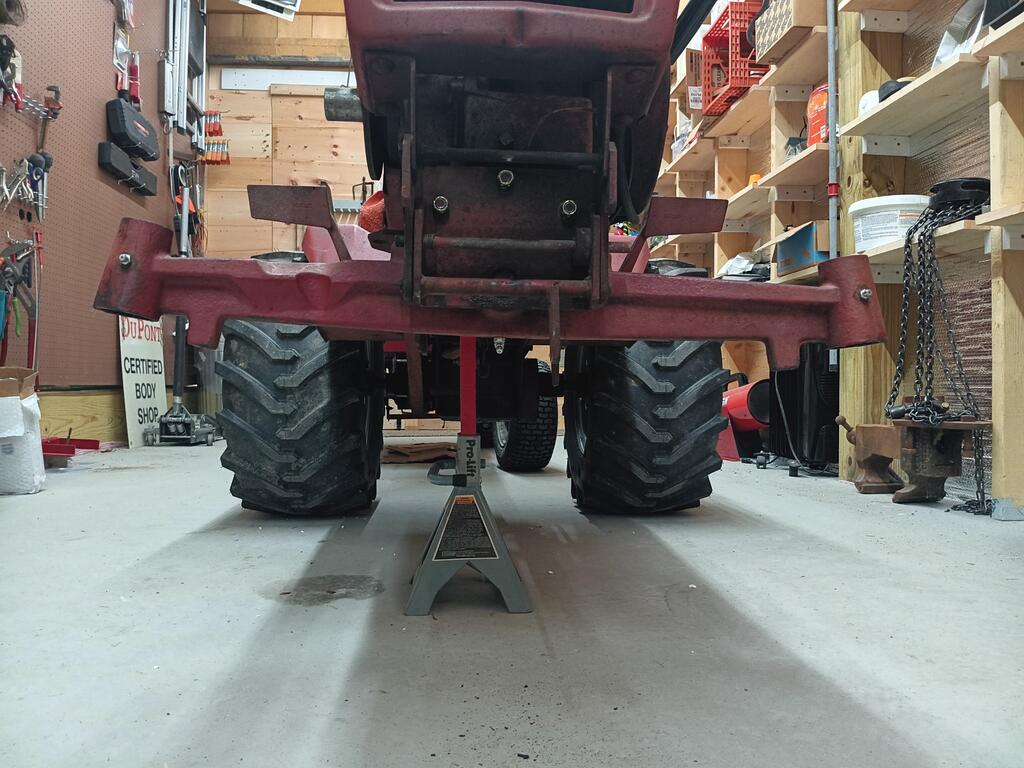

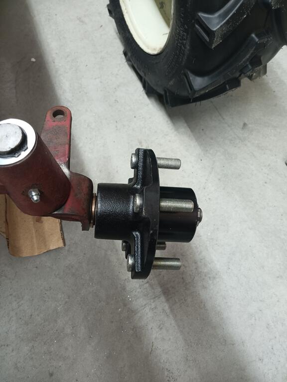

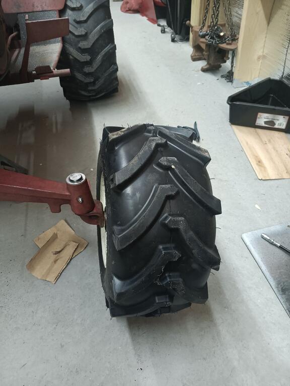

ebinmaine 81,225 #203 Posted July 6, 2025 As explained in this video the hub was going to be out a hair to far. I needed to cut the spacer that the seal is going to ride on. I used what I had to get the job done. Not exactly neat and clean... but effective. After mounting the wheel on the hub on the axle I found I needed a wheel spacer. That's not at all surprising considering these wheels are universal camper or go-kart with a centered backspacing. Here's a trial fit with the wheel on the spacer on the hub. That photo angle is a little misleading on the width. I can't get it too accurate yet but I think the front is going to be around 42", 43" across. The back is about 41". 3 2 1 Share this post Link to post Share on other sites
Handy Don 17,716 #204 Posted July 7, 2025 19 hours ago, ebinmaine said: I think the front is going to be around 42", 43" across With the stock wheels/tires, the track for the swept axle is 42" 1 Share this post Link to post Share on other sites
ebinmaine 81,225 #205 Posted July 7, 2025 8 minutes ago, Handy Don said: With the stock wheels/tires, the track for the swept axle is 42" I thought it was around that range somewhere. This definitely looks like it's going to be wider than that by a fair margin. Share this post Link to post Share on other sites
Handy Don 17,716 #206 Posted July 7, 2025 58 minutes ago, ebinmaine said: I thought it was around that range somewhere. This definitely looks like it's going to be wider than that by a fair margin. I just happen to have a swept axle with stock tires sitting in my storage area.... 1 Share this post Link to post Share on other sites
ebinmaine 81,225 #207 Posted July 7, 2025 7 minutes ago, Handy Don said: I just happen to have a swept axle with stock tires sitting in my storage area.... Imagine that.... Share this post Link to post Share on other sites

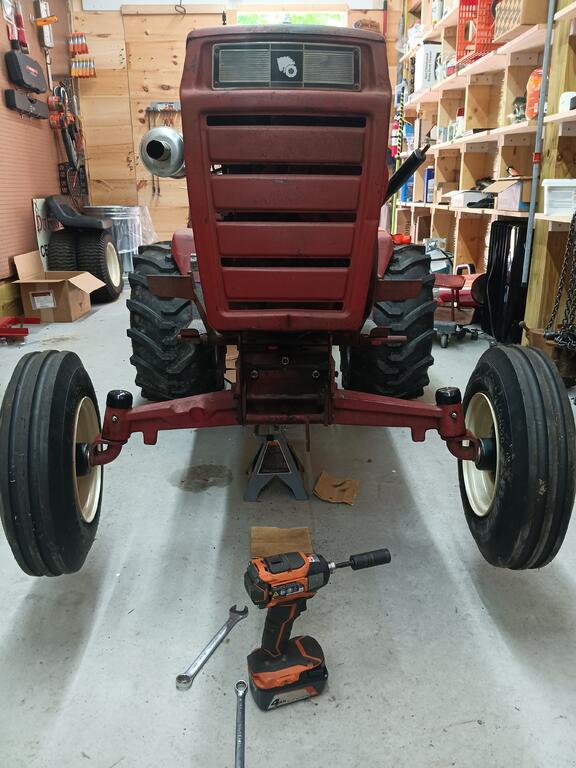

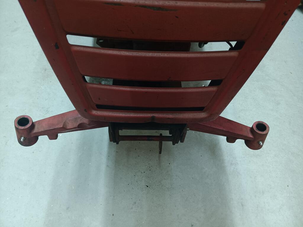

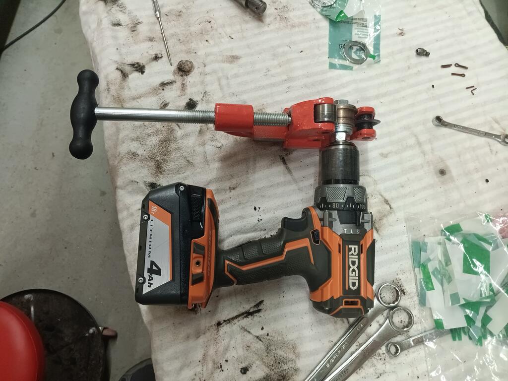

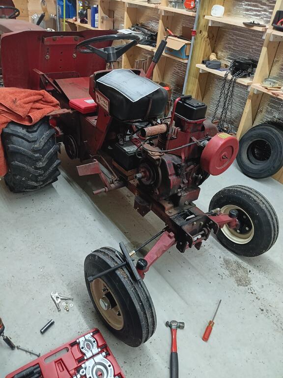

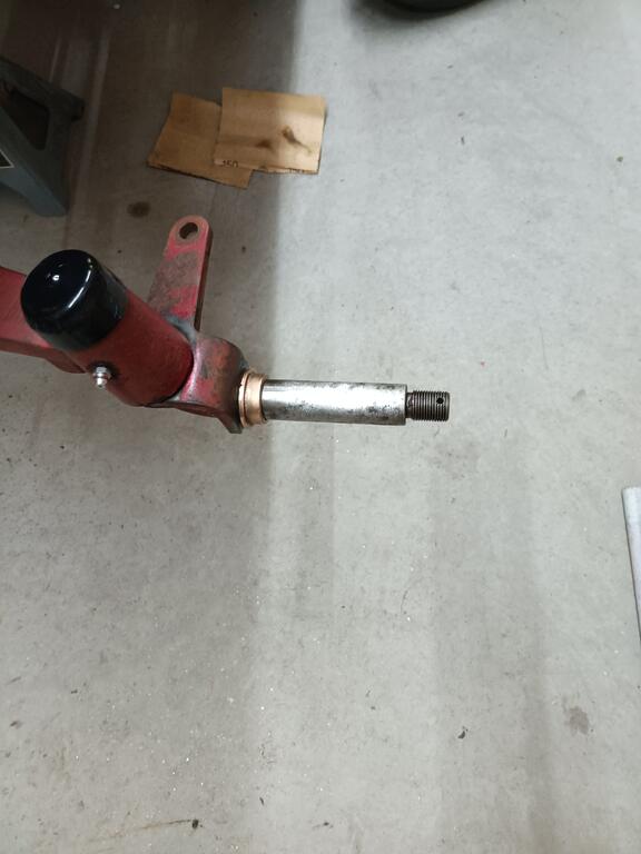

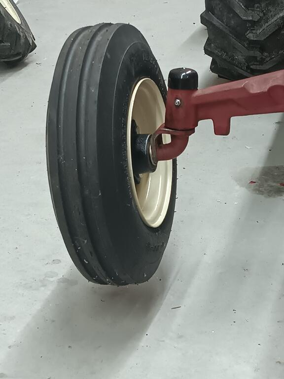

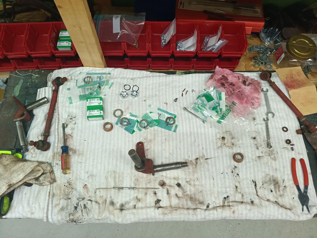

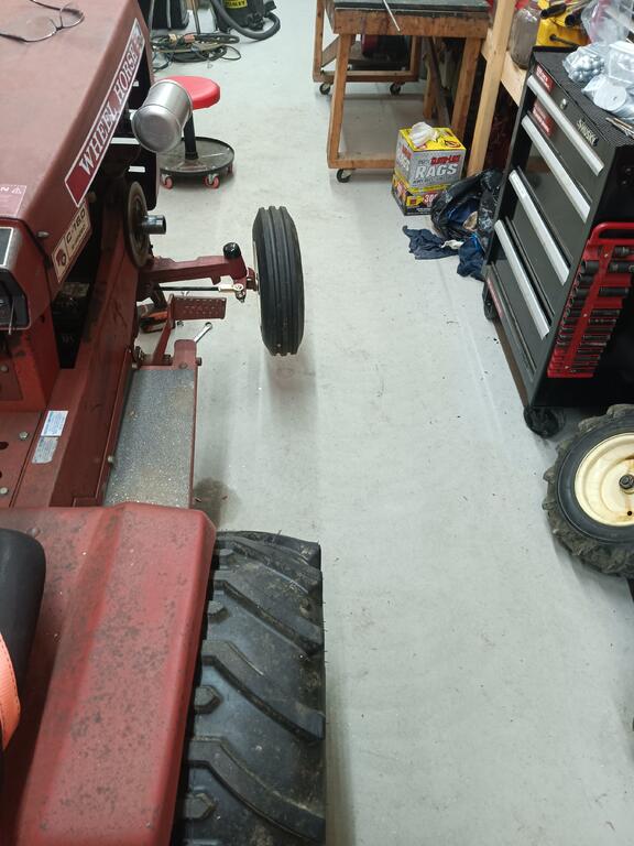

ebinmaine 81,225 #208 Posted July 17, 2025 I've had a hankerin' to see the set of wiiide front tires on this beast but they just didn't quite do it for me. Well I have a set of 5 x 4.5 narrow wheels with tri ribs. Those look good! This evening I got the test fitted hubs and wheel spacers back off. Removed the dry fitted LH spindle. Got some grease in both spindles and installed them. I also used a tool I don't recall getting but it's super handy. A Bearing Packer. Also, I did some poking around here on the site because I should get new tie rods. I found an old post showing that I'll need to build some heim joint rods. The stock C160-8 steering plate won't clear the 520H tie rods. I'll check the threads another day and order from McMaster Carr. May have been @JAinVA that had that info years ago... 2 1 Share this post Link to post Share on other sites

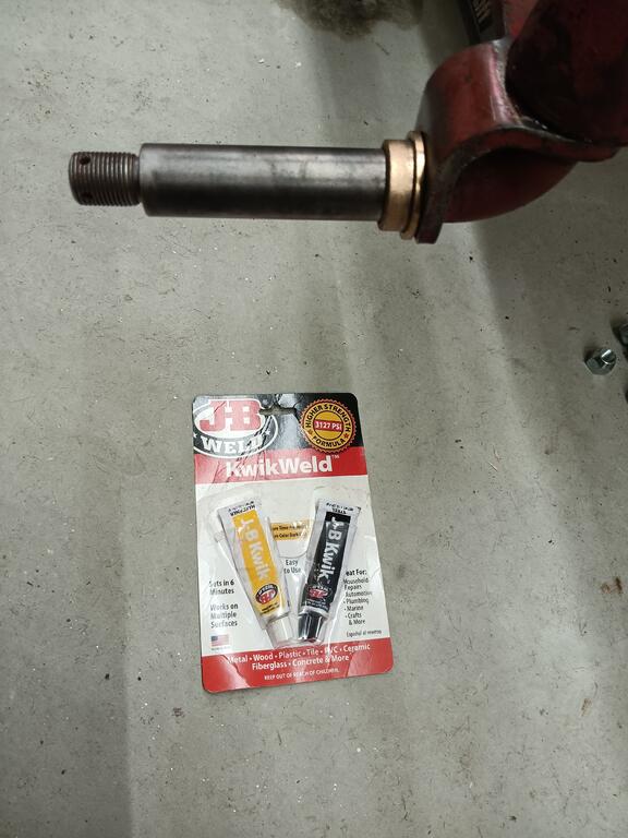

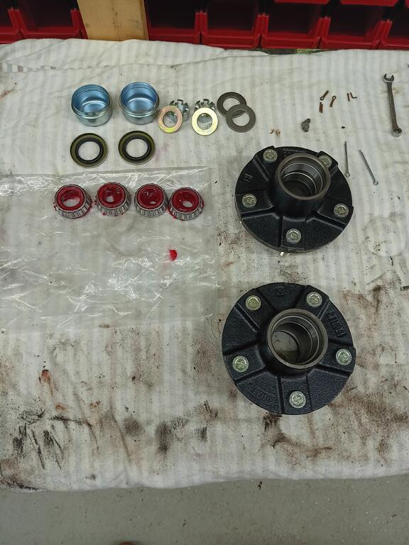

ebinmaine 81,225 #209 Posted July 19, 2025 Mission this morning is to get the adapter bushings held in place with a little J. B. Weld. Here's the 2,000 pound rated trailer hubs all set out and ready for installation. 2 2 Share this post Link to post Share on other sites
ebinmaine 81,225 #210 Posted July 19, 2025 Bushings are in place. Here's a wheel installed. Next project is to build tie rods. 3 1 Share this post Link to post Share on other sites

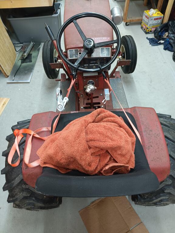

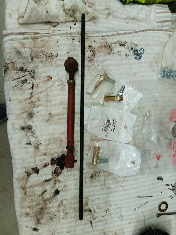

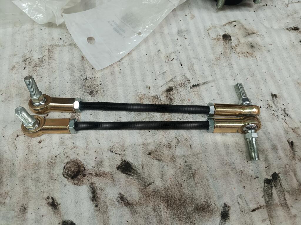

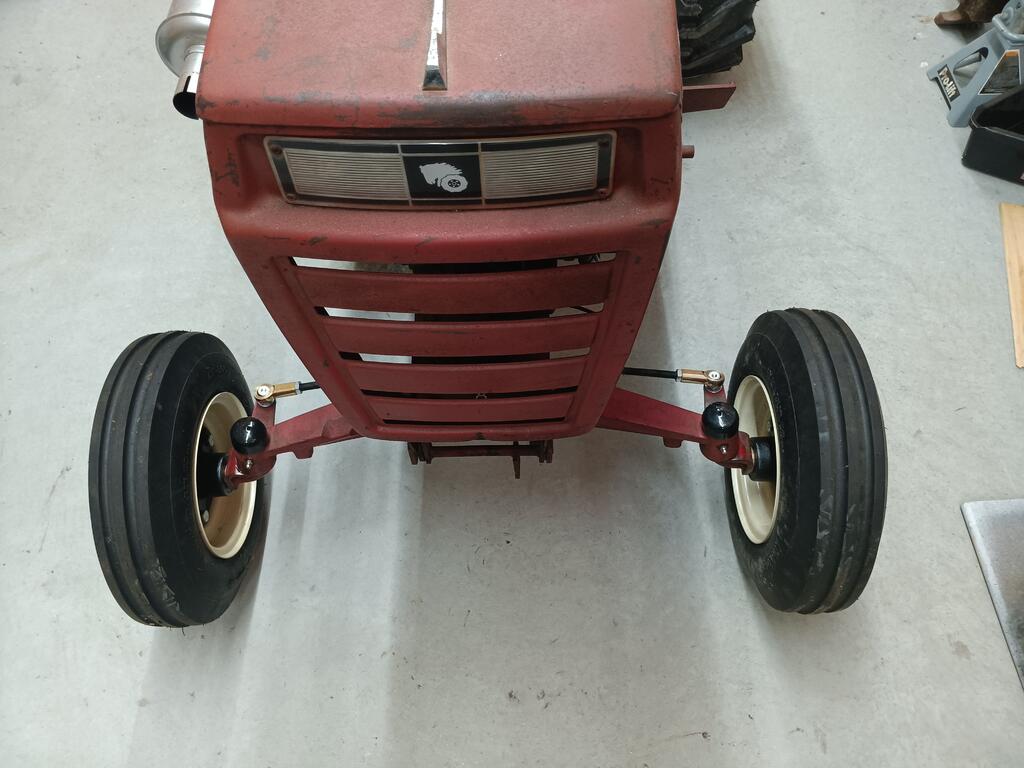

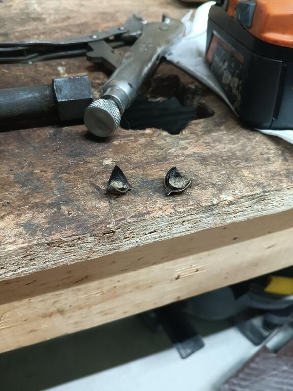

ebinmaine 81,225 #211 Posted July 19, 2025 Tie rods done. 7/16 male/female brass colored from McMaster Carr. Center rod is threaded rod medium strength (much better than local hardware stores) Steering wheel held as close to center as my eyecrometer could get. Tie rod installation complete. Awaiting proper lineup. I used a piece of 6' long threaded rod for an "almost straight edge". I then adjusted each side individually. I've come out about 3/4" total toe/tow in across the tires. Next is to get a @76c12091520h 2" receiver hitch installed. 5 1 Share this post Link to post Share on other sites

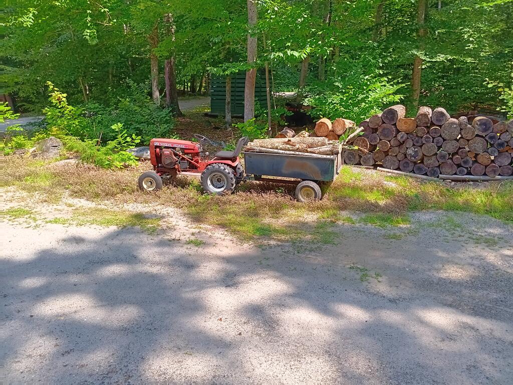

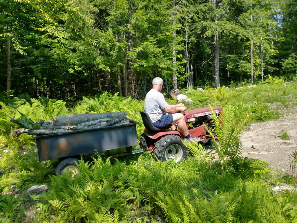

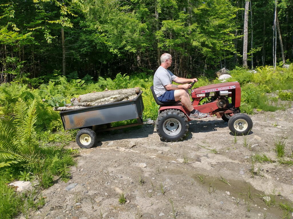

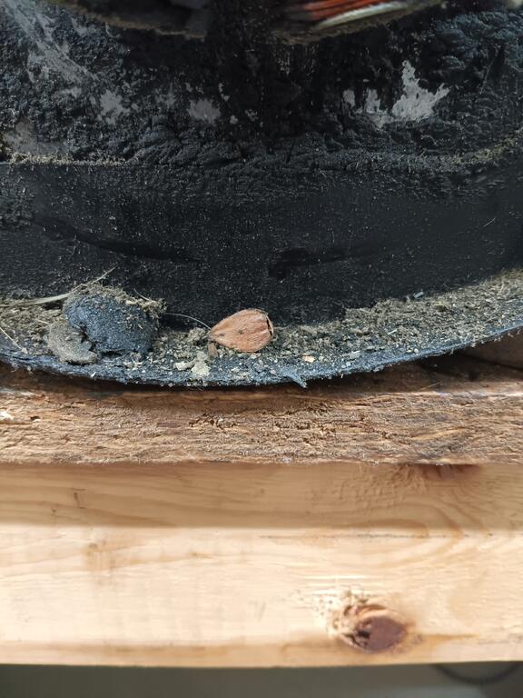

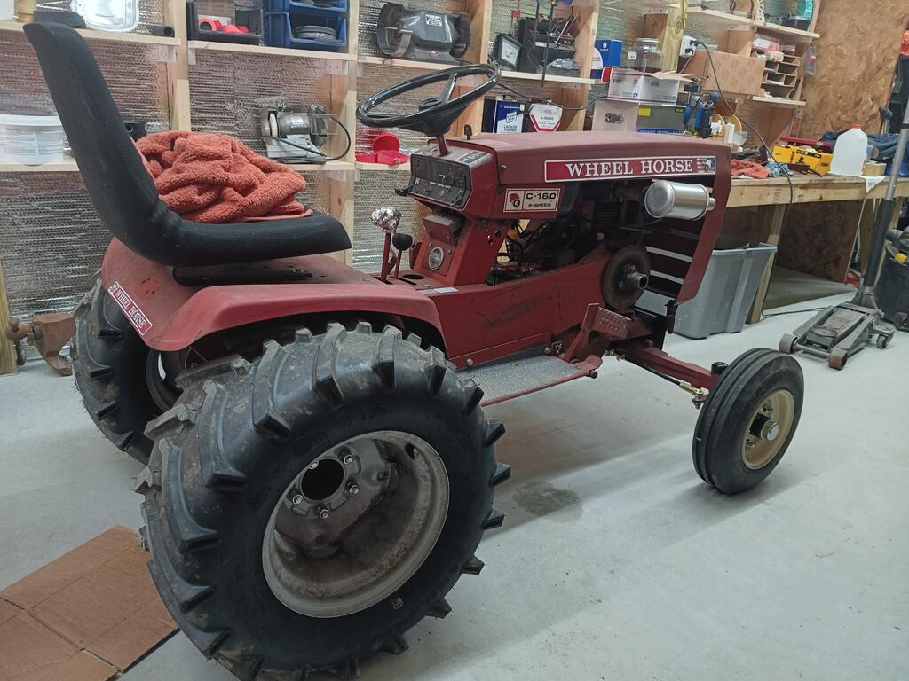

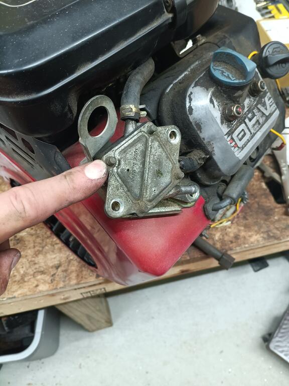

ebinmaine 81,225 #213 Posted July 27, 2025 Well after an inaugural run yesterday to get some logs outta the forest I've found there are some changes to be made. On the plus side I really like the stability of the wider & longer wheelbase and ease of steering the tri rib tires. Belt. I've known for awhile there may be an issue with the drive belt. It "slaps." Yesterday I tried hauling a heavy load uphill and the belt slips too. There's a bent/kinked spot in the belt from shelf setting over time. I may swap another heavy duty spring on and see if it's better before swapping for another belt. Axle stops. The top of the axle has cast in stop bumps to prevent the axle from twisting too far. These are a LOT bigger than on a standard straight axle. Going through the forest there were several times that one of the front wheels was off the ground. 😬 Engine..... well..... several things. A. It lacks RPM. Likely fixable. B. Carb adjustment is VERY tricky. C. Most important... there's a near constant ticking noise. Valve adjustment has been verified correct. Is it a normal noise?? I dunno. I don't think so. At whatever upper RPM I can get it's very concerning. And I'm nowhere near full 3600 yet. Is it a good reason to swap in a Briggs Vanguard 20 HP V twin? Yes. 1 1 Share this post Link to post Share on other sites

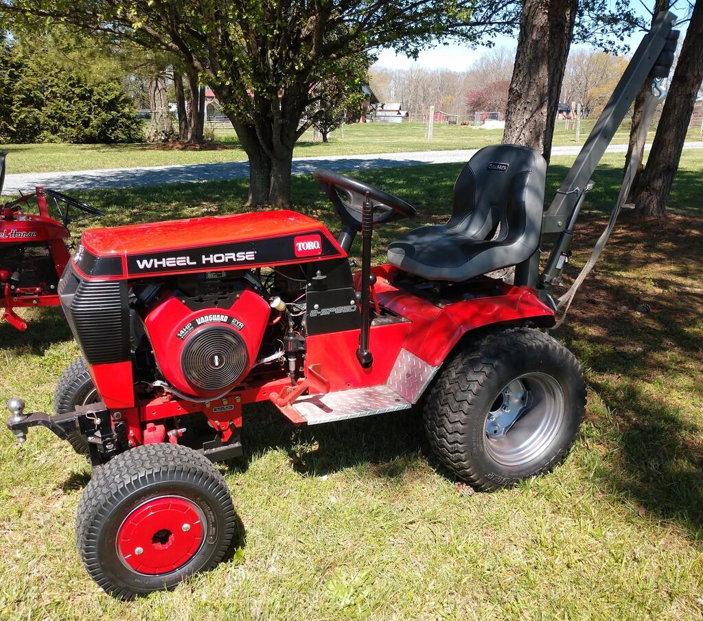

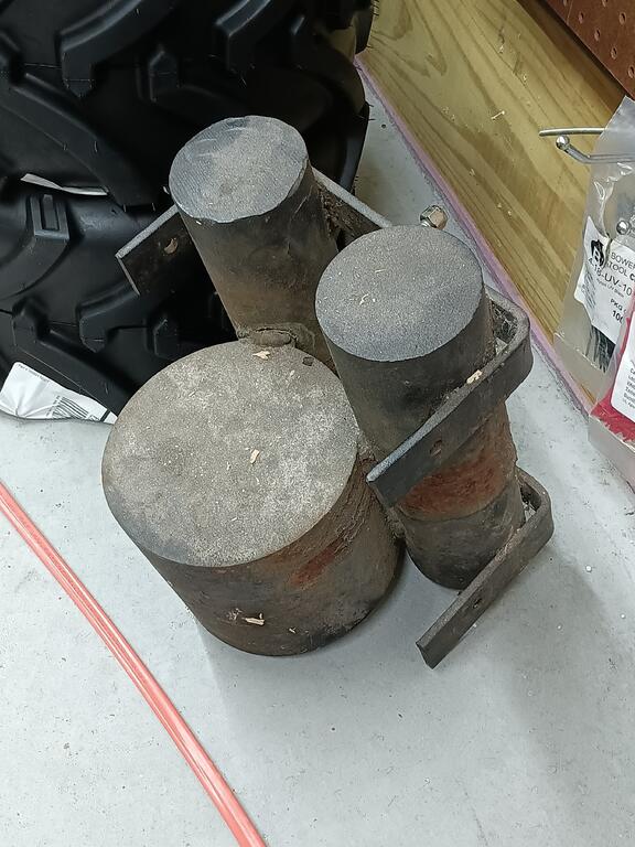

ebinmaine 81,225 #221 Posted July 28, 2025 10 minutes ago, kpinnc said: One consideration to keep in mind: I only say this because you previously used this tractor pulling a heavy trailer and you're building another larger trailer- you may want to look to put a few extra pounds up front. 10 minutes ago, kpinnc said: The Vanguard engines are significantly lighter than a big block Kohler. Definitely. I can lift the Vanguard with one hand. 10 minutes ago, kpinnc said: I doubt it's enough to change much, but I don't know how heavy a load you plan to move. Very heavy. The plan is to hang this. IIRC it's 115 lbs. plus whatever bracket.. 2 2 Share this post Link to post Share on other sites
kpinnc 19,088 #222 Posted July 28, 2025 2 hours ago, ebinmaine said: The plan is to hang this. IIRC it's 115 lbs. plus whatever bracket.. That outta do it! You've already been thinking about it. Awesome! 1 1 Share this post Link to post Share on other sites

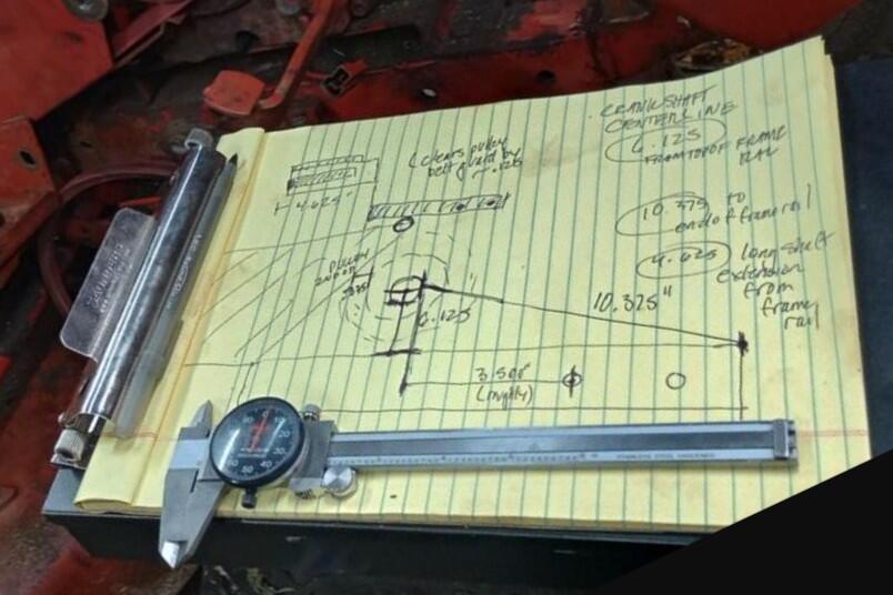

ebinmaine 81,225 #223 Posted August 12, 2025 Placing this pic as a note for measurements and possibilities. @jsoluna gets pic credit. Thanks! 3 1 Share this post Link to post Share on other sites

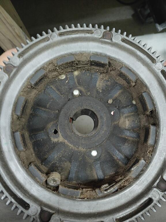

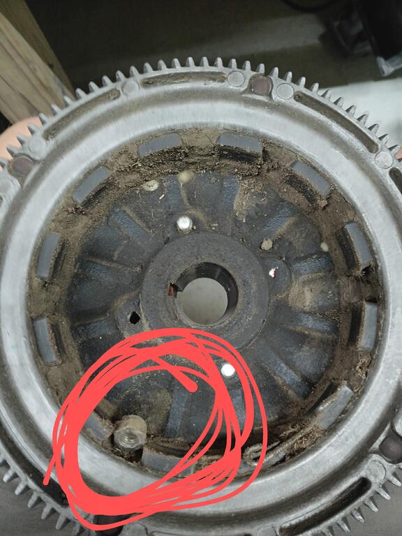

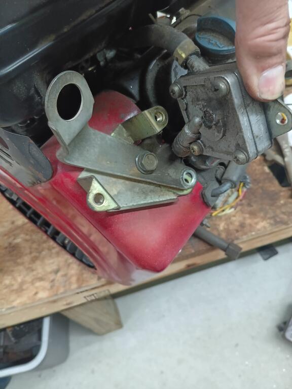

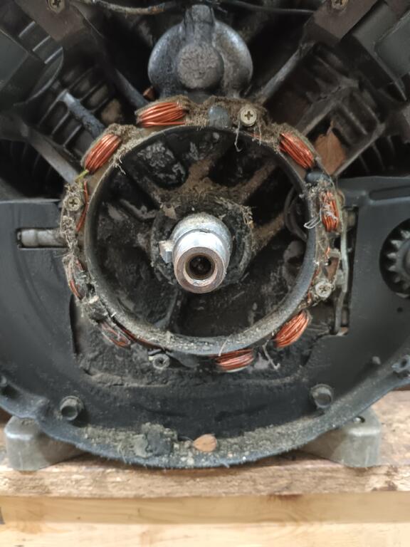

ebinmaine 81,225 #224 Posted August 14, 2025 (edited) @squonk I got some stuff done on the engine swap! RH side step off, belt and guard off. PTO sleeve off. This is for my own future reference. So..... I was fiddling around with the engine. Tried to spin it over. movement!! What. THEE ??!! Well ok..... I know it was running on the floor of the engine shop a couple weeks ago. Turn one way. Stop. Turn the other way. Stop. Awesome. The BBT recommended dissection. Engine sheet metal off. Flywheel off... and then..... What's this?? That's a loose nut behind the wheel. Edited August 14, 2025 by ebinmaine 2 2 Share this post Link to post Share on other sites
AlexR 3,139 #225 Posted August 14, 2025 Boy that is lucky that nut didn't get in there while it was running and destroy a bunch of things. 2 2 Share this post Link to post Share on other sites
