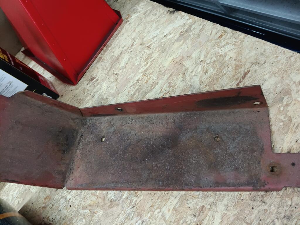

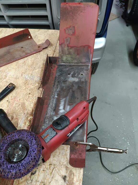

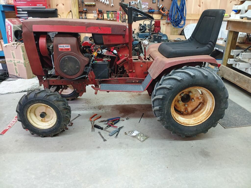

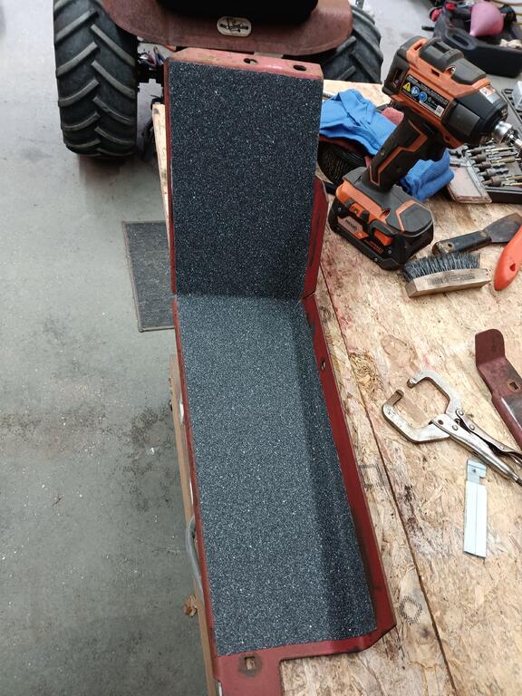

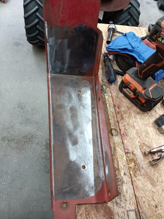

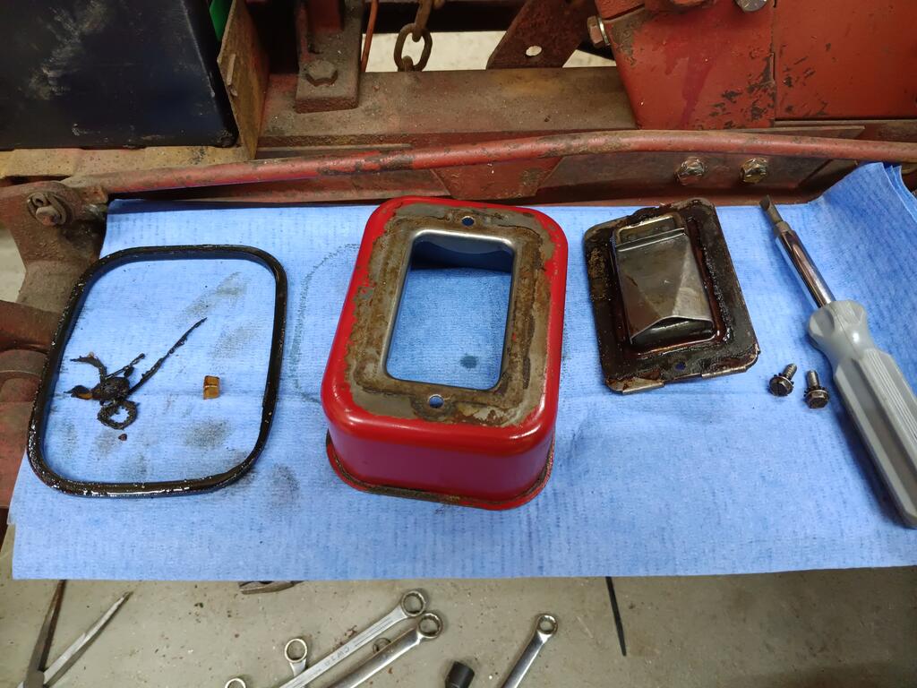

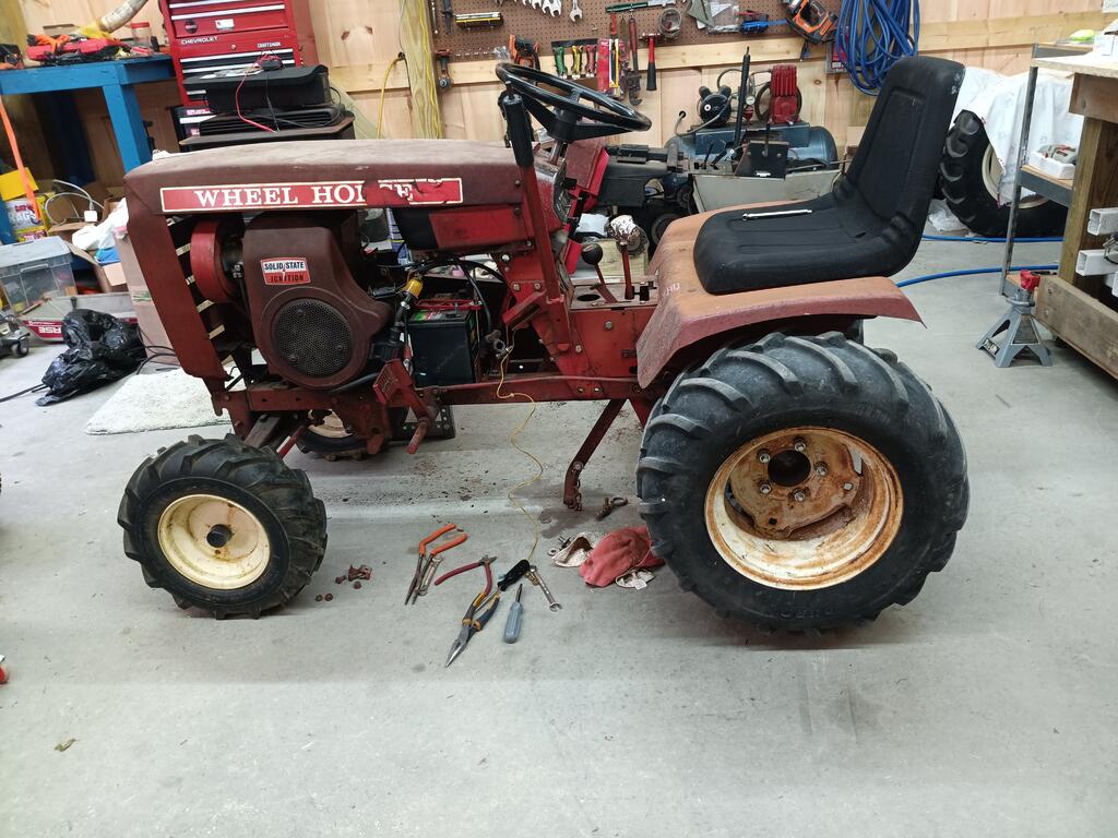

ebinmaine 80,684 #153 Posted August 16, 2024 Folks like @AMC RULES and @stevebo and all you other Patina lovin' types would be proud o' me on this build. I've been concentrated pretty hard on getting NO new paint except the wheels. There's a fair amount of parts swapping for this Beast to use the best mechanical but still original of everything I have around. This afternoon I commenced to repair on a seat and fender pan. I took into account the overall color, patina, and how difficult it was gonna be to straighten whatever fender I used. This is one from another C160-8 Tecumseh Horse that'll be a candidate for a full restoration later on. I also borrowed a brake drum and shoe from the parts shelf. The shoe had some gunky grease so I laid out a whole can of brake clean and scraped off the shoe surface. Installed that, adjusted the park brake. The list is getting shorter!! 1 5 Share this post Link to post Share on other sites

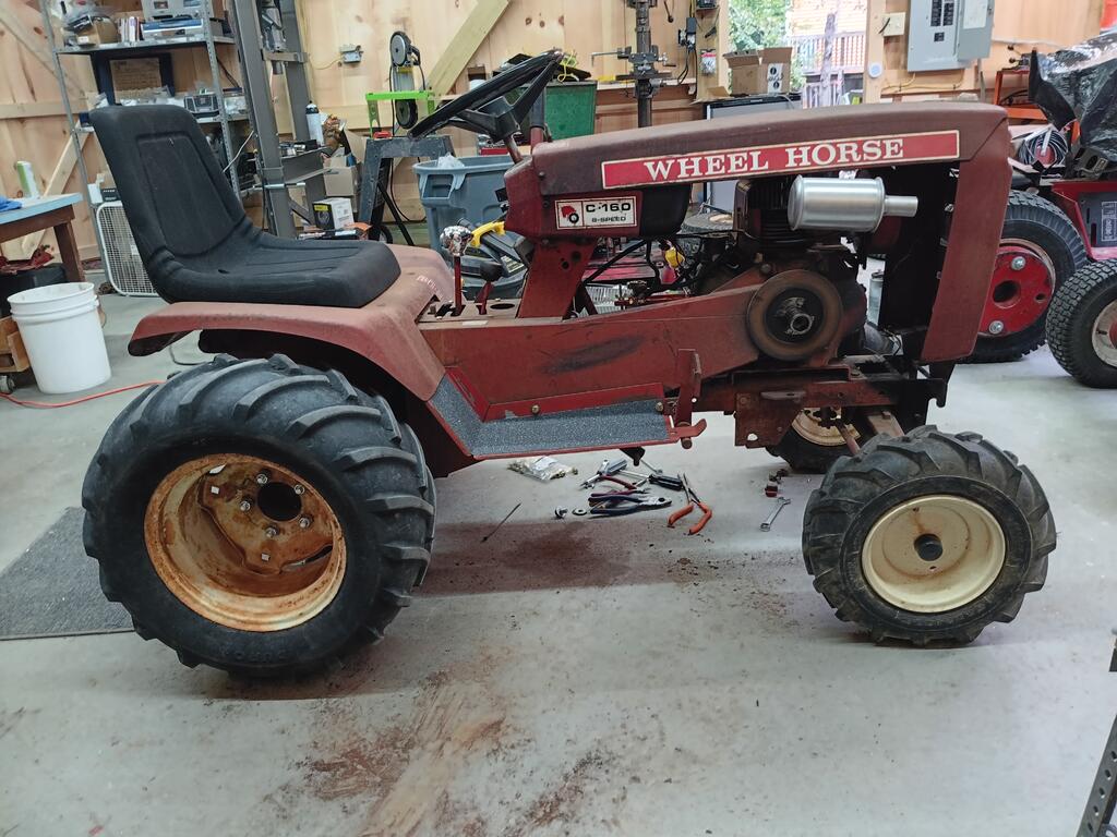

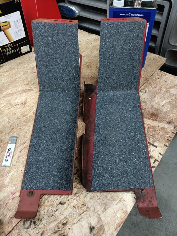

ebinmaine 80,684 #154 Posted August 16, 2024 Known To-do list: Remove and replace step grip tape. Install side steps. Put grass screen on engine. Drill wheel stud holes in Ag wheels. Install rear tubes. Mount rear wheels. Run extra ground (straps or wires.) Front wheels: remove, check bearings, add spacer washers. Start engine. Warm up. Adjust carb. 2 1 Share this post Link to post Share on other sites
sjoemie himself 3,186 #155 Posted August 17, 2024 (edited) Tractor is looking sweet. Although I'm still not in the 'pro-patina' camp I can understand in wanting to keep everything matching. Also.. kinda jealous of your parts shelf. 13 hours ago, ebinmaine said: Known I like that addition. Seems that some people (SO for example, or employers ) not always understand this concept. Edited August 17, 2024 by sjoemie himself 1 1 Share this post Link to post Share on other sites

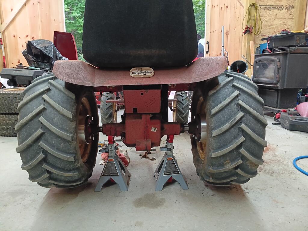

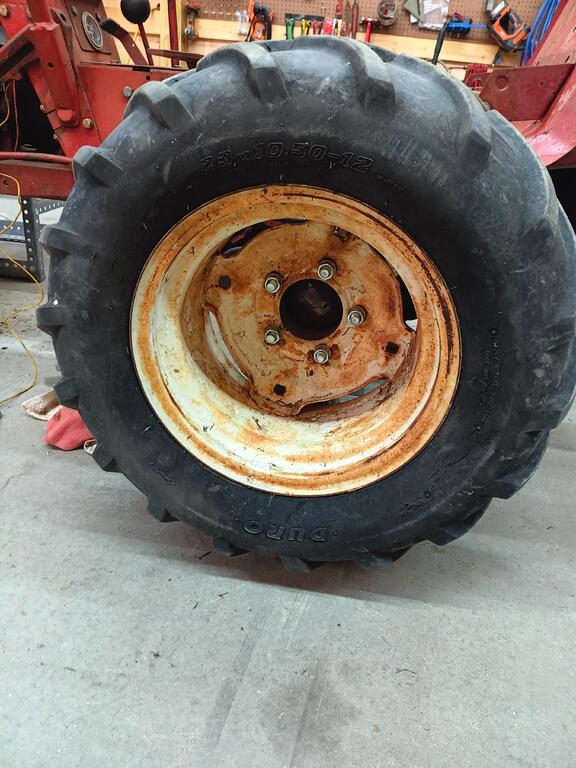

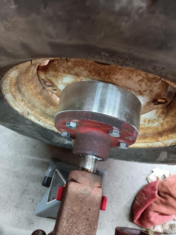

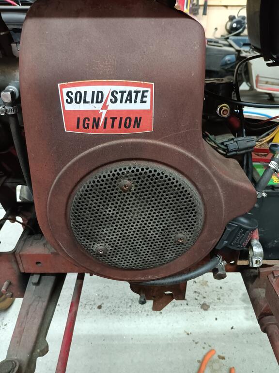

ebinmaine 80,684 #161 Posted August 17, 2024 Engine screen is on. Rear wheels have been drilled and mounted. The lug holes need to be expanded about 2 hair's width. The OE 7/16 holes are usually worn some. I refresh them to 1/2 for the wheel spacers. Some of the holes aren't even enlarged. This is definitely a Fat Bottom Girl. Just shy of 42" across the outside of the tires. Same as my other two running C160s. 3 6 Share this post Link to post Share on other sites

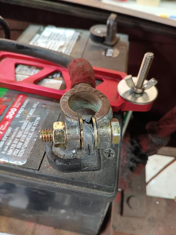

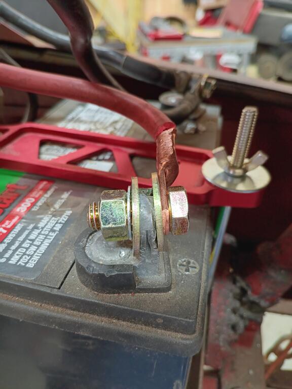

ebinmaine 80,684 #162 Posted August 18, 2024 The headlight buckets were pretty gunked up with old leaves and such. Got em cleaned out and now have power to both wires. Also will be swapping a better headlight lense on. This battery is now 5 years old. At some point in the past a previous owner split the positive terminal. It won't likely last through the cold seasons but it still works so I used a longer bolt and 2 washers to pinch the split terminal. 4 Share this post Link to post Share on other sites

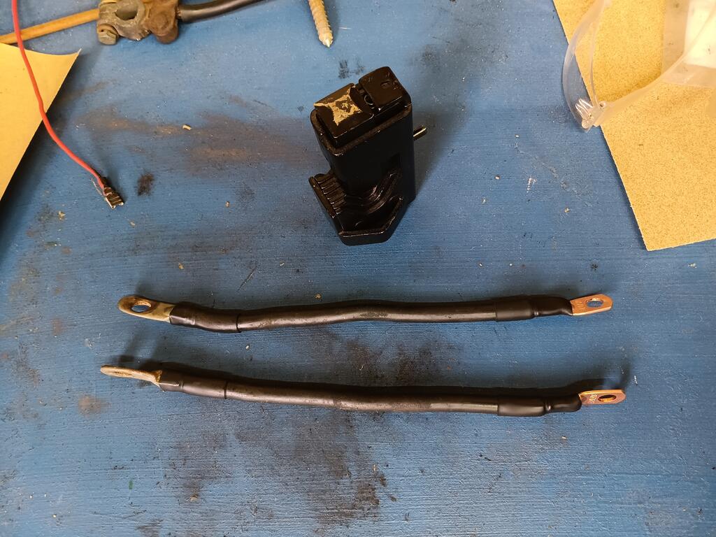

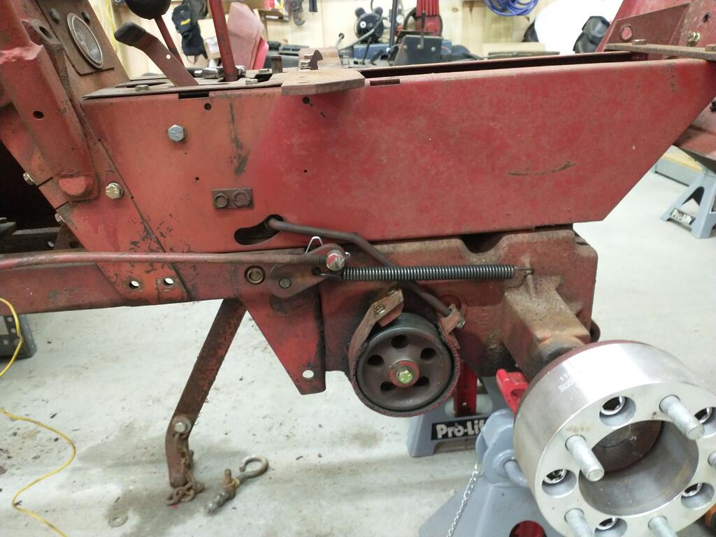

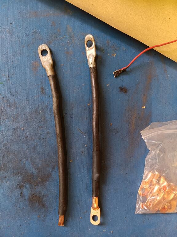

ebinmaine 80,684 #163 Posted August 18, 2024 I like to have extra ground cables. Redundancy is not a concern on a 12V DC system. The original Wheelhorse ground connects the battery to the underside of the fuel tank shelf. That's fine IF the tractor has no rust between the steering tower and frame and engine adapter and engine. Too many possibilities for interruption. The original cable had a repair on the battery end. I'm not a fan of bolted on terminal ends and the cable was stiff so that went in the round file. I had a cable in stock that had two 3/8 hole ends. I cut that in half and added a 5/16 copper terminal to each end. Heat shrink on all four ends. This afternoon I decided to clean up the side steps. One was on this tractor when I got it. The other is from my 1971 Bronco. Each tractor had the wrong step in the opposite side. ... so I swapped them to the correct tractor. Well that worked out well. First Trina used the heat gun to remove the old grip tape from the surface of the left step. I ground the surface of both, cleaned them with acetone, and added new black sand grip tape. I like to run the tape up the vertical part because that protects the paint from my boots. 1 6 Share this post Link to post Share on other sites
Moparfanforever 938 #164 Posted August 19, 2024 Very nice!!! Looks like it is going to be a good worker. 1 Share this post Link to post Share on other sites

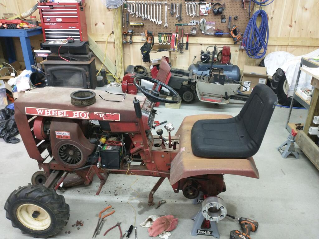

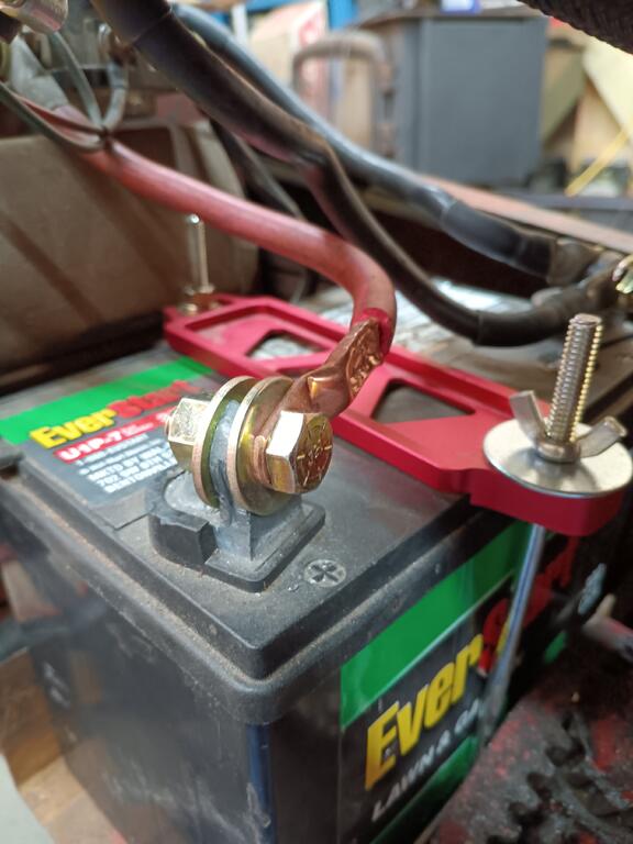

sjoemie himself 3,186 #165 Posted August 19, 2024 On 8/18/2024 at 6:59 PM, ebinmaine said: Interesting battery hold down strap. Looks to be plastic? Do you have more info on it? 1 Share this post Link to post Share on other sites
ebinmaine 80,684 #166 Posted August 19, 2024 1 hour ago, sjoemie himself said: Interesting battery hold down strap. Looks to be plastic? Do you have more info on it? It's actually red anodized aluminum or as the Brits say aluminium ... I bought it to fit either a Group 35 or 51/51R battery. As you can see I've trimmed one end to clear the Tecumseh starter. Works excellent. 2 1 Share this post Link to post Share on other sites
lynnmor 9,038 #167 Posted August 19, 2024 12 minutes ago, ebinmaine said: It's actually red anodized aluminum or as the Brits say aluminium ... I bought it to fit either a Group 35 or 51/51R battery. As you can see I've trimmed one end to clear the Tecumseh starter. Works excellent. If that allouminium touches that POS battery connector it will get real ugly, real fast. 1 Share this post Link to post Share on other sites
ebinmaine 80,684 #168 Posted August 19, 2024 9 minutes ago, lynnmor said: If that allouminium touches that POS battery connector it will get real ugly, real fast. Just think of all the pretty fireworks 🎆 That cable is: Well insulated. Tightly installed. Temporary. 1 Share this post Link to post Share on other sites
lynnmor 9,038 #169 Posted August 19, 2024 3 minutes ago, ebinmaine said: Just think of all the pretty fireworks 🎆 That cable is: Well insulated. Tightly installed. Temporary. I understand, and I know you will do your best, but I have seen some marginal battery holding on here and we should point out potential serious problems. 1 Share this post Link to post Share on other sites
ebinmaine 80,684 #170 Posted August 19, 2024 Just now, lynnmor said: I understand, and I know you will do your best, but I have seen some marginal battery holding on here and we should point out potential serious problems. ABSOLUTELY AGREED. If anyone ever reads this in the future... just know it was only to hear the engine start. 1 Share this post Link to post Share on other sites

sqrlgtr 3,901 #172 Posted August 20, 2024 On 8/17/2024 at 6:59 PM, ebinmaine said: Engine screen is on. Rear wheels have been drilled and mounted. The lug holes need to be expanded about 2 hair's width. The OE 7/16 holes are usually worn some. I refresh them to 1/2 for the wheel spacers. Some of the holes aren't even enlarged. This is definitely a Fat Bottom Girl. Just shy of 42" across the outside of the tires. Same as my other two running C160s. @ebinmaine can you elaborate a little more on the wheel spacers , i.e. stud size of spacers and thread and what size are you drilling the holes out to in the wheels. Thought about putting some fatty's on the back of the 701, it can get a little "unstable" on the sides of the hills around here. Thanks 1 Share this post Link to post Share on other sites
ebinmaine 80,684 #173 Posted August 21, 2024 3 minutes ago, sqrlgtr said: @ebinmaine can you elaborate a little more on the wheel spacers , i.e. stud size of spacers and thread and what size are you drilling the holes out to in the wheels. Thought about putting some fatty's on the back of the 701, it can get a little "unstable" on the sides of the hills around here. Thanks Be happy to. I can send a PM with purchase info too. I use 2" spacers normally. They have a 1/2" outer lug stud. Wheelhorse and most garden tractors use a 7/16 wheel bolt hole. The holes need to be cleaned up to 1/2. Usually I fins that 1 or 2 of the 5 holes per wheel don't even get touched. On the high side you're removing 1/16 so 1/32 all around. I get the spacers on fleeebay. It's important to get spacers with NO centering lip and be aware of the large center bore. I get internal hex wheel bolts as well. These are necessary because a socket wont fit around many standard lug nuts inside the spacer holes. All easy stuff. 2 2 Share this post Link to post Share on other sites

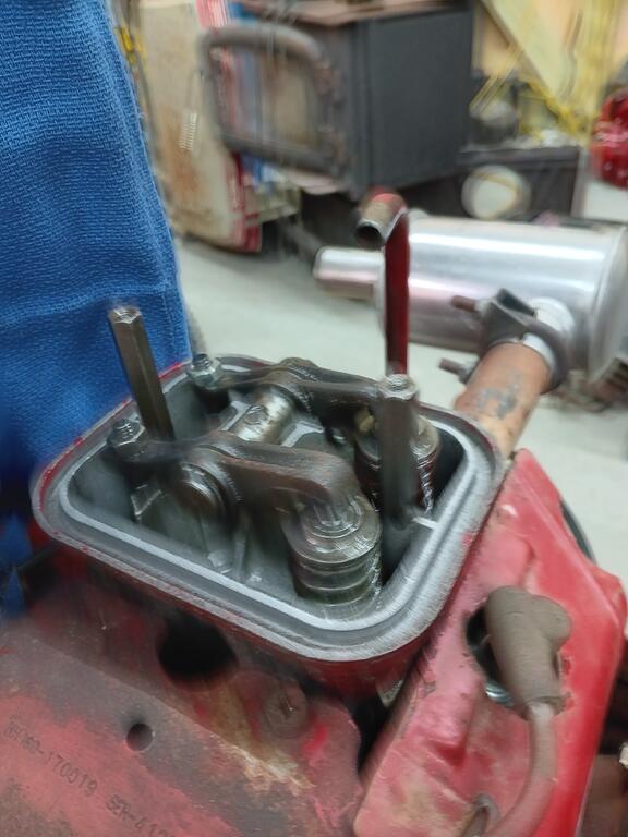

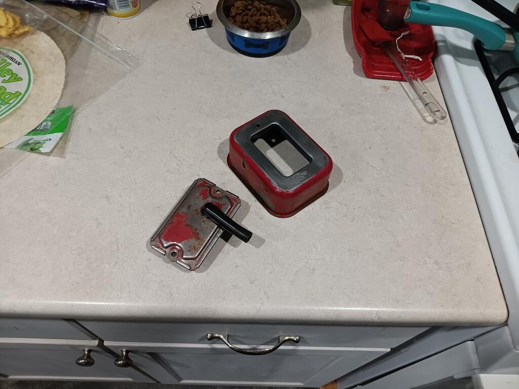

ebinmaine 80,684 #174 Posted August 27, 2024 @lynnmor You'll be happy to know I replaced the temporary positive battery cable this afternoon. This was an automotive cable that had a bad end. Chopped that. Cut to length. Installed. Also started getting to the oil leak at the valve cover. I read a few weeks ago that the valve cover MUST BE SEALED in order to create vacuum to draw the engine oil to that location. It was definitely getting oil. It was also leaking it. 2 Share this post Link to post Share on other sites

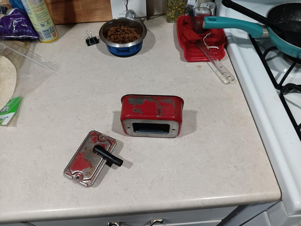

ebinmaine 80,684 #175 Posted August 29, 2024 Did some research and ordered a new breather, tube and an NOS valve cover. I don't necessarily need the valve cover but I have 3 of these engines I'd like to see running and one's rough looking. I got these parts all cleaned up and rust removed. The Paint Department is putting a coat of Rust-Oleum 2X Satin Canyon Black on them. 4 Share this post Link to post Share on other sites
