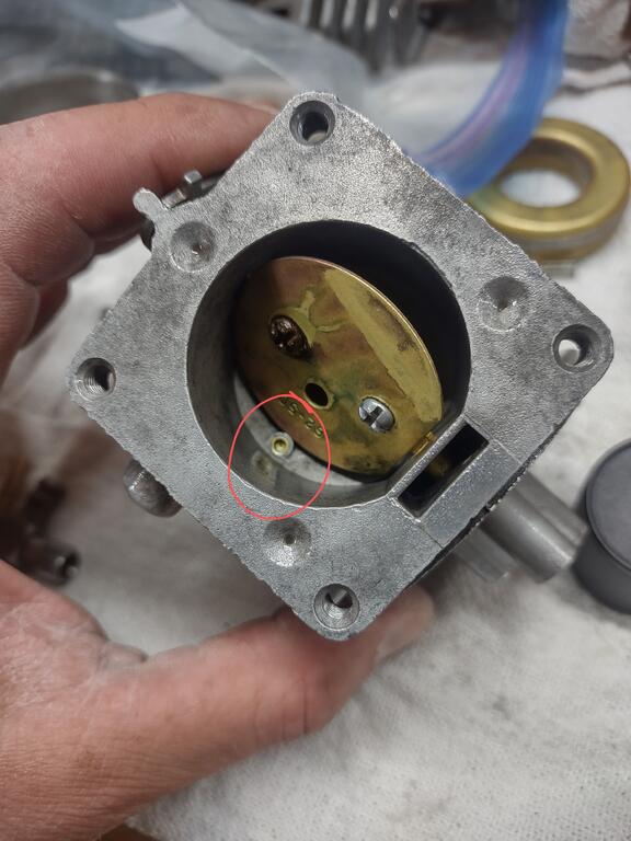

oliver2-44 11,739 #51 Posted September 9, 2022 (edited) Those 2 choke screws are different colors, me thinks someone has tinkered with that carb before you EB. Maybe the choke plate is upside down or even the wrong one. Seems like I’ve seen where the choke plate has a notch out for that little nubbie. Edited September 9, 2022 by oliver2-44 4 Share this post Link to post Share on other sites
Horse Newbie 7,405 #52 Posted September 9, 2022 (edited) Perhaps the brass choke flap needs to be taken out and reinstalled with the flap “above” the nub … maybe the choke flap won’t open as far, but the engine should get enough air… and it would close all the way. Edited September 9, 2022 by Horse Newbie 2 Share this post Link to post Share on other sites
ebinmaine 80,684 #53 Posted September 9, 2022 6 hours ago, oliver2-44 said: Those 2 chicken screws are different colors, me thinks someone has tinkered with that carb before you EB. Maybe the choke plate is upside down or even the wrong one. Seems like I’ve seen where the choke plate has a notch out for that little nubbie. Interesting little trinket of information isn't it? I've seen other carburetors where the screws were distinctly two different colors because one rusted and the other one didn't. Don't know why that happens. I am fairly sure that this is not the original carburetor for this engine because the color wasn't right. I'll have to take a minute and check my other Tecumsehorse to see how that one looks. 1 Share this post Link to post Share on other sites
Handy Don 17,473 #54 Posted September 9, 2022 9 hours ago, oliver2-44 said: Seems like I’ve seen where the choke plate has a notch out for that little nubbie. I concur about the notch. I'm fairly sure the purpose of the opening in the body is to let the engine pull air through a fuel vaporizing passage so it needs clear access. 2 Share this post Link to post Share on other sites
ebinmaine 80,684 #55 Posted September 9, 2022 (edited) On 9/9/2022 at 9:05 AM, Handy Don said: opening in the body This one? Edited September 15, 2022 by ebinmaine 1 Share this post Link to post Share on other sites
ebinmaine 80,684 #56 Posted September 9, 2022 @Handy Don Also interesting about this particular carburetor is that I don't think it has any internal plunger. It's obviously a very different shape from a Kohler carburetor but it's a much more simple design than a normal Tecumseh carburetor. It appears that the three holes behind the Welch plug are for additional air flow? It's going to be a bit before I get time to mess with this thing but I'm looking forward to seeing if it runs better now that it's been cleaned out. 1 Share this post Link to post Share on other sites
Handy Don 17,473 #57 Posted September 9, 2022 7 hours ago, ebinmaine said: This one? Yes. 👍🙂 2 Share this post Link to post Share on other sites

ebinmaine 80,684 #62 Posted September 14, 2022 @oliver2-44 @Horse Newbie @Handy Don So those screws in the choke flapper .... I agree they've been out/replaced/moved/changed This evening I spent a minute with this carb and discovered that the screws in the choke flap were moved at some point in the past. Why so I figure so? As soon as I loosened the silver one the flapper moved. For the rusted looking screw I did the @Pullstart advised tighten slightly then loosen method. I got all 4 screws out so it can be cleaned better when I have more time. Now about the air holes/galleys behind the Welch plug... there are 3 or 4. At least one - I believe - was closed. Then another was pretty schmutzzy. I bit of itty-bitty wire helped. 1 Share this post Link to post Share on other sites

Jayzauto 89 #64 Posted September 15, 2022 2 hours ago, ebinmaine said: Now about the air holes/galleys behind the Welch plug... there are 3 or 4. So those holes behind the plug are transfer ports..... Generally there will be 3 on most carbs. If you look closely, there are usually located at the throttle plate, and they act as sort of an accelerator pump, because most of these carbs do not have that pump. They are located just after the throttle plate when closed, so when the throttle is cracked, there will be fuel enrichment for accelerating up to high speed...will prevent a stumble when throttle opened. they are tied into the circuit for low speed idle mixture. That circuit is 'vented through the face of the throttle bore.... if you look head on at the carb, it's usually the smaller hole, with a small brass insert in it, on the same side as the welch plug. So after I boil out a carb and clean those transfer ports, Replace the welch plug and spray carb cleaner through that vent..... Look through the carb at the throttle end, with the throttle open and you can verify 3 small streams of spray (the low speed jet should be installed). Then your sure to be ready for action.. GLuck, Jay 2 1 1 Share this post Link to post Share on other sites

ebinmaine 80,684 #67 Posted September 15, 2022 6 hours ago, Jayzauto said: That circuit is 'vented through the face of the throttle bore.... if you look head on at the carb, it's usually the smaller hole, with a small brass insert in it, on the same side as the welch plug On 9/9/2022 at 9:26 AM, ebinmaine said: This one? Jay is that the vent hole? Doesn't appear to be a hole at all though I wondered if there should be. 1 Share this post Link to post Share on other sites
