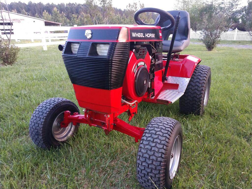

sqrlgtr 3,901 #254 Posted January 2 3 minutes ago, Handy Don said: Ah, the big “IF”! “Previous Owners” are a mysterious and mischievous lot. Lots of front wheel sizes but, my experience is that the 16x7.50-8 tires were only on swept-axle tractors. The wheels had taper bearings in a different hub. The next largest (from memory here) was 16x6.50-8 on 418’s and the earlier 520s. Depending on the tire, they can be hard to distinguish. I'm just going by a pic but appears it has the bigger wheels/tires on front, can't see rears. this got me to thinking about the rears, did all the swept axle tractors have the wider rear wheels? 1 Share this post Link to post Share on other sites

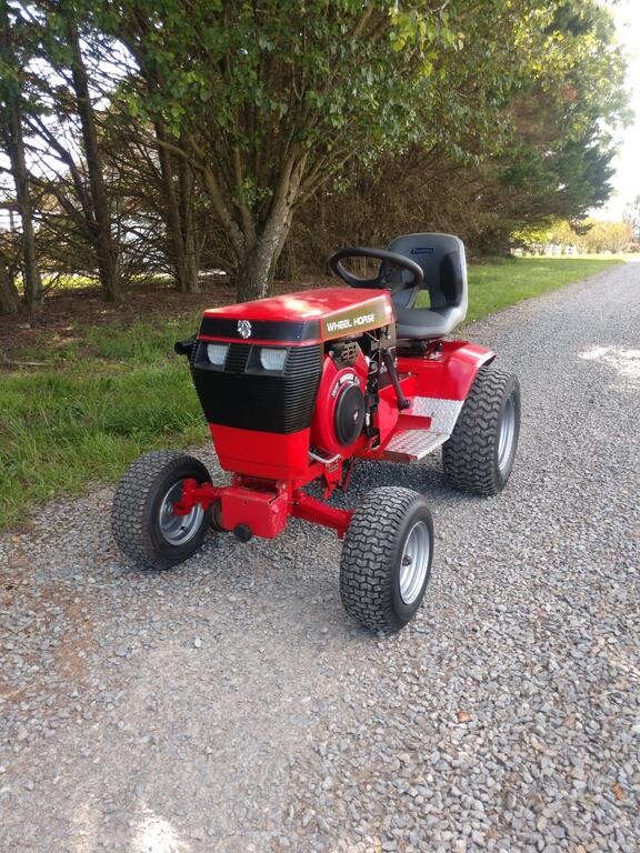

kpinnc 18,952 #256 Posted January 2 (edited) 28 minutes ago, sqrlgtr said: Is it safe to say that the wider wheels where on the swept axle machines unless someone had changed them? As Don said the PO may have changed some things. I've only ever seen the 7.50 front tires on the swept axle 520 models, but have seen them with 6.50 as well. I put both on my modified 14hp tractor. The difference is minimal. The pics below are 6.50 and then 7.50. Same exact tread pattern, so it's quite hard to see the difference. Tiny bit more bulge in the sidewall is about all that is visibly different. The third pic is a close up of the 7.50 with weights. Edited January 2 by kpinnc 2 1 Share this post Link to post Share on other sites
sqrlgtr 3,901 #257 Posted January 2 17 minutes ago, kpinnc said: As Don said the PO may have changed some things. I've only ever seen the 7.50 front tires on the swept axle 520 models, but have seen them with 6.50 as well. I put both on my modified 14hp tractor. The difference is minimal. The pics below are 6.50 and then 7.50. Same exact tread pattern, so it's quite hard to see the difference. Tiny bit more bulge in the sidewall is about all that is visibly different. The third pic is a close up of the 7.50 with weights. You're not kidding, is the 7.5 on the left side in top pic? It looks slightly flatter across the tread to me. Share this post Link to post Share on other sites

kpinnc 18,952 #260 Posted January 2 (edited) 16 minutes ago, sqrlgtr said: You're not kidding, is the 7.5 on the left side in top pic? It looks slightly flatter across the tread to me. Nope. Both 6.50 in first pic and both 7.50 in the second. I think the narrower width just pulls the tread a little flatter on the smaller tire. I think older tires had significantly more difference between the two sizes. I purchased the 7.50 size because of a set of old Carlisles I had seen on a 520-H. Edited January 2 by kpinnc 1 Share this post Link to post Share on other sites
sqrlgtr 3,901 #261 Posted January 2 2 minutes ago, kpinnc said: Nope. Both 6.50 in first pic and both 7.50 in the second. I think the narrower width just pulls the tread a little flatter on the smaller tire. I think older tires had significantly more difference between the two sizes. I purchased the 7.50 size because of a set of old Carlisles I had seen on a 520-H. Oh I misunderstood I thought you had two different sizes on at one time. I cant tell difference. Share this post Link to post Share on other sites
kpinnc 18,952 #262 Posted January 2 2 hours ago, sqrlgtr said: I cant tell difference. If I had known how little difference the 7.50 was, I would have left those brand new 6.50s right where they were. Of course different brands may be closer to the "actual" size. I have a couple sets of 520 front wheels with older 6.50 tires that are as wide the 7.50 size that I bought. 2 Share this post Link to post Share on other sites

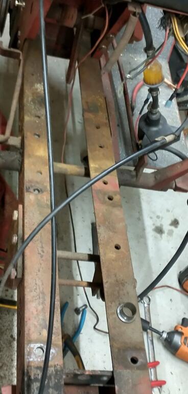

Bill D 3,154 #263 Posted January 2 10 hours ago, ebinmaine said: @Handy Don or whomever... the bearings at the ends of the steering shaft. 3/4" bore. 2 bolt holes. How do I buy those? I think those are still available thru Toro. Don't know the part number though. 1 Share this post Link to post Share on other sites
ebinmaine 80,684 #264 Posted January 3 On 1/1/2026 at 7:50 PM, Handy Don said: They are called two-bolt flange bearings. Surplus Center or McMaster for sure. Looks like the OE Wheelhorse bearing is an odd size. Share this post Link to post Share on other sites
Handy Don 17,473 #265 Posted January 3 4 hours ago, ebinmaine said: Looks like the OE Wheelhorse bearing is an odd size. In which dimension? Lower steering shaft diameter? Mounting bolt placement? Height above the mounting surface? Share this post Link to post Share on other sites
ebinmaine 80,684 #266 Posted January 3 4 minutes ago, Handy Don said: In which dimension? Lower steering shaft diameter? Mounting bolt placement? Height above the mounting surface? Shaft diameter is easy to find at .75 or 3/4. Mounting height has a little bit of flexibility in it as well. The ones I'm seeing online all seem to have a 2.5" mounting bolt center distance. The one I have is 2.25" 1 Share this post Link to post Share on other sites

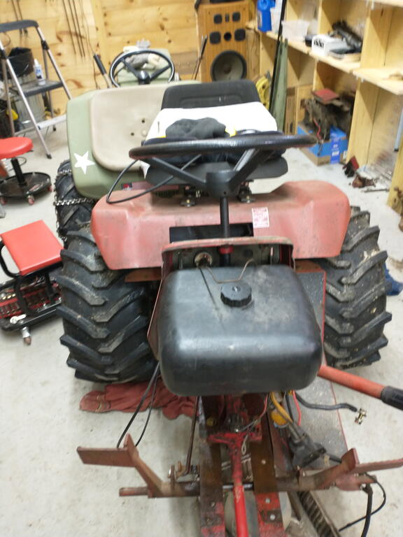

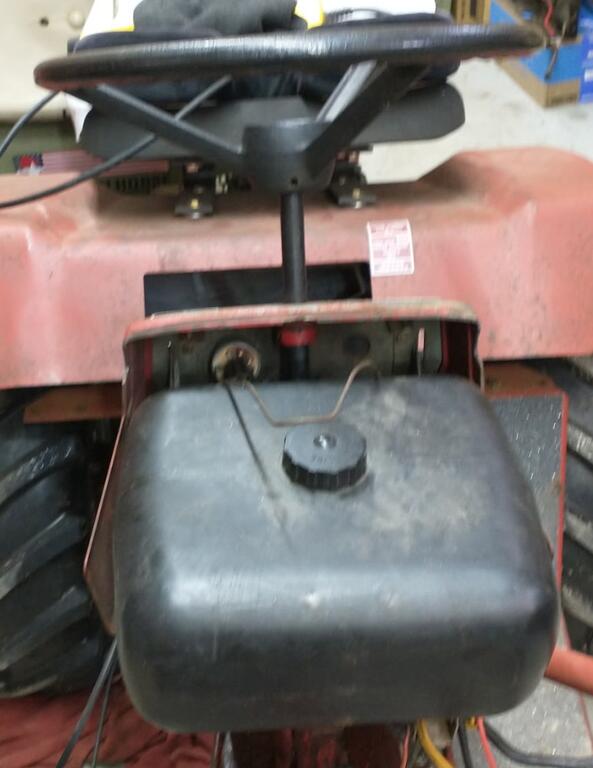

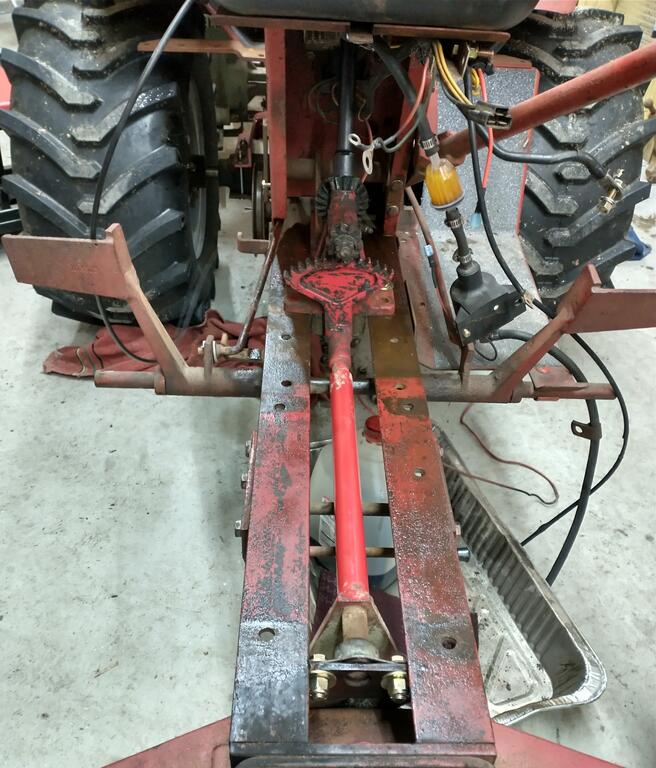

ebinmaine 80,684 #267 Posted January 4 More progress on this beast yesterday. While I was working on engineering and creating a stepped key for Trina's Military Tribute Tractor "Millie", she was puttering on my frame and steering. She started by scrubbing the dust & rust off slightly. Then used rags to lay on some used motor oil. I'd have used Flood Penetrol but didn't have any. The oil will work fine for rust and corrosion resistance. Before: After: Also note in the above pic that the gear reduction steering system is now in. During installation I tightened up the castle nut on the reduction gear to eliminate most of the slop. The forward bearing however is quite loose. I have communications out to @76c12091520h about getting new ones. At this stage it's only a few bolts to pop out and replace that bearing. The only issue we could see that needs immediate addressing is that the rear horizontal gear ⚙️ is contacting the tractor lift arm. 🤔 Either the pillow needs to be moved forward or the arm needs to be trimmed. Possibly a bit of both. I'll also drill and/or resize the 2 extra holes where the pillow block sets. As some folks know, the upper steering shaft from a 520H sets higher in older tractors because of geometry differences. The extra height of the steering wheel is a little odd looking to me but we decided it would be best to leave the height until I get some good driving time to see how it works. Just sitting on the tractor - I LIKE the extra height. A lot. There's a good 2" to 3" of added space for shifting. Also, the vertical position of the wheel is better for me as a tall driver whose height is in the spine, not long legs. 5 Share this post Link to post Share on other sites

Handy Don 17,473 #269 Posted January 4 4 hours ago, ebinmaine said: At this stage it's only a few bolts to pop out and replace that bearing. Downright difficult to do after the engine is installed! And yes, clearances inside the hoodstands are minimal for every WH I’ve touched. Those WH engineers didn’t waste much space! 2 Share this post Link to post Share on other sites
ebinmaine 80,684 #270 Posted January 4 1 minute ago, Handy Don said: Downright difficult to do after the engine is installed! Yepp. I'm thinking about adding another of the OE Wheelhorse bearings to the top of the upper shaft for additional support. Keep things from moving around even more. 2 Share this post Link to post Share on other sites
Handy Don 17,473 #271 Posted January 4 Just now, ebinmaine said: Yepp. I'm thinking about adding another of the OE Wheelhorse bearings to the top of the upper shaft for additional support. Keep things from moving around even more. You have more room there to use one of the 2.5” OC flange bearings, if you choose. I seen that enhancement posted by a couple of members in the past. So many members have added “small” improvements to both tractors and implements--including me. When my neighbor asked “Why didn’t the company do it that way to begin with?” I pointed out how quickly adding even minor parts to a manufactured item escalates the cost and, hence, the price. In a manufacturing process, the design, testing, supply chain/inventory, and labor far exceed the cost of an individual bushing, bearing, or widget--it’s a critical price vs. value comparison. We devotees, applying these as one-offs, are willing to invest our time, energy, as well as some dollars. 2 2 Share this post Link to post Share on other sites
