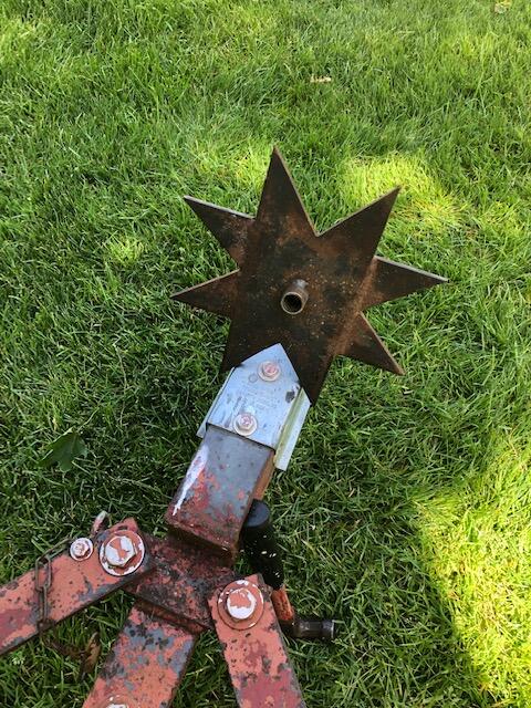

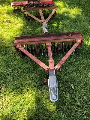

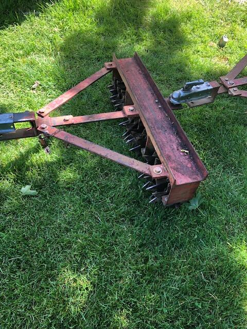

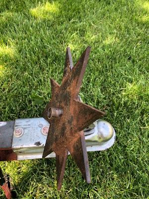

peter lena 10,013 #1 Posted June 5, 2022 just some info related to the spiker aerators , I had the dozer plow sitting on , to lubricate it . there are 2 aerators , same design , one is 28" wide across top of 6" channel steel , the other is 40" wide across 6" channel steel , cut welded 6"channel on it side to bottom of top channel , making a mount for pillow block flange bearings , to hold thru width axels , made up 10"x 4" spikers cut / welded from 4" x 3/8 thick flat bar steel , drilled hole for axel mount thru spikers . spikers just spin with movement , upper channel steel frame makes good spot to lay heavy chain for spiker soil penetration . been using these more than 30 years. often tandem them , have ball hitch front and back , makes for easy hook up , unweighted tow while cutting grass , breaks up thatch , weighted tow , not cutting grass for aeration , break up clay in lawn . feeds birds . working in a weld shop , with lots of metal scrap , this was a no brainer , bombproof , also did a stainless mailbox , about the same time , sch40 cement filled swing arm for suspended mail box , titanium swing mounts , lets it swing with impact , still there , back in the day , pete 3 4 Share this post Link to post Share on other sites

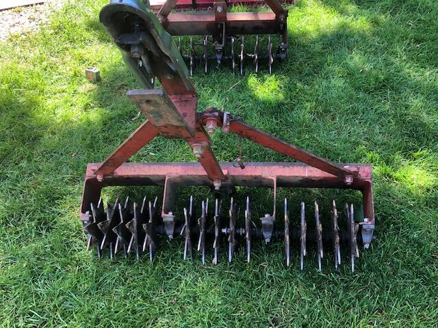

ranger 1,860 #4 Posted June 5, 2022 3 hours ago, Maxwell-8 said: Nicely done Pete Question, do Aerators work well? I have been thinking about buying one, but haven't seen a good use for one I have a couple. In the UK the general view is that they give up to a 30% increase in grass/hay yield in pastures, etc. Here is one of them. 2 1 Share this post Link to post Share on other sites

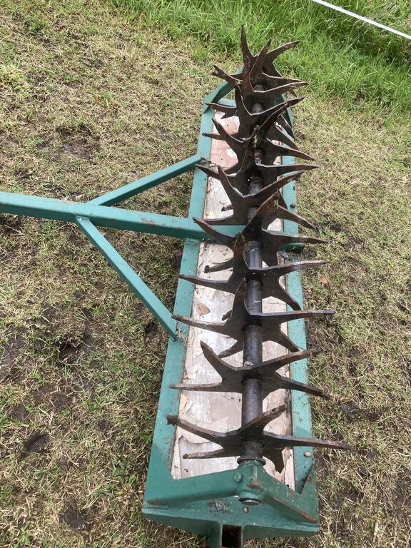

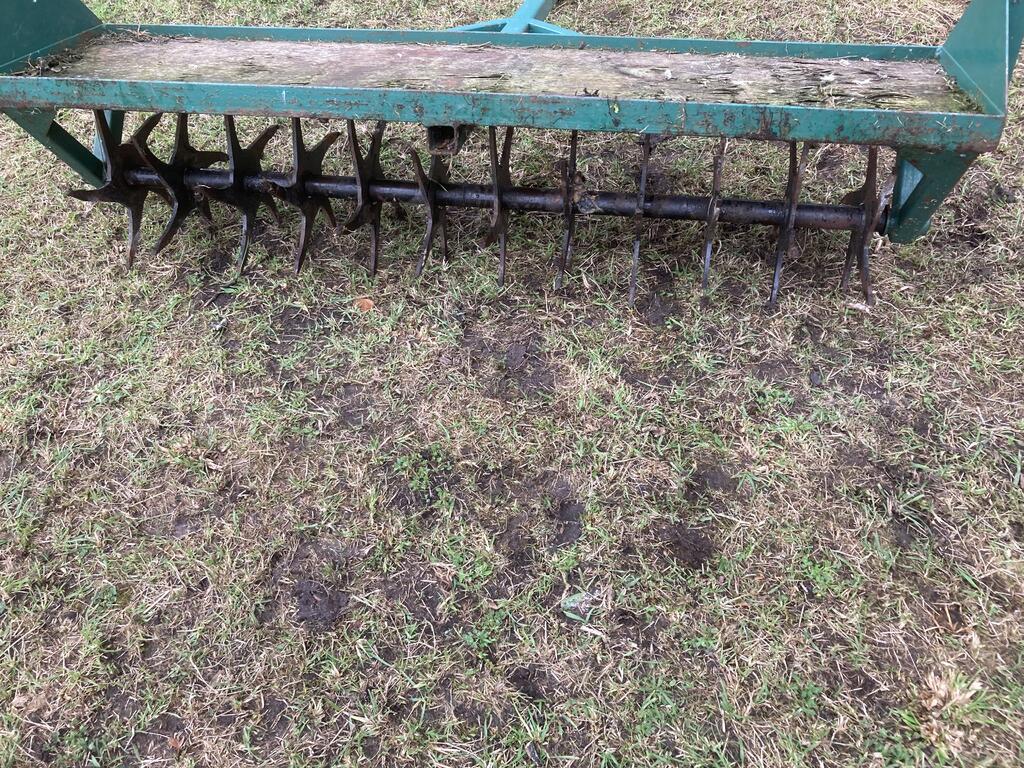

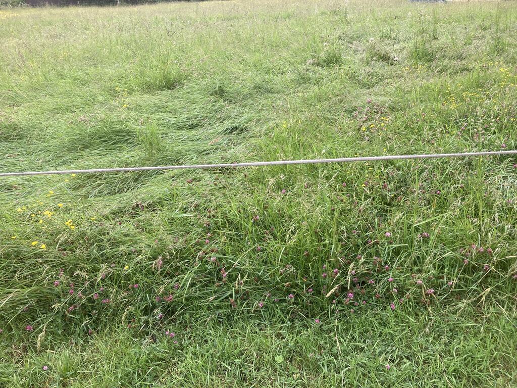

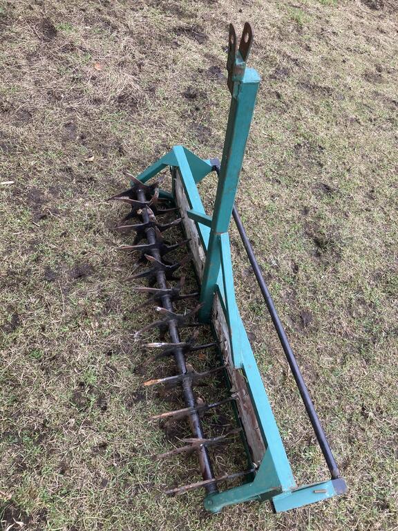

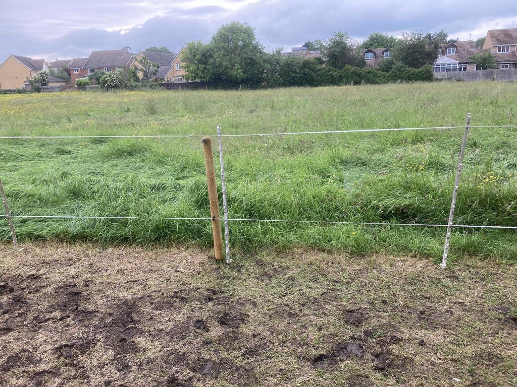

ranger 1,860 #11 Posted June 6, 2022 (edited) A couple of pics of my other aerator/spiker, not a heavyweight, 4ft wide, but has plenty of space to add weights. Also has depth control wheels, but not fitted at the moment. Included are a couple of pics of the hay paddock, torrential rain last night which flattened the grass, but not the buttercups. Doug. Edited June 6, 2022 by ranger 2 Share this post Link to post Share on other sites
peter lena 10,013 #12 Posted June 6, 2022 @ranger picked up some old heavy used chain at the local scrap yard , makes a perfect weight on that upper tray . you could add a few stand up bolts to trap some of the chain links , or some other tie down spot , simple easy weight for the lawn , thats a pretty aggressive looking set of spikers , is that a grease fitting 2nd photo , axel end mount point ? I use chassis grease on mine , spins very easily . rip it up , pete Share this post Link to post Share on other sites
ranger 1,860 #13 Posted June 6, 2022 @peter lena the spikes are in sections with grease nipples/zerks in each section. In the end is a cross bolt to retain the shaft. The spikes are part of a kit made by a company named schsupplies.co.uk, they make all kinds of kit for use behind garden tractors/quads, etc. You have a ‘tool carrier’ which accepts all kinds of things such as, spikes, splitters, rollers, de-thatchers, rakes, etc. all are mounted on the round bar, remove the bolt, pull out the bar, position the desired unit in place and re-insert the bar. I have the proper 48” tool carrier completer with a six row set of tines. These spikes are mounted on a homemade carrier, (not made by me), but are the correct ones for the other carrier. If you Google schsupplies.co.uk you can browse their catalog, all kinds of equipment, trailers, flail mowers, sprayers etc, nearly all suitable for lawn and garden tractors. Doug. Share this post Link to post Share on other sites

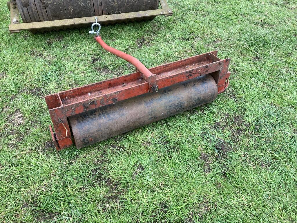

ranger 1,860 #15 Posted June 7, 2022 (edited) 11 hours ago, peter lena said: @ranger thanks for the insight , all this stuff has different manufactures , from different times and locations , like to take advantage of the old way of everything , with no failures built in . anytime I can modify or improve anything , and make it work easier and last longer too , I,M all in . pretty basic stuff , so a pillar block or flange bearing , along with good chassis grease , has just made it pretty bombproof . regularly tow my aerator , unweighted while cutting , since using them more often , my lawn overall , just looks better . Doug , thank you for the back an forth . enjoy it , pete @peter lena looking again at your aerators, they are very similar to my homemade flat roller, channel iron frame etc. The roll is an old gas bottle, bearings made from an old oak fence post, grease zerk in the bottom, (it always amazes me to see grease points located in the top of a plain bearing, whereby the weight has to be taken off the shaft before grease can be pumped in. Items such as rolls, etc). I also prefer the older, more ‘bulletproof’ designs of implements, especially things that only get used once or twice a year. And thank you, Pete, for your promotion of the benefits of regular preventive maintenance, having spent much of my working life repairing/replacing machinery damaged by lack of care on the part of the operator, (air filter pre-cleaners, oil /coolant levels, and of course, grease points) it’s refreshing to see someone pushing the issue home! It’s also through your recommendation I bought the Lucas grease. Keep up your good work, this is a case Where I feel the, ‘Slippery Slope’ leads to better things👍 Doug. Edited June 7, 2022 by ranger 1 1 Share this post Link to post Share on other sites
