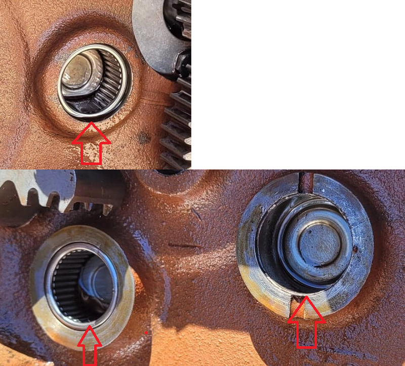

Maxwell-8 4,371 #81 Posted June 11, 2022 (edited) 43 minutes ago, Mike C160 said: 1) Left side inner axle bearing 1533 Partial failure / full on failure in progress. 2) Right side mushroom gear needle bearing. I have seen broken needle bearings destroy those ball bearings. Edited June 11, 2022 by Maxwell-8 2 Share this post Link to post Share on other sites

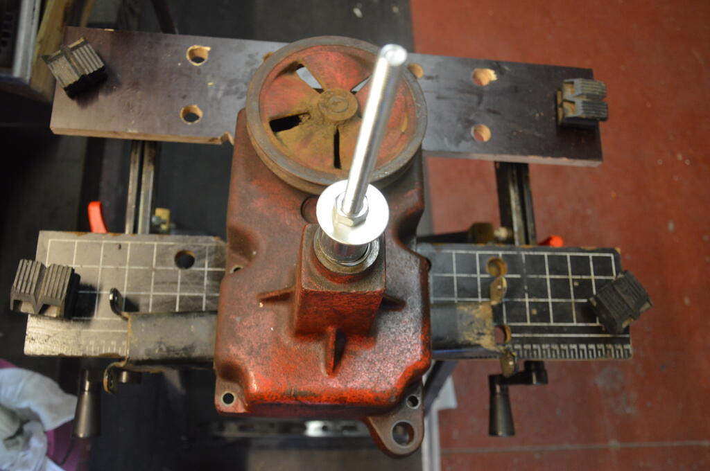

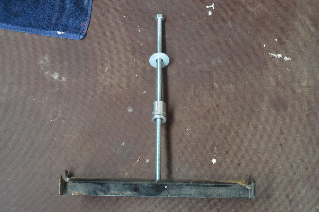

Mike C160 251 #91 Posted June 11, 2022 4 hours ago, Maxwell-8 said: Great point, also a good idea to drive in bearings Did you find you needed that jig to install the axle bearings? Cant just gingerly tap them into place?? Great home brew jig by the way. Cheers 1 1 Share this post Link to post Share on other sites
Maxwell-8 4,371 #92 Posted June 11, 2022 1 minute ago, Mike C160 said: Did you find you needed that jig to install the axle bearings? Cant just gingerly tap them into place?? Great home brew jig by the way. Thanks, You can, I have done a couple with success but I have also broken one by hammering it in. Had to go out order a new bearing and then made this jig. It insures a more strait install and protects the roller from locking. 1 Share this post Link to post Share on other sites
