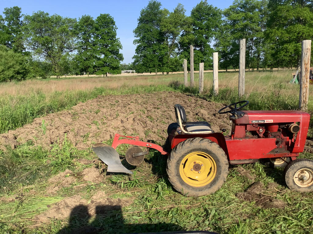

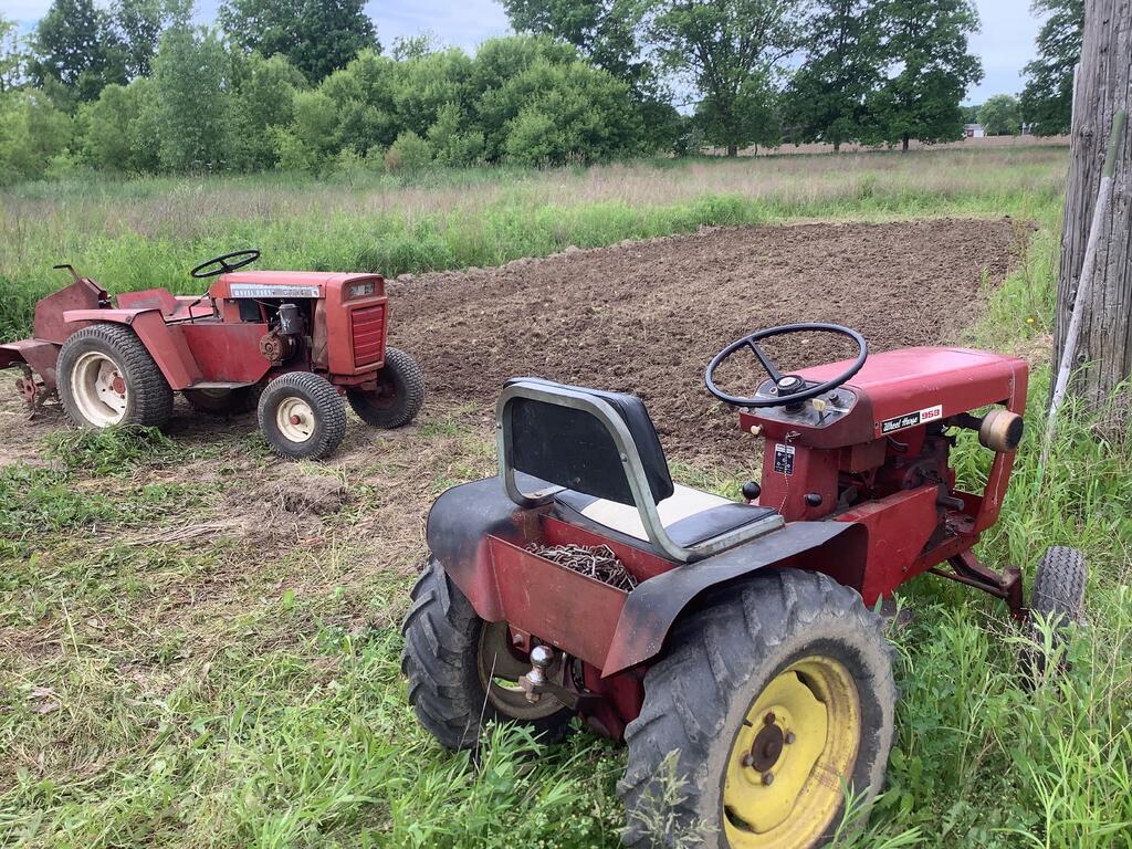

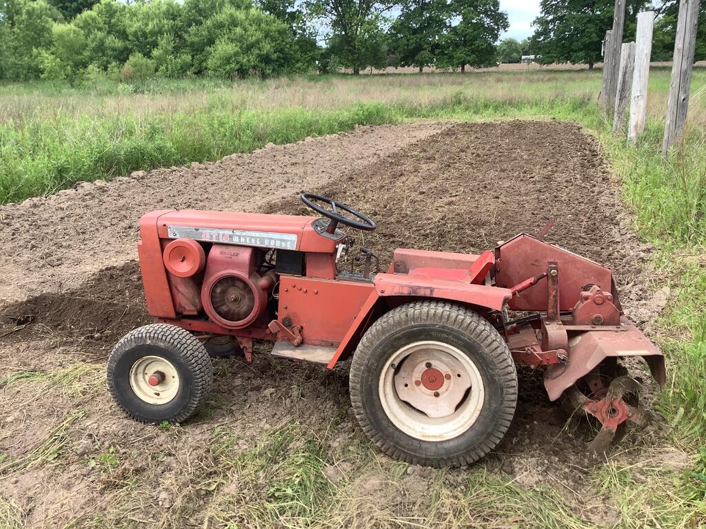

Pullstart 71,358 #32 Posted June 4, 2022 It’s pretty amazing what a ‘63 and ‘69 are still capable of! The surrounding weed growth is from 2 years of no garden plot. I dragged it a bit with the cultivator, plowed, disced, cultivated, then tilled. Probably could cultivate once more before sticking the ‘maters in! 3 1 Share this post Link to post Share on other sites
Pullstart 71,358 #33 Posted June 4, 2022 (edited) On the end of my first pass, my lower lift pin was in the way of the steering fan gear, so I couldn’t turn left. I need to swap the pins, the second one I made on the rear is much shorter. Edited June 4, 2022 by Pullstart 1 5 1 Share this post Link to post Share on other sites

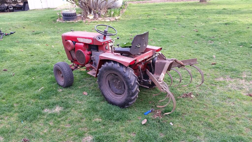

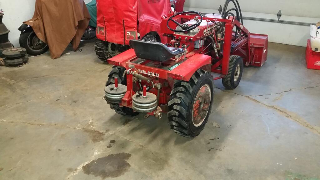

jeremi3210 759 #41 Posted June 5, 2022 Very nice! I've got 2 gt14's and would love find a tiller for one! Very strong and capable tractors. I made both my 3 points independent from my mid lift. I can mow lawn and move trailers with out even leaving my seat! 1 3 Share this post Link to post Share on other sites

jeremi3210 759 #44 Posted June 5, 2022 1 minute ago, Pullstart said: @jeremi3210 I’m guessing those ags are 953 wheels and tires? Mind sharing the details of the other ones? Yes the 6.70 15 ags were a set of 953 wheels I had picked up cheap! The others are skid steer wheels I mounted on gt14 rims. Ag tires are almost impossible to find in that size unless you run across some old ones. Can't remember the size off hand but they are correct for the tractor. 2 Share this post Link to post Share on other sites

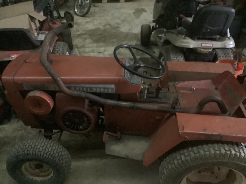

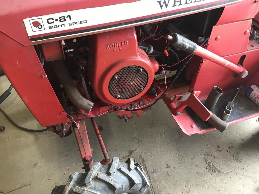

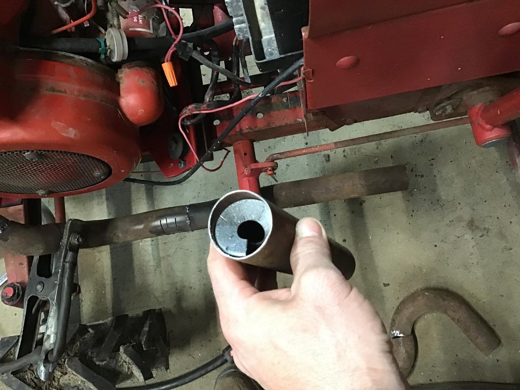

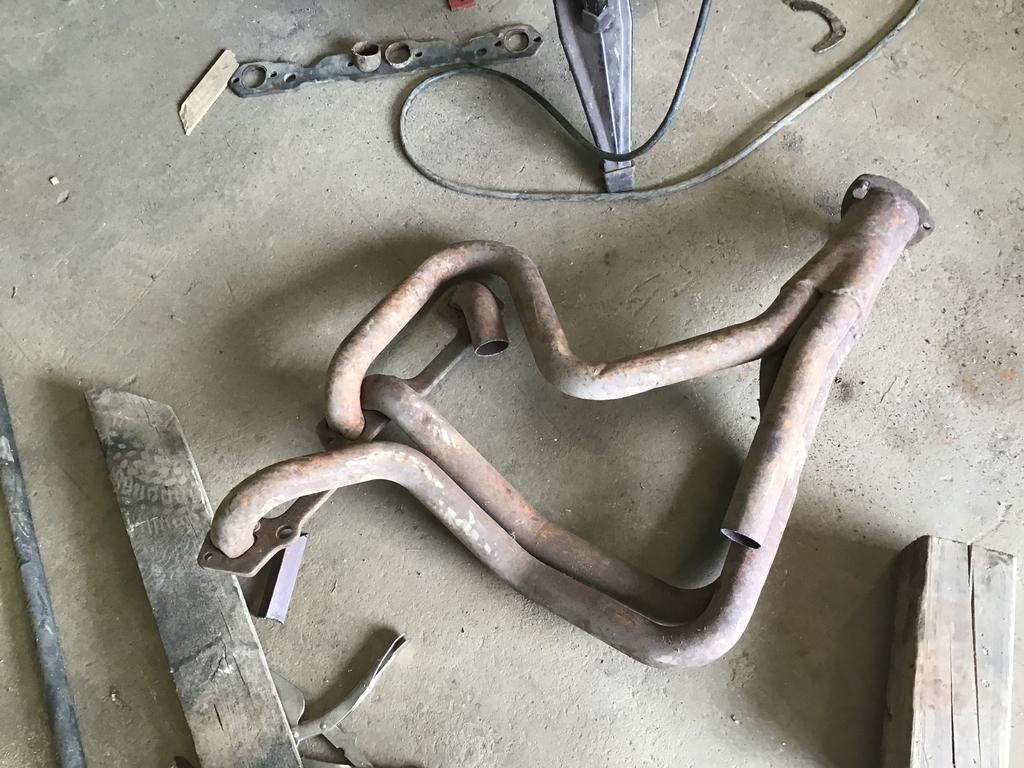

Pullstart 71,358 #47 Posted June 5, 2022 The girls visited me in the shop last night. When momma’s out of town, they do a pretty good job making sure I eat, drink, sleep, etc. We discussed Colt’s exhaust system. It sounds great but blows straight down… not my favorite. I think we (they) decided that we will for sure utilize “Steve”s old tailpipe. It might take a couple cuts and turns and welds, but it’s pretty much all there! Remember too that there is a home built muffler inside this pipe. 4 Share this post Link to post Share on other sites

jeremi3210 759 #49 Posted June 5, 2022 (edited) Them tires are 27 8.50 15 skid steer. I've found them at flea markets pretty cheap. Seem to get great traction Jacob was plowing with them on his 953 at Jim's last year and the year before with no problems! Edited June 6, 2022 by jeremi3210 1 Share this post Link to post Share on other sites
