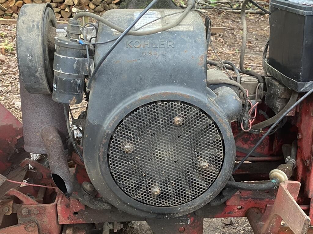

JerryLook 84 #1 Posted June 2, 2022 This things smokes like a chimney. When I first got the tractor I changed the oil. No oil came out for about 20 seconds, and then some silver goop plopped out, followed by the oil. I don’t know how long it had been since the oil was changed. It was pretty black. Also the tractor had sat for a while. Years The history of this engine is the previous owner bought it new in ‘81 (C-105 tractor). At some point he said he ran it out of oil and had the engine rebuilt. I don’t know what all that involved. Anyways now I have it. There is some wear on the cylinder wall but nothing crazy. Seems like all the oil it’s eating is keeping it well lubricated. Lol. Here’s a pic with the head off. Notice the puddle of oil. So without doing a complete rebuild, what are my options for getting this thing running better? A quick hone and new rings? The tractor is in poor shape. It runs and drives, but would be a lot of work to make nice again. I’d like to use it to haul a cart around. And maybe some other non-mower chores. I see my options as a cheap rebuild of this engine, or find something else to drop in it. Another used engine that runs better. 2 Share this post Link to post Share on other sites
OutdoorEnvy 1,817 #2 Posted June 2, 2022 That’s a lot of oil getting past the rings. Maybe a chance the rings are stuck or something and freeing them up or replacing might work. But if you take out the piston measure the bore to see if it’s in spec. If it’s not no rings will fix it. you could clean off the oil and do a compression test, maybe try soaking the piston and rings with marvel mystery oil to see if it is stuck rings and see if you get lucky Share this post Link to post Share on other sites
squonk 47,888 #3 Posted June 2, 2022 Anything less than tearing it all down and getting the bore measured with the proper tools is like pissing on a fan! 2 1 Share this post Link to post Share on other sites
JerryLook 84 #4 Posted June 2, 2022 Lol. Well I at least want to be behind the fan if I piss on it. I need to figure out the bore if I’m going to do rings anyways. I need to see if it was bored out and if so how much. Share this post Link to post Share on other sites
JerryLook 84 #5 Posted June 2, 2022 (edited) Let’s see if this video will upload. This is how she runs now. One of my dogs in the background trying to find where the chipmunk is hiding. Haha IMG_2160.MOV Edited June 2, 2022 by JerryLook Share this post Link to post Share on other sites
JerryLook 84 #6 Posted June 2, 2022 Also if I wanted to do an engine swap, what other engines will bolt up? Kohler K341, M10, M12? Anything else? And I know these engines are available in other brands of equipment. But I’m wondering if they’re different in some way and can’t be used in a WH. I’d definitely like to try and fix this one first, but if it’s going to be a complete overhaul, I’ll probably look for another engine for it. I definitely can’t use it this way. Although it does help with the mosquitos. Share this post Link to post Share on other sites

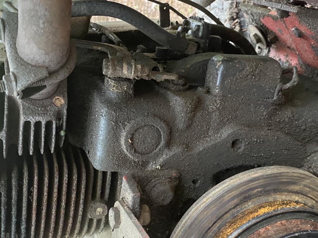

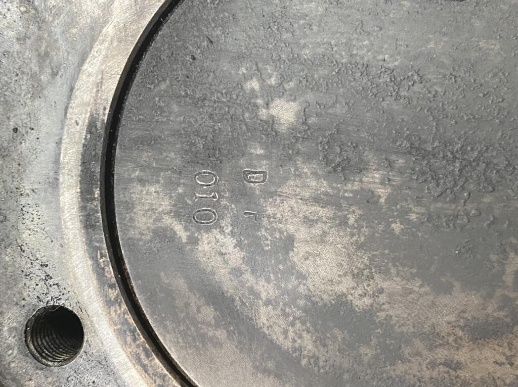

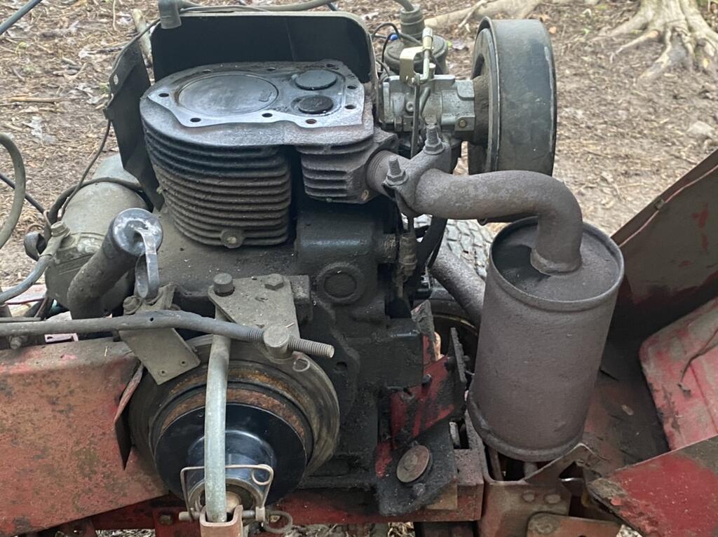

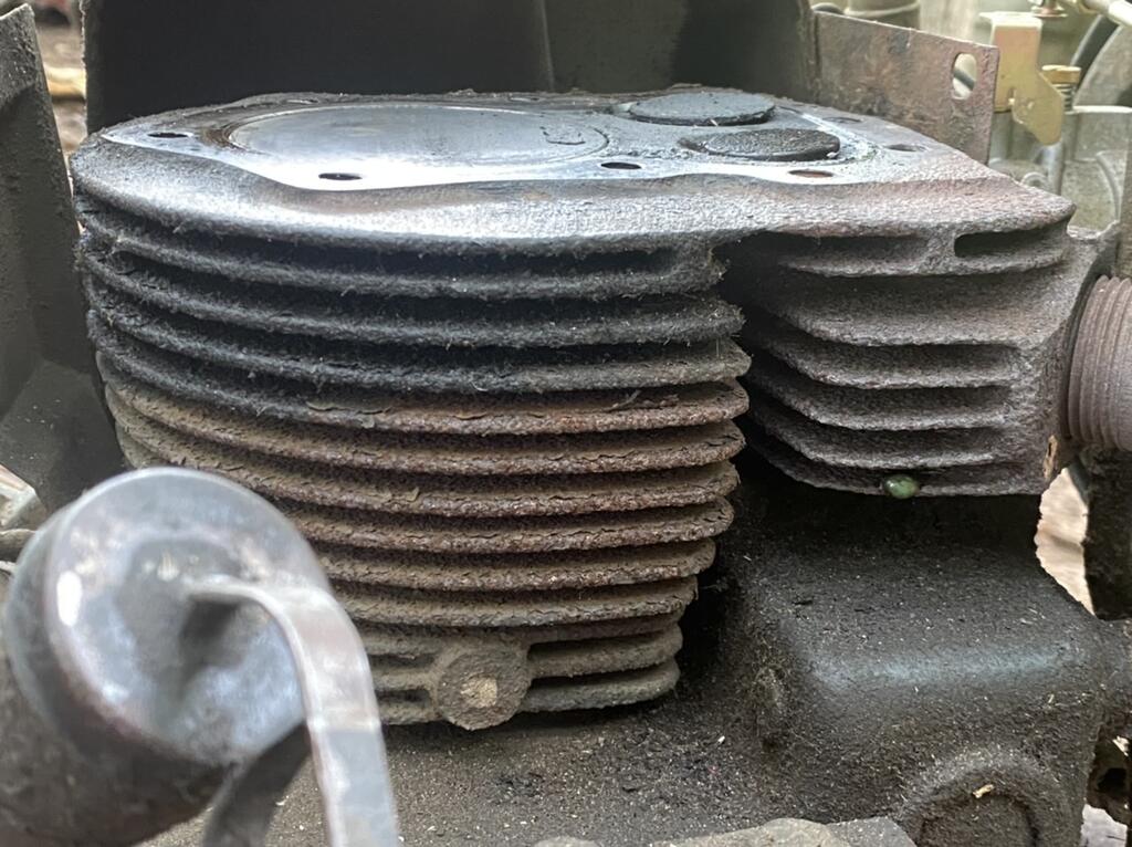

tunahead72 2,645 #7 Posted June 2, 2022 30 minutes ago, JerryLook said: ... I need to figure out the bore if I’m going to do rings anyways. I need to see if it was bored out and if so how much. You can get a clue by cleaning off the top of the piston and looking for markings there. 24 minutes ago, JerryLook said: ... This is how she runs now... IMG_2160.MOV 6.86 MB · 1 download Does that smoke ever stop, or does it just keep smoking like that while it's running? Also, what's that dark area on the lower front section of the blower housing? If that's oily, you might also have a leak. Share this post Link to post Share on other sites
tunahead72 2,645 #8 Posted June 2, 2022 (edited) 19 minutes ago, JerryLook said: ... if it’s going to be a complete overhaul, I’ll probably look for another engine for it... There's a couple of members in Virginia who rebuild these Kohlers on a regular basis, at a reasonable cost and from what I understand very high quality. I wouldn't hesitate to start a serious conversation with either of them if I wanted a new engine: @richmondred01 @oldredrider ---------------- Edit: I should have added... There's a ton of other guys on this forum who are fully capable of rebuilding these engines (I am not one of them ). I didn't mean to exclude anyone. Edited June 2, 2022 by tunahead72 4 Share this post Link to post Share on other sites

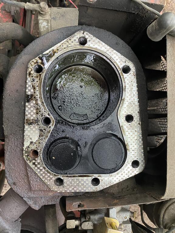

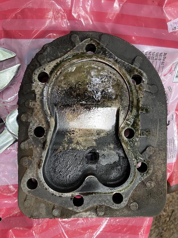

JerryLook 84 #9 Posted June 2, 2022 You’re exactly right about the piston. There is 010 on top, so she is bored out a little. How tight should the piston be in the bore at TDC? I can wiggle it around a bit. Both side to side and front to back. Yes the motor has a few leaks. Honestly it’s so cruddy it’s hard to see exactly where the oil is coming from. On the RH side of the engine there is some oil on the fins. And some green goop in front of that. I read somewhere that means there’s a crack there somewhere. Unless it’s getting past the head gasket and running down the side. That’s always an option too. There just so much oil getting pushed up. 1 Share this post Link to post Share on other sites
JerryLook 84 #10 Posted June 2, 2022 Oh and to answer your other question, it smokes like that all the time. 1 Share this post Link to post Share on other sites
Handy Don 17,316 #11 Posted June 2, 2022 Yikes. Pistons should have no wiggle. My guess is that it was run out of oil again after the rebuild. I'd want to know the full extent of any issues (cracks, excess internal wear/damage) before I considered investing more than a couple hours or any money. 1 Share this post Link to post Share on other sites
richmondred01 2,388 #12 Posted June 2, 2022 35 minutes ago, tunahead72 said: There's a couple of members in Virginia who rebuild these Kohlers on a regular basis, at a reasonable cost and from what I understand very high quality. I wouldn't hesitate to start a serious conversation with either of them if I wanted a new engine: @richmondred01 @oldredrider ---------------- Edit: I should have added... There's a ton of other guys on this forum who are fully capable of rebuilding these engines (I am not one of them ). I didn't mean to exclude anyone. Yep I can do it. turnaround time right now 7-10 days. 2 Share this post Link to post Share on other sites
953 nut 68,519 #13 Posted June 2, 2022 36 minutes ago, JerryLook said: How tight should the piston be in the bore at TDC? I can wiggle it around a bit. Both side to side and front to back. 2 hours ago, JerryLook said: I see my options as a cheap rebuild of this engine, or find something else to drop in it. You'll get what you pay for! You could consider one of the predator engines from Harbor Freight since you won't be doing any hard work with it. Any movement like that is too much. A new set of rings will not do any good with a cylinder that is that bad. Considering the condition of the oil as you described it in your first post tells me the crank shaft may need to be turned also. Contact as many engine machine shops as you can to get an estimated cost for cylinder boring and crank shaft turning. If you are not able to disassemble and reassemble the engine properly yourself the cost will go up considerably. Share this post Link to post Share on other sites
squonk 47,888 #14 Posted June 2, 2022 If I was to spend money on that engine, I would spend enough to get it rebuilt the right way instead of throwing a set of rings in it and flushing money down the toilet. That cylinder's gotta be worn along with the valve guides. 3 Share this post Link to post Share on other sites

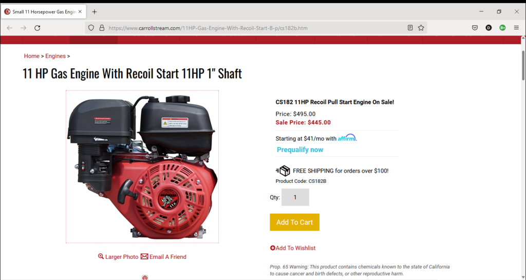

Snoopy11 5,731 #15 Posted June 2, 2022 22 minutes ago, squonk said: That cylinder's gotta be worn along with the valve guides Wouldn't surprise me for the cylinder to be a cone shape... in this case. I'd personally do the... "easy" thing and invest in an equivalent Carrol Stream Engine... https://www.carrollstream.com/11HP-Gas-Engine-With-Recoil-Start-B-p/cs182b.htm Don Share this post Link to post Share on other sites
Jeff-C175 7,211 #16 Posted June 2, 2022 2 hours ago, Snoopy11 said: Carrol Stream Engine Do they have a thrust bearing on the crank for use with WH PTO ? 1 Share this post Link to post Share on other sites
Snoopy11 5,731 #17 Posted June 2, 2022 1 hour ago, Jeff-C175 said: Do they have a thrust bearing on the crank for use with WH PTO ? Indeed they do. I recommended it to @chipwitch many moons ago for that very reason. Don 1 Share this post Link to post Share on other sites

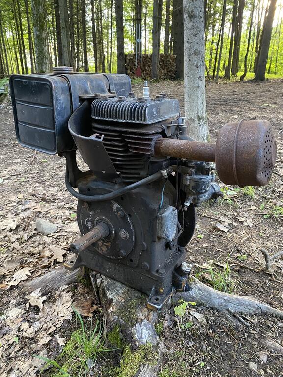

JerryLook 84 #19 Posted June 2, 2022 I have this engine that came off a home made wood splitter. I was always told it was a Tecumseh, but it looks similar to my my K241. I’m not a small engine guy and can’t ID it. Is this a Kohler? For what I’d be using it for I guess I’d be willing to be without the PTO pulley on this mower. Share this post Link to post Share on other sites
Bill D 3,101 #20 Posted June 2, 2022 6 minutes ago, JerryLook said: I have this engine that came off a home made wood splitter. I was always told it was a Tecumseh, but it looks similar to my my K241. I’m not a small engine guy and can’t ID it. Is this a Kohler? For what I’d be using it for I guess I’d be willing to be without the PTO pulley on this mower. That is a Briggs and Stratton iron block. Good engine. Not sure how difficult it would be to fit into a Wheel Horse. How many HP? Share this post Link to post Share on other sites
JerryLook 84 #21 Posted June 2, 2022 (edited) I was told it is 11hp, but I’d like to find the numbers stamped on it and verify for sure. Actually after doing some research I think it’s a 9hp model 23. Edited June 3, 2022 by JerryLook Share this post Link to post Share on other sites
Tuneup 1,459 #22 Posted June 3, 2022 Well, the good news is that, as you said, you're going to use it to haul this an that around, no thrust bearing required. I expect that the B&S will be fine. If using the PTO, no. Share this post Link to post Share on other sites
