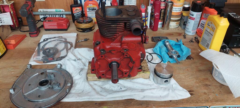

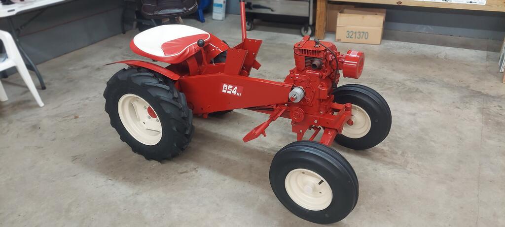

dmoore 1,024 #59 Posted July 11, 2022 Been busy on other projects and keeping my county cool. I have managed to install just about all parts bought from Brian @ K & B Horse Parts. It's been a roller since last week thanks to Miller Tires in Ohio. I will need to source an upper steering shaft bronze bushing since mine is worn. The engine has been disassembled, cleaned, inspected, two new crankshaft seals, honed & ready for new piston/rod assy installation. It is in very good condition with all measurements well within spec. Hoping to have the engine mounted and running by next weekend. 2 7 Share this post Link to post Share on other sites

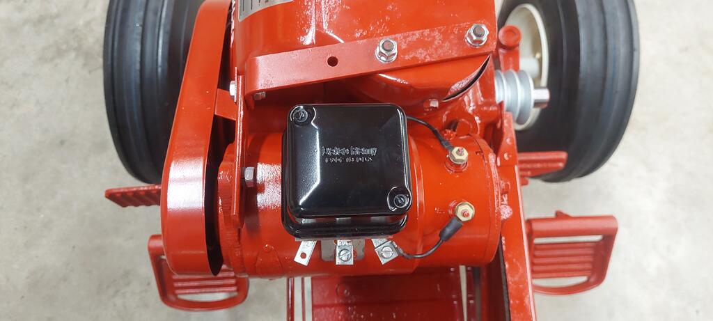

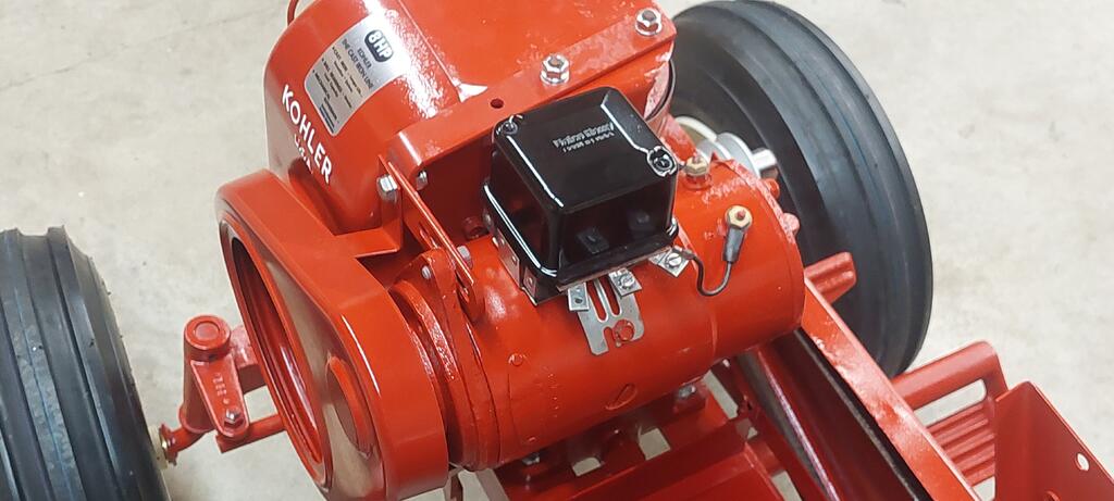

Handy Don 16,062 #61 Posted July 17, 2022 Looks terrific! Before you get too far on assembly, though, you may want to pause and think about electrical grounds with all those freshly painted components! Regulator to S/G body. S/G to engine block. Battery negative to engine block. Coil ground wire to engine block. When I assembled my nicely painted K181, I carefully scraped off the paint at key spots and used dielectric grease on the joints. Tested with a continuity buzzer and VOM to be sure they were really solid. Did the same for all the "+12v" connections as I went--especially to the ignition switch and ammeter. 6 1 Share this post Link to post Share on other sites

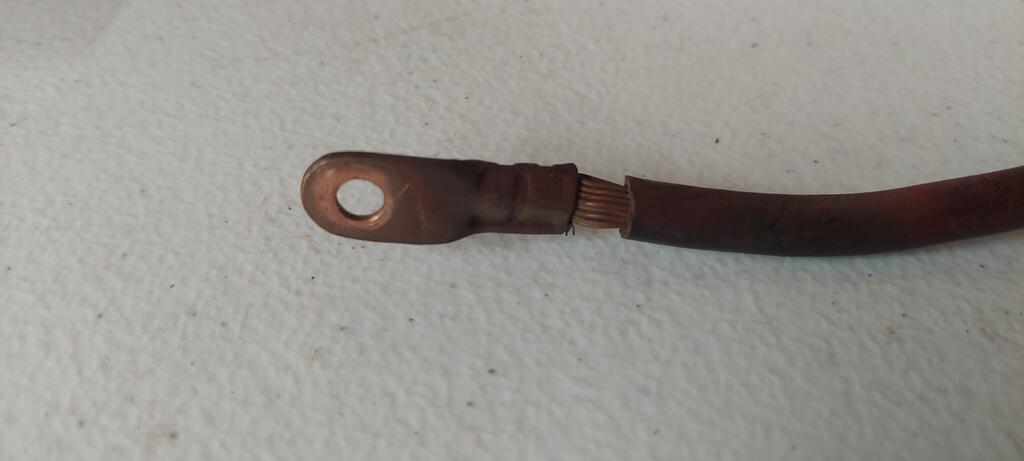

dmoore 1,024 #62 Posted July 24, 2022 So in attempting to wire up this tractor I have been looking for the copper lugs, #6 with the smaller hole for the key switch and the voltage regulator terminals. Anyone know who may have them? Share this post Link to post Share on other sites
JPWH 6,544 #63 Posted July 25, 2022 (edited) Search 1/4" wire ring terminals at soundextreme1902 on flea bay. Edited July 25, 2022 by JPWH 1 Share this post Link to post Share on other sites
dmoore 1,024 #64 Posted July 25, 2022 Thanks JP will do 1 Share this post Link to post Share on other sites
ineedanother 1,973 #65 Posted July 26, 2022 I just used some of these on my boat with some heat shrink. Good quality. https://www.amazon.com/Ga-Stud-Copper-Lugs-Pack/dp/B00O7S7INS 2 Share this post Link to post Share on other sites
dmoore 1,024 #66 Posted July 26, 2022 I actually found them at my NAPA. I guess I just overlooked them. Thanks guy's! 2 Share this post Link to post Share on other sites

peter lena 9,797 #74 Posted August 4, 2022 @dmoore like the overall look of that opportunity , while I can relate to others on electrical lugs , the industrial grade of lugs is very stout , at your frame state , base line ground your battery ground bolt down spot to your engine / frame area , paint free , dielectric grease and serrated washers . @Handy Don ,agrees that is your verified ground go to point. since doing that , my electrical issues are gone. would also detail set up all related linkages , added washers and grease , for solid smooth action . would personally add a few well tried upgrades , while you are there, like fuel check valve , lift lever lubrication , washering , would also cable/wire wrap , wiring , etc . looks very good . should work out well for you , pete 1 Share this post Link to post Share on other sites
