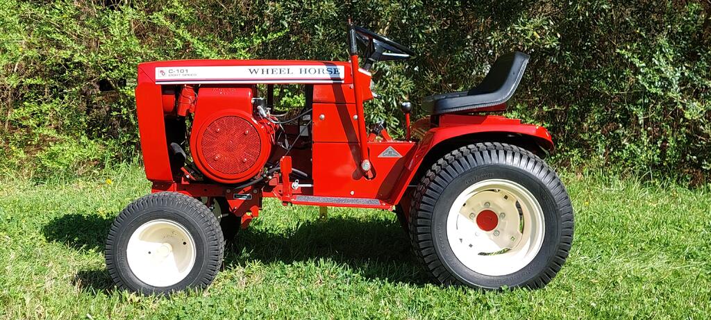

dmoore 1,040 #26 Posted June 3, 2022 Besides, I have my C-101 8 - speed should the need arise 4 Share this post Link to post Share on other sites
Handy Don 17,212 #28 Posted June 3, 2022 12 hours ago, dmoore said: Besides, I have my C-101 8 - speed should the need arise Handy to have options! 1 Share this post Link to post Share on other sites

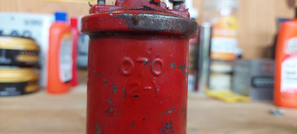

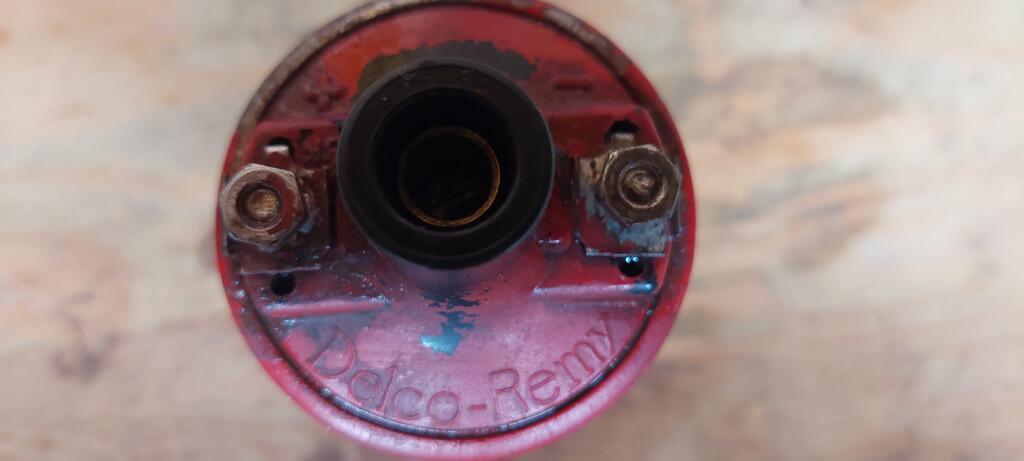

dmoore 1,040 #29 Posted June 4, 2022 okay gurus can anyone decipher the year of this coil? Delco Remy 070 12V Share this post Link to post Share on other sites
Handy Don 17,212 #31 Posted June 5, 2022 3 hours ago, dmoore said: 3 hours ago, dmoore said: okay gurus can anyone decipher the year of this coil? Delco Remy 070 12V Pretty sure that is model info, not a date code. Share this post Link to post Share on other sites
dmoore 1,040 #32 Posted June 5, 2022 Yes I figured that. Have not found a date code as of yet, if in fact there is one. Maybe after some cleanup. Share this post Link to post Share on other sites
Handy Don 17,212 #33 Posted June 5, 2022 Just now, dmoore said: Yes I figured that. Have not found a date code as of yet, if in fact there is one. Maybe after some cleanup. Nope. I just cleaned and repainted mine. I can't think of a reason Delco-Remy would bother dating a coil. These aren't a maintenance item and their function really doesn't degrade on any set schedule that preemptive replacement would justify. Share this post Link to post Share on other sites
dmoore 1,040 #34 Posted June 5, 2022 I can count on two fingers how many bad coils I've encountered in my lifetime. This one could very well be original. 3 Share this post Link to post Share on other sites
rjg854 13,274 #35 Posted June 5, 2022 I was going to say, painted red like it was, that it was probably original to the tractor. If it had been replaced it would have been maybe black. 2 Share this post Link to post Share on other sites
squonk 47,789 #36 Posted June 5, 2022 11 hours ago, dmoore said: I can count on two fingers how many bad coils I've encountered in my lifetime. This one could very well be original. When I was in the parts store I built a coil tester. We had so many people coming in with ignition parts in their hand. We had a module tester but no coil tester. so a chunk of cedar from an old picnic table, spark tester, a points distributor and part of a west coast mirror from a 74 Chevy PU and some wire and BOOM Coil tester! Probably tested over a hundred of them, found 1 bad one. 3 Share this post Link to post Share on other sites
c-series don 12,313 #37 Posted June 5, 2022 (edited) @squonk @dmooreNot to change the subject but, in high school shop class we had what I think was a coil tester?(it was a long time ago, I can’t remember exactly!) We would put it in a metal cabinet under a metal bench and wait for someone to come lean on it and whammo! They would get the shock of a lifetime 😂😂 I remember one student got crafty and brazed together some brazing rods, laid them on the floor. Then pinched them between the floor and the metal tables so all the tables were linked together. Everyone was getting shocked! Even the shop teacher found this amusing and I don’t think he did much to stop it. He was awesome! Ahh the good ole days! Edited June 5, 2022 by c-series don 2 4 1 Share this post Link to post Share on other sites
squonk 47,789 #38 Posted June 5, 2022 12 minutes ago, c-series don said: @squonk @dmooreNot to change the subject but, in high school shop class we had what I think was a coil tester?(it was a long time ago, I can’t remember exactly!) We would put it in a metal cabinet under a metal bench and wait for someone to come lean on it and whammo! They would get the shock of a lifetime 😂😂 I remember one student got crafty and brazed together some brazing rods, laid them on the floor. Then pinched them between the floor and the metal tables so all the tables were linked together. Everyone was getting shocked! Even the shop teacher found this amusing and I don’t think he did much to stop it. He was awesome! Ahh the good ole days! We had an all metal bench in school. During my junior in electric shop year we connected a 10,000 volt transformer to it and threw a bunch of tools on top. When the senior boys came in early for their auto shop class the teacher told them to put the tools away. Multiple whammo's 1 4 Share this post Link to post Share on other sites
SylvanLakeWH 32,020 #39 Posted June 5, 2022 @c-series don and @squonk great stories!!! My how things change… Sadly, today you’d both be expelled and put on NSA’s watch list… 4 Share this post Link to post Share on other sites
J854D 145 #40 Posted June 6, 2022 @dmoore that certainly is an original coil! I’ve got a couple just like it myself. The 070 is the last 3 digits of the Delco-Remy part number for that coil. The complete part number is 1115070. (long since obsolete) The 12V is of course 12 volts. That coil has an internal resister built into it to keep the points from burning up. NAPA #IC14 would be an aftermarket replacement. -JD- 3 1 Share this post Link to post Share on other sites
dmoore 1,040 #41 Posted June 6, 2022 I thought so. The external resistor that was present had me guessing. So I guess someone installed it not knowing that the original had it internally? Share this post Link to post Share on other sites
J854D 145 #42 Posted June 7, 2022 I’ll bet you are right about a previous owner installing an external resistor on your 854. My 854 coil is wired straight from the ignition switch. -JD- Share this post Link to post Share on other sites
Handy Don 17,212 #43 Posted June 7, 2022 1 hour ago, J854D said: My 854 coil is wired straight from the ignition switch As is mine. Share this post Link to post Share on other sites
dmoore 1,040 #44 Posted June 7, 2022 A condenser which protects the points is still needed no? Share this post Link to post Share on other sites
J854D 145 #45 Posted June 7, 2022 The condenser reduces the arcing across the points as they open. In 12 volt ignition systems the resistor (internal or external) reduces the voltage to the points to around 9 volts so they don’t overheat. The 6 volt ignition systems in old cars, trucks, & tractors used condensers but didn’t require resistors. -JD- Share this post Link to post Share on other sites
Handy Don 17,212 #46 Posted June 7, 2022 11 hours ago, dmoore said: A condenser which protects the points is still needed no? Yes. Do you have the wiring diagram? The condenser is shown. Share this post Link to post Share on other sites

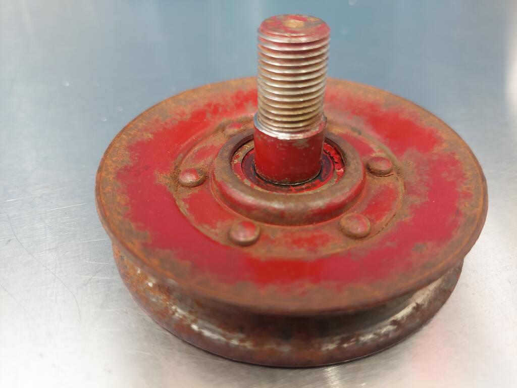

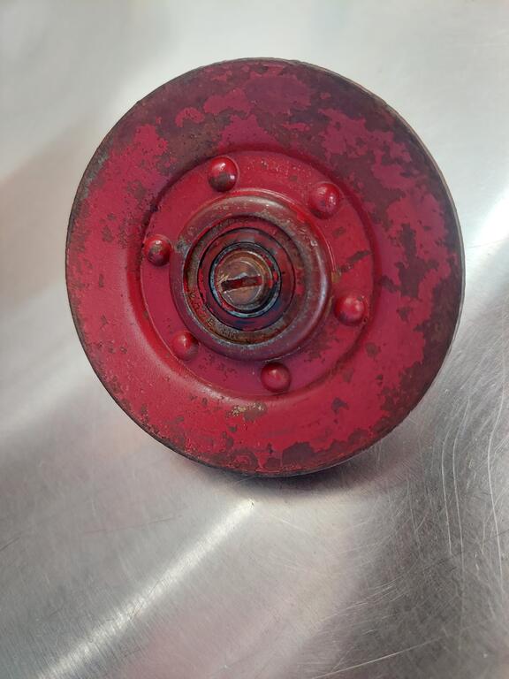

dmoore 1,040 #48 Posted June 7, 2022 This is my drive belt idler pulley. Is the stud supposed to be removable from pulley or is it a complete assy? The pulley bearing is a little rough and I will need another. Share this post Link to post Share on other sites
buckrancher 2,697 #50 Posted June 8, 2022 14 hours ago, dmoore said: This is my drive belt idler pulley. Is the stud supposed to be removable from pulley or is it a complete assy? The pulley bearing is a little rough and I will need another. it's a complete assembly Share this post Link to post Share on other sites
