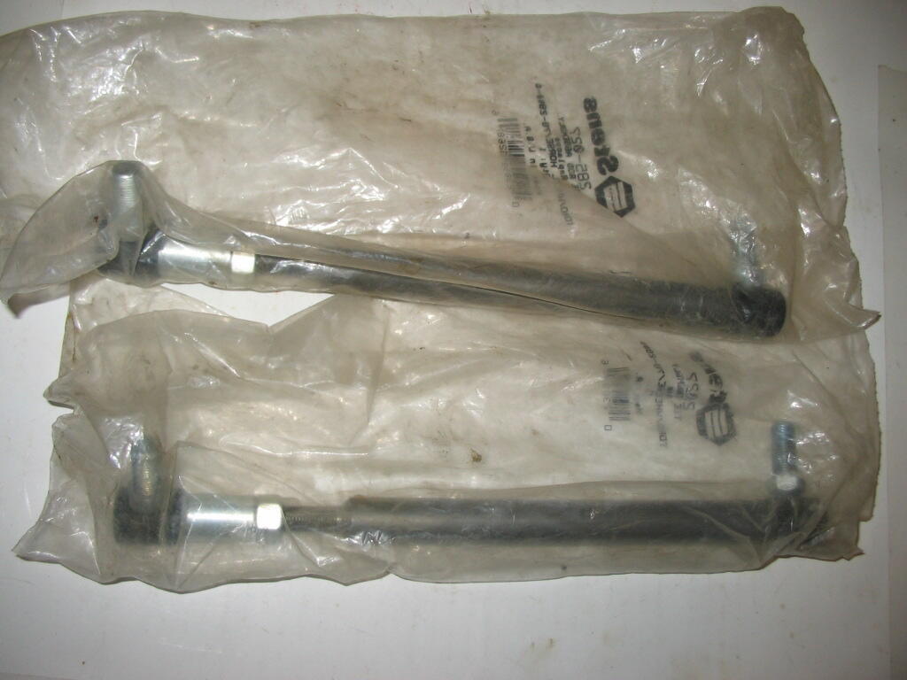

daveoman1966 3,883 #8 Posted May 31, 2022 I have two NEW replacement tie rods...adjustable.... on Ebay from Stens item 285-027. These have the RUBBER 'SHIELD' on each end to keep grease in and water out. These are just as heavy-duty as the Wheelhorse originals. Ebay item # 134124294069 4 Share this post Link to post Share on other sites
