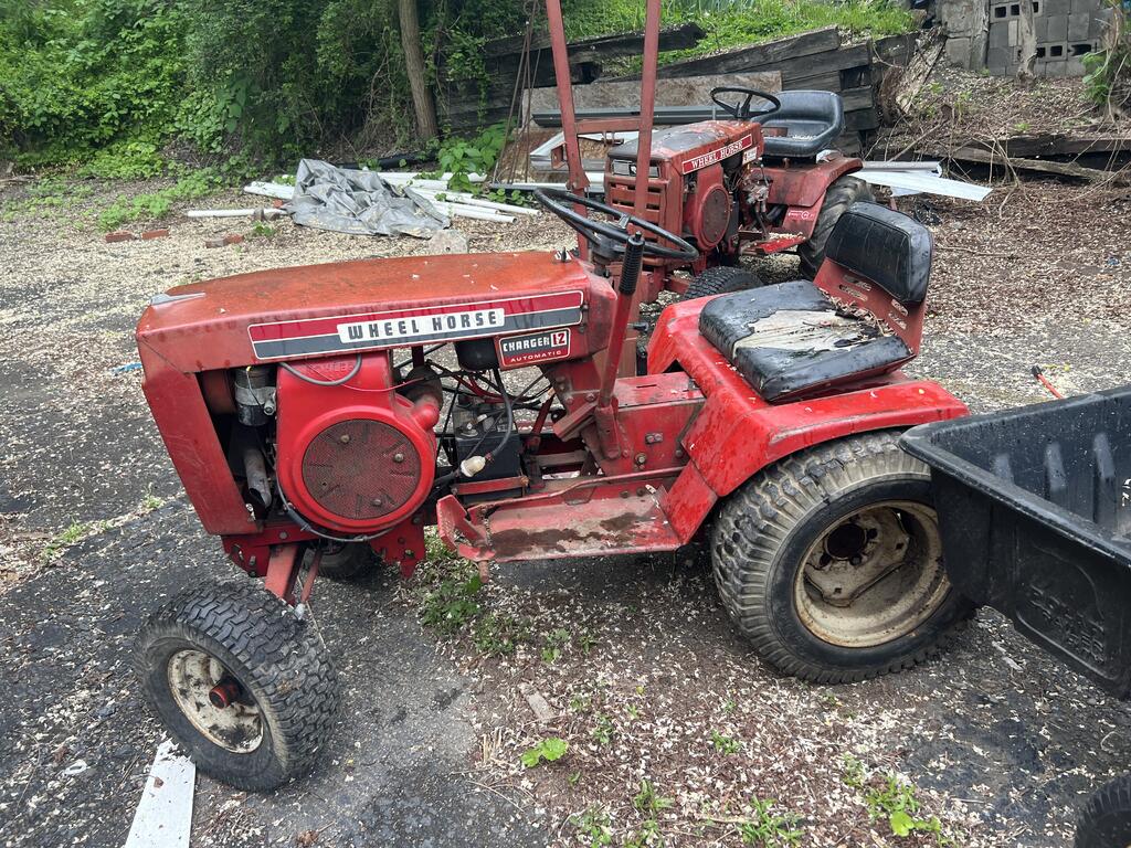

Looking for a deck for my gramps charger 12. We used to sell tractors in New Castle, and this is what I have left from that.

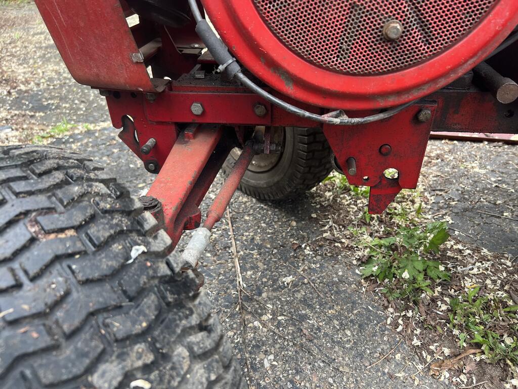

I have the feeling he modified it, fits a mule drive in front and attachomatic center.
Also I screwed up a few years ago on a few things I hope you can help with. We had to reset points, but unsure of what they are supposed for be at for cast iron Kohler 12.
I believe I also removed a bolt that keeps the parking lock/belt in tension on it. I’ll attempt to attach files.
thanks a lot, first posting, but have used info from here before.

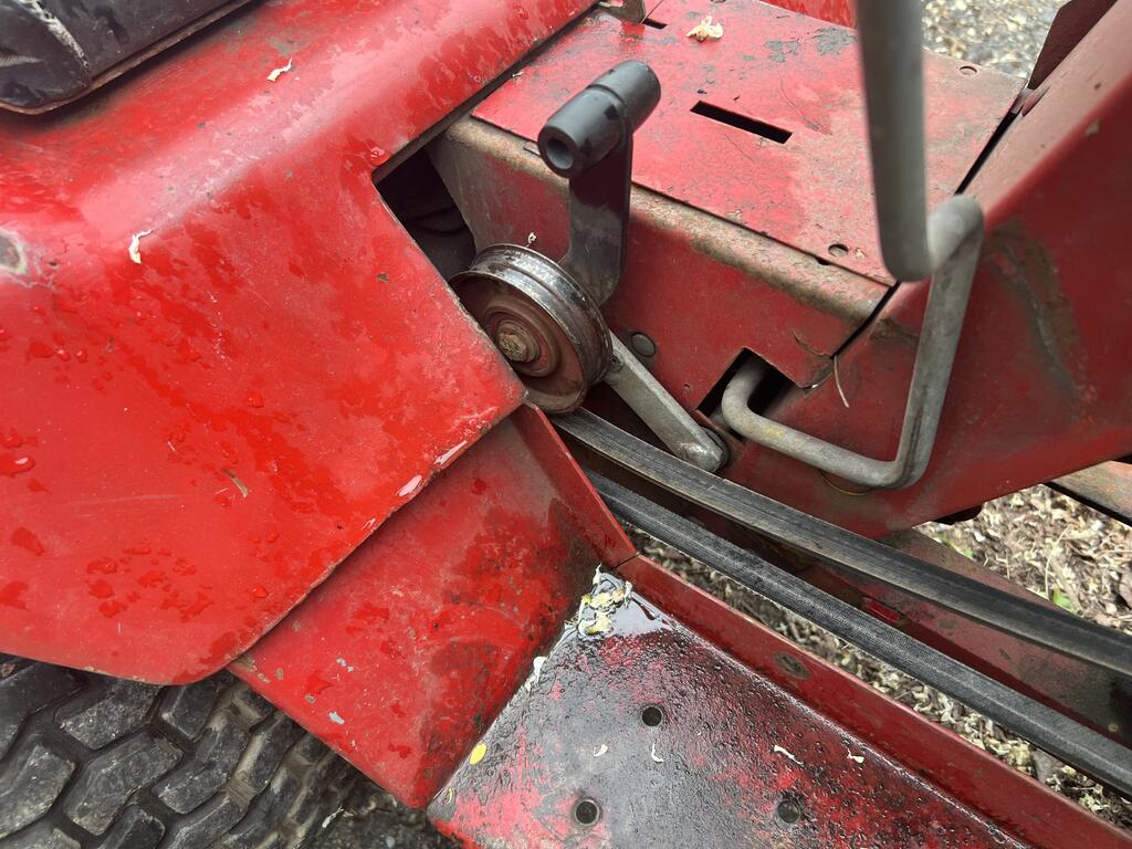

Perfect thank you. I’m not sooo young haha about 40, but finally in my forever home and trying to use what I recognize as the top of the top. I’ll try the classified. Any tips for how to show the lever for hydro engage so I can get that sorted?

Do you have the belt cover for it? The belt cover has guides on it for the belt, it keeps the slack out of the belt when disengaged, it wont work right without it... I would take the belt cover off that awesome (what I'm guessing is a C-160) one in the background, they should be the same setup, compare & see what's missing on the Charger....Make sure the belt goes back on top of the guides otherwise they will shred it.

@Fombelles  noticing  that flat idler pulley on your drive belt set up , looks like rare wide side grease shields on that pulley , could be a good opportunity  , to carefully pocket screwdriver off those 2 side shields , clean out existing grease , carb clean flush out , repack with lucas _ xtra heavy duty chassis grease , push seals back in place , super quiet , reliable. just a thought , pete
