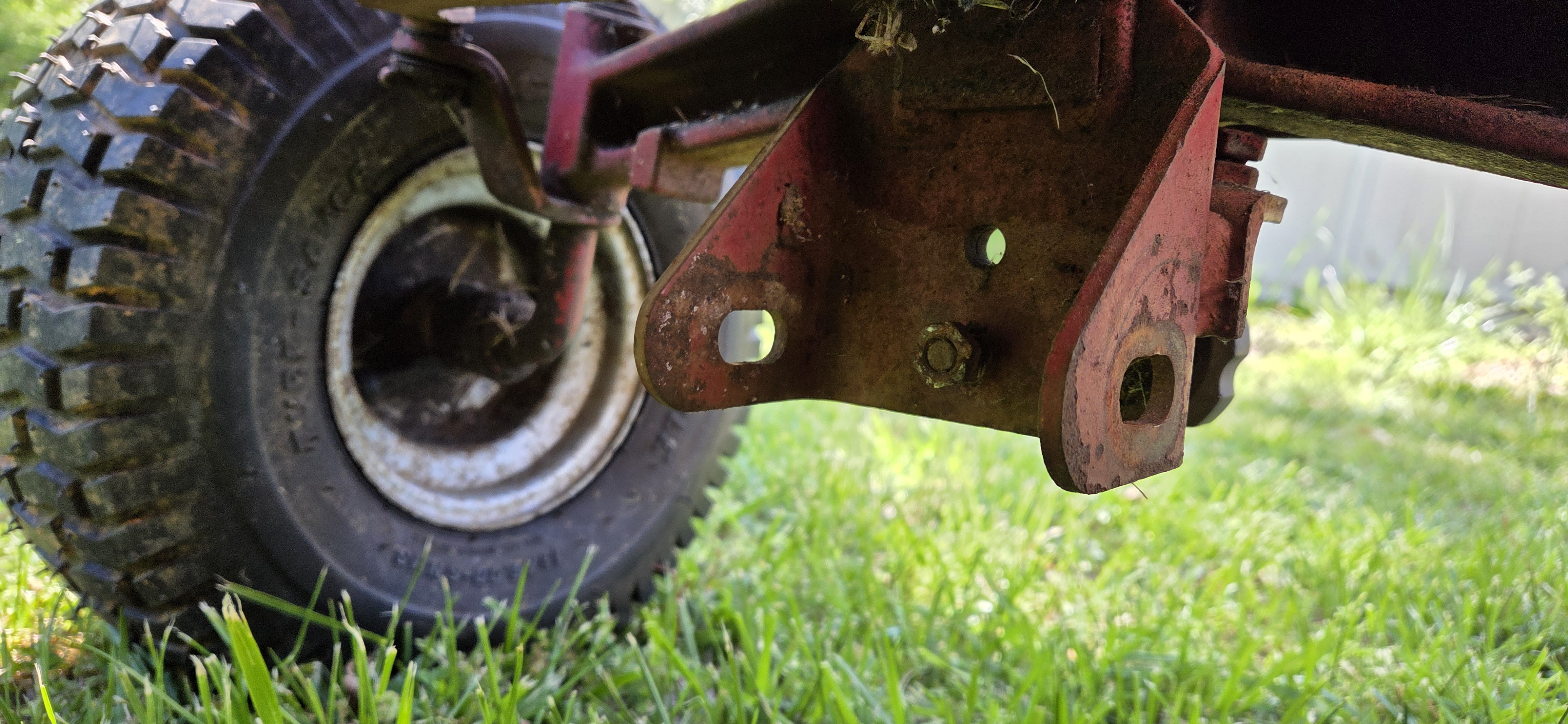

Maybe you all could help me figure something out. I don't think I am installing the mower deck properly on my 1989 252-H and I don't know if the PTO clutch is adjusted right.

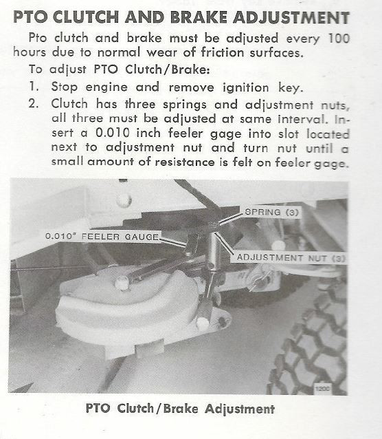

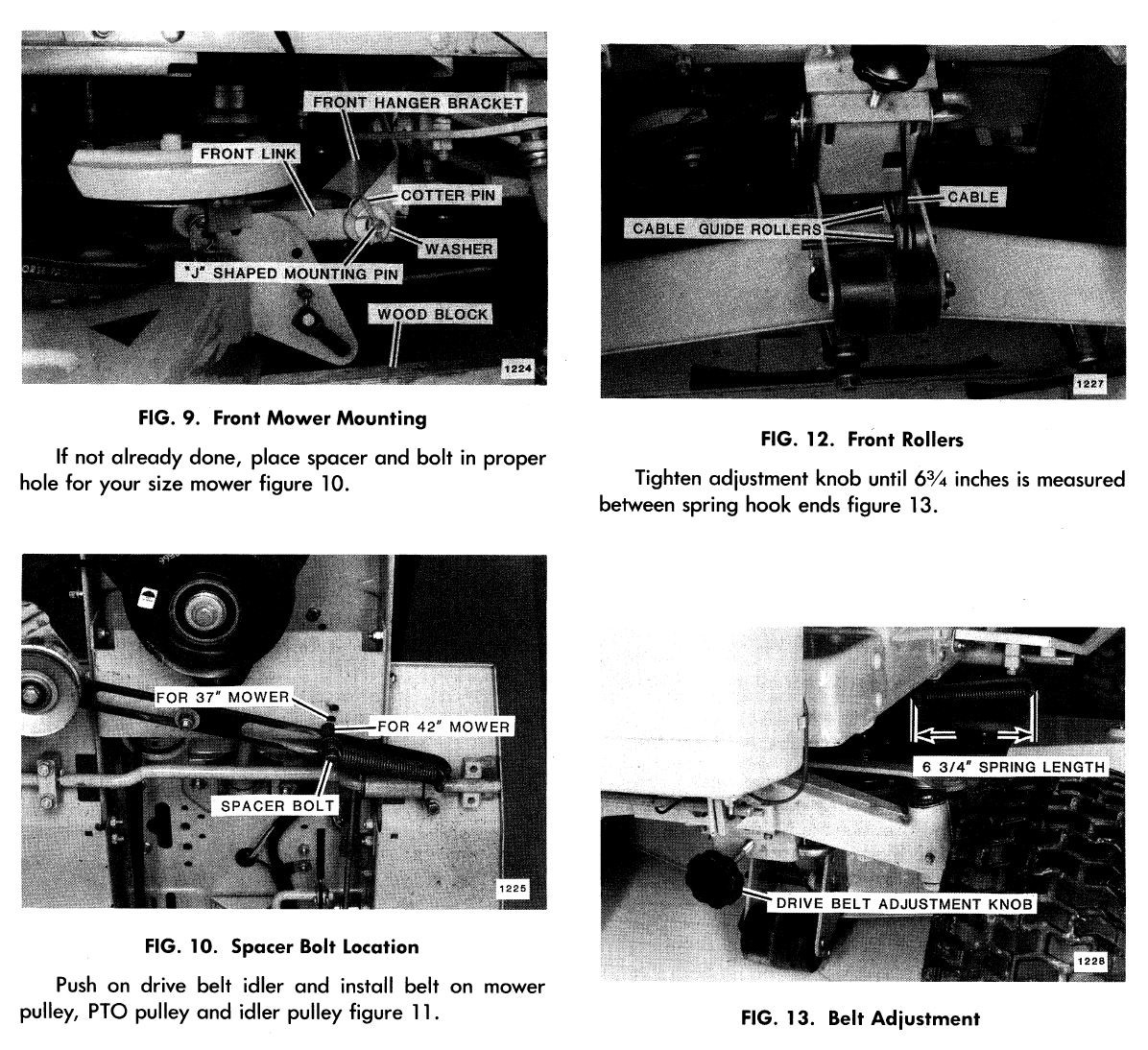

So referencing this image here from the service manual for the mower deck (37"):
What exactly am I doing with this adjustment knob and how does it fit into this piece?
Also for the PTO clutch where am I sticking the feeler gauge exactly and do I need to do all 3 springs? Or does adjusting the one in the manual adjust all three?

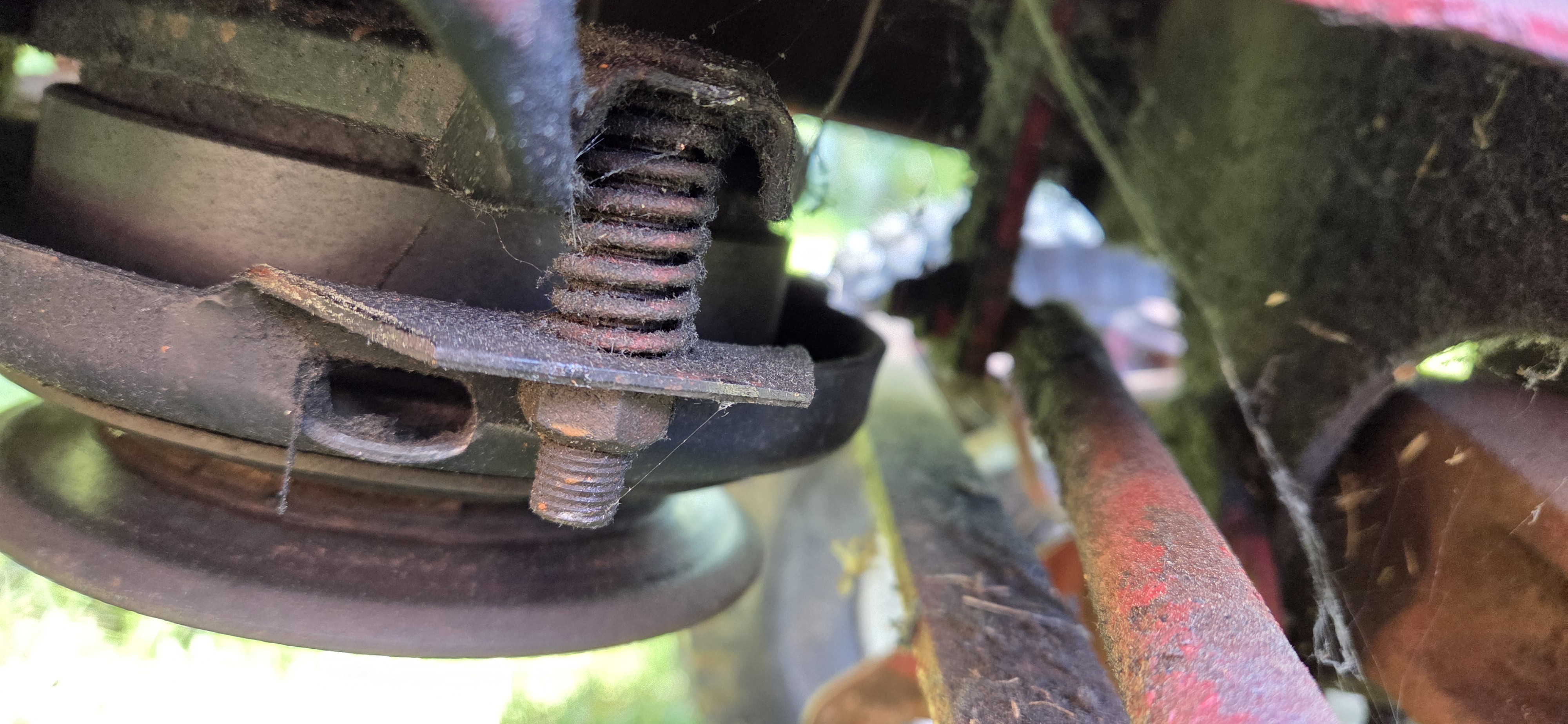

Does that spring on the PTO clutch adjustment knob need to be more compressed? Is that what's happening here? I'm still confused where the feeler gauge goes. Anyone with a 252h can you send a pic of how this should look?

Hey guys! I got it fixed. The PTO clutch plates were WAY off. For those that run into a similar issue and aren't sure I stuck the .010 feeler gauge into this slot:

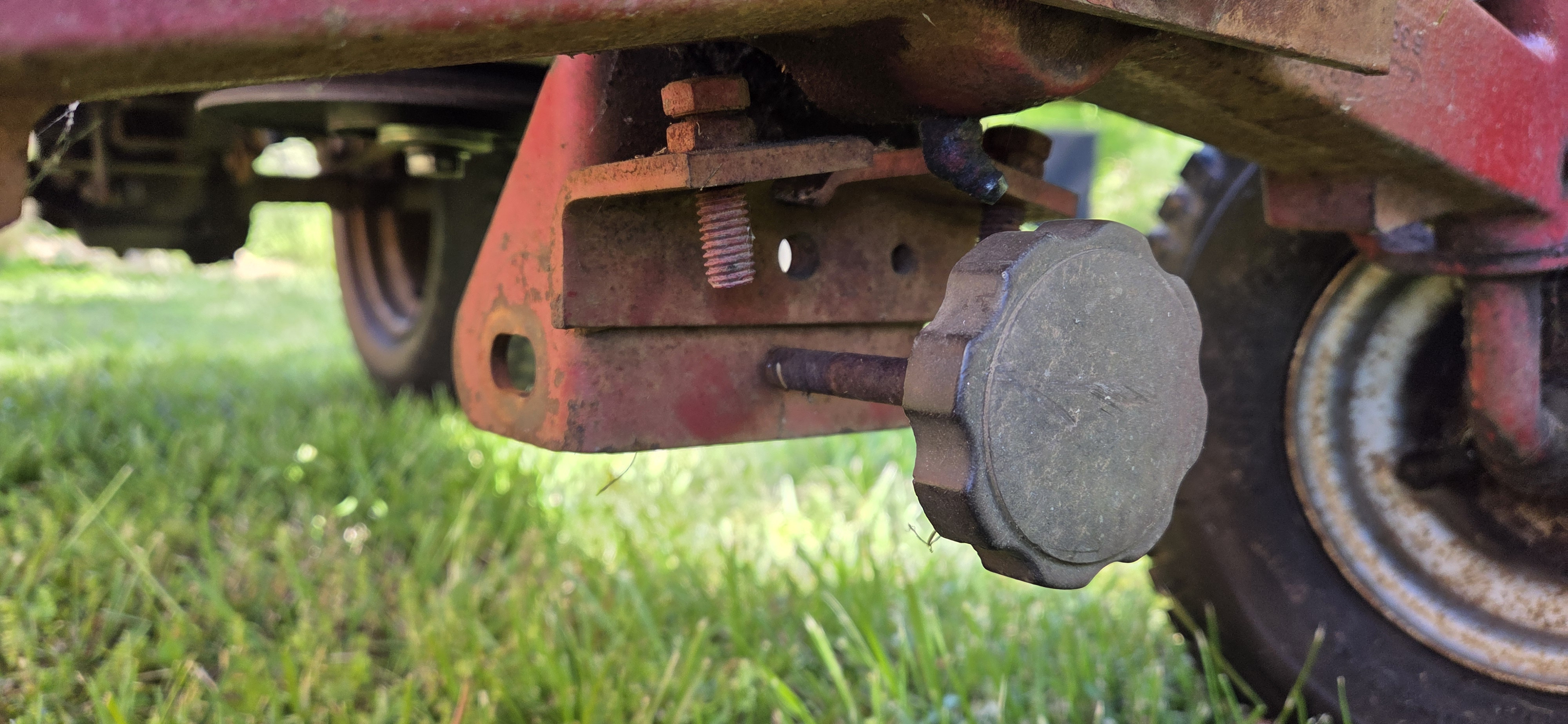

It goes between the clutch plates inside. Tighten the nut til you can just feel it sliding between the two plates just a tiny bit of resistance:
And now my deck doesn't vibrate like all hell and my drive belt doesn't slip off! Woo hoo! Also get the adjustment knob up as tight as you can against the deck and then tighten more with the jam nut where the end of the knob butts up against the hanger where the j-hook goes through. Hope that helps someone!
