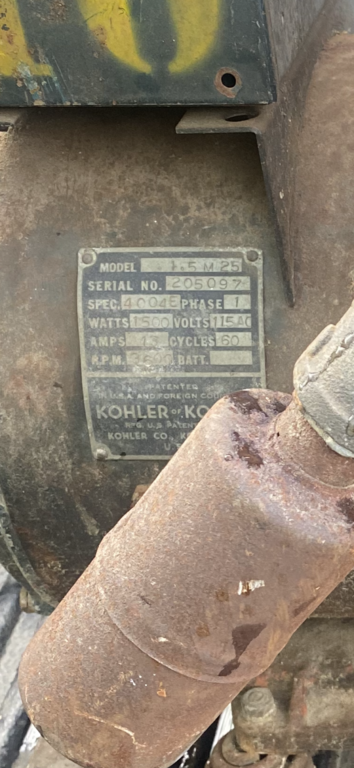

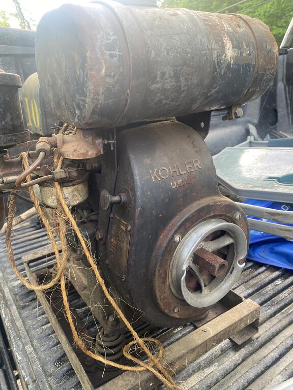

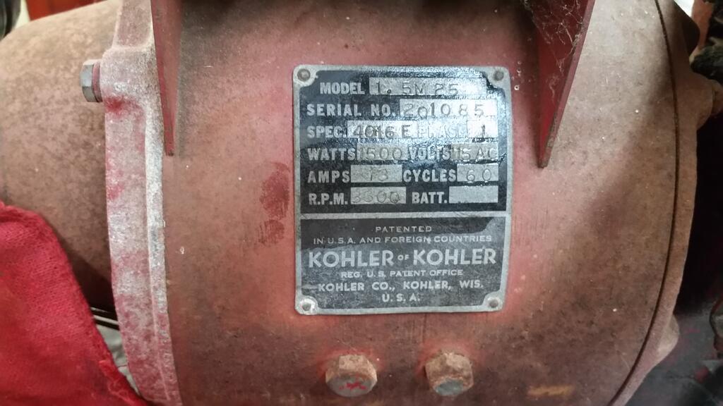

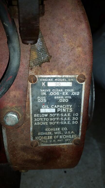

WHGuy413 2,859 #1 Posted May 24, 2022 My home town fire department had this stashed in the garage. It had been used up until about 20 years ago when it was replaced and has been sitting since. It’s loaded with bad gas and the carb is a mess but salvageable. The boys are intrigued by it so they were right by my side. Shockingly it had spark and fired right up on carb clean and it also generates light at the light bulb. The electrician at work seemed pretty optimistic that it would work just fine when I get the engine running. He also is going to make me a plug so I can test it. It’s powered with a Kohler K90. I can’t find much info on the unit online but I’m assuming it’s pretty old since it’s a K90 powering it. 3 5 Share this post Link to post Share on other sites

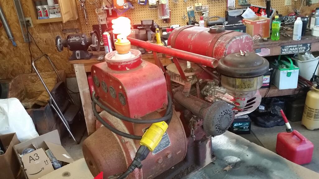

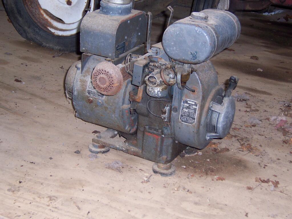

953 nut 69,544 #2 Posted May 24, 2022 I picked up this little generator with a K-90 at a flea market, it was an old military unit. Even came with the shower head muffler and recoil starter. Replaced the spark plug wire from the coil and it is as good as new, 5 3 Share this post Link to post Share on other sites

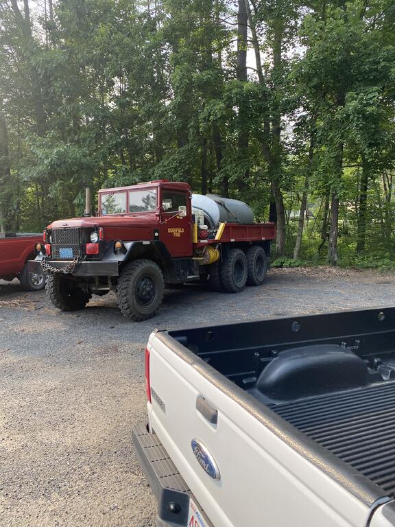

WHGuy413 2,859 #3 Posted May 24, 2022 40 minutes ago, 953 nut said: I picked up this little generator with a K-90 at a flea market, it was an old military unit. Even came with the shower head muffler and recoil starter. Replaced the spark plug wire from the coil and it is as good as new, My department was very much into military surplus when our old Chief was in charge so it very well could be also. I do notice that your governor is set up differently then this one. This is typical of your k series where yours seems to have a box there. here’s my favorite piece of military surplus that we have. I absolutely love this truck. It’s our brush/forestry truck. 4 Share this post Link to post Share on other sites

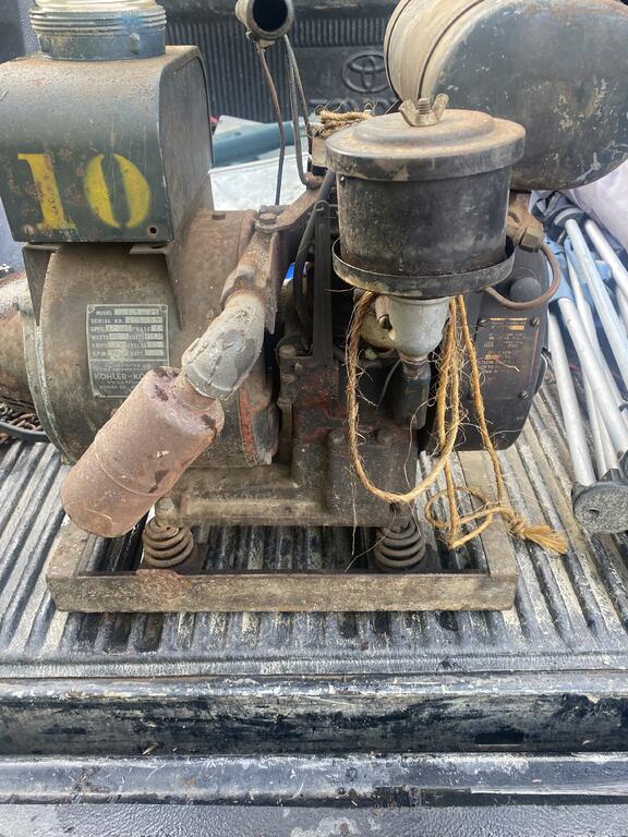

WHX?? 58,214 #4 Posted May 24, 2022 (edited) I got one of them gennys and wasn't so dang heavy would take it to shows and display it & run things at camp just for the halibut. paid 30 clams for it so shower head was worth the price of. Couple of regulars at our shows have vintage genny displays. Think @Lane Rangerhas or had one too. Wished I could find that globe for the light. Lane says they are around but I have yet to find one. OIl bath is cracked so can't put oil in it. I rigged up a grounded pigtail to get the power out but the orginal male plugs are around yet. Edited May 24, 2022 by WHX?? 4 3 2 Share this post Link to post Share on other sites

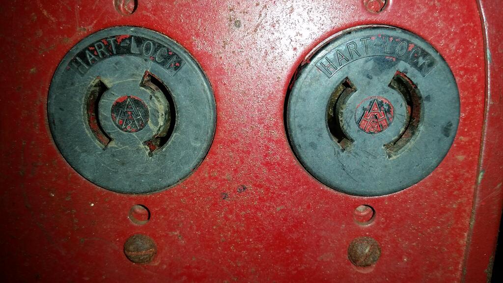

WHGuy413 2,859 #5 Posted May 24, 2022 1 hour ago, WHX?? said: I got one of them gennys and wasn't so dang heavy would take it to shows and display it & run things at camp just for the halibut. paid 30 clams for it so shower head was worth the price of. Couple of regulars at our shows have vintage genny displays. Think @Lane Rangerhas or had one too. Wished I could find that globe for the light. Lane says they are around but I have yet to find one. OIl bath is cracked so can't put oil in it. I rigged up a grounded pigtail to get the power out but the orginal male plugs are around yet. So I’m not sure if my outlets have been rewired or not. I can’t tell from your picture. The 2 outlets on the left are non grounded round plug and the 2 on the right are grounded 3 prong round twist locks on this one. 1 Share this post Link to post Share on other sites

WHGuy413 2,859 #7 Posted May 25, 2022 I made some progress on it tonight after I got home from Alex’s baseball practice. Carb is clean and reinstalled. I drained the old gas out of the tank and flushed it with new stuff. I pulled a glass fuel bowl off of my complete k90, that sits on display, just to test it but the cork gasket that seals the glass to the fuel shut off is bad and leaks gas. Tomorrow I get home before 8 for once (baseball is life for these boys even over tractors) since there is no baseball. I’m going to try cutting my own gasket and see if I can get it to fire up. 4 Share this post Link to post Share on other sites
