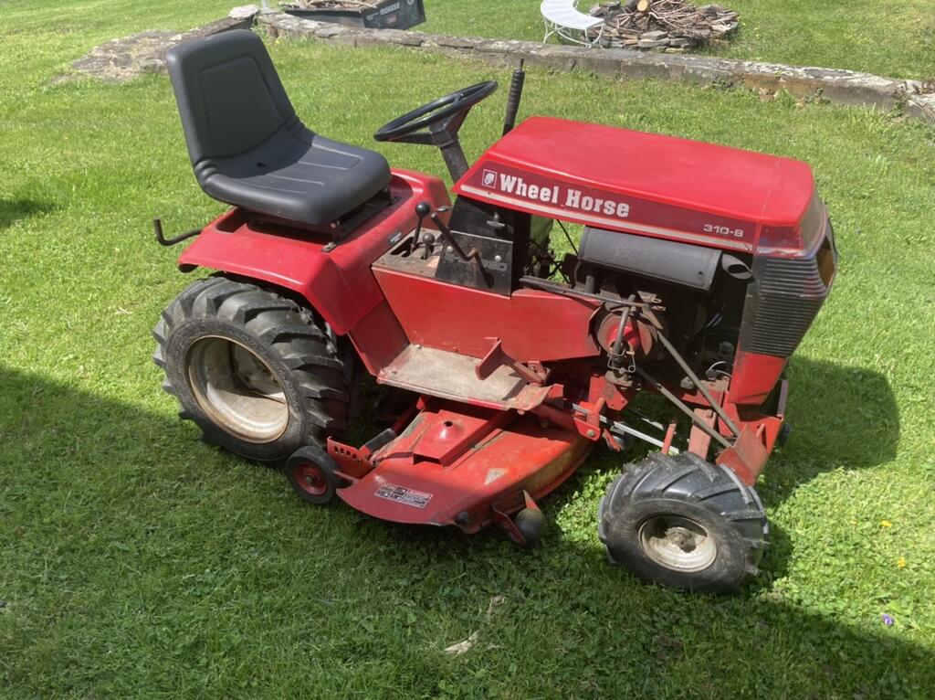

Ifixoldjunk 778 #1 Posted May 22, 2022 (edited) So my 310-8 seems to struggle mowing my slopes. It seems that the engine bogs down considerably towards the top of my yard. Im currently running the belt on the bigger PTO pulley as the owners manual suggests, but if I were to go over to the smaller pulley would it slow the blades enough to tolerate the hills? Edited May 22, 2022 by Ifixoldjunk 2 Share this post Link to post Share on other sites

Ifixoldjunk 778 #19 Posted May 22, 2022 as it turns out, the aftermarket carb the PO put on the tractor wasn’t playing nice with the air cleaner assembly. The linkage had to be bent down to allow the governor a full range of motion. Thank you for your help everyone 6 Share this post Link to post Share on other sites

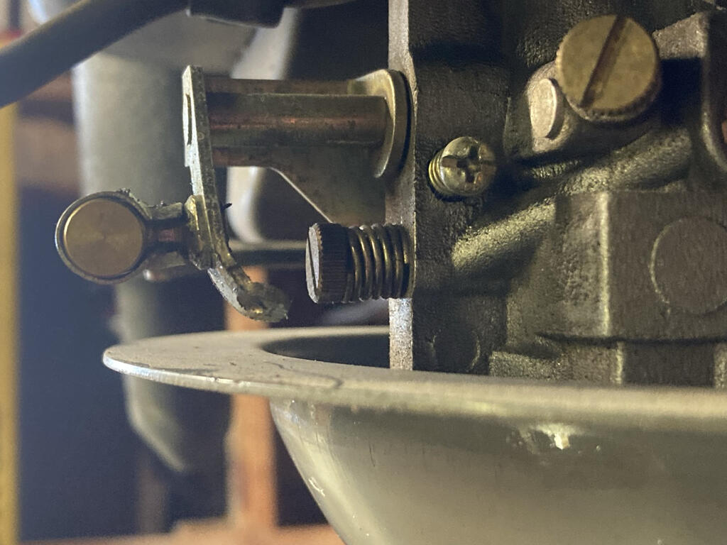

squonk 46,072 #20 Posted May 22, 2022 That mixture screw sure looks like it's cranked in ! 2 1 Share this post Link to post Share on other sites
Ifixoldjunk 778 #21 Posted May 22, 2022 @squonk don’t worry, resolved that as well. My fault for not really ever checking the tractor out lol 3 1 Share this post Link to post Share on other sites
