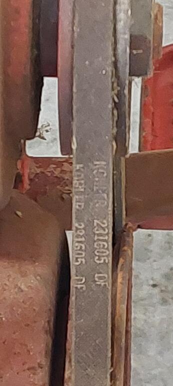

dmoore 1,042 #35 Posted May 17, 2022 Original Kohler generator belt 3 1 Share this post Link to post Share on other sites

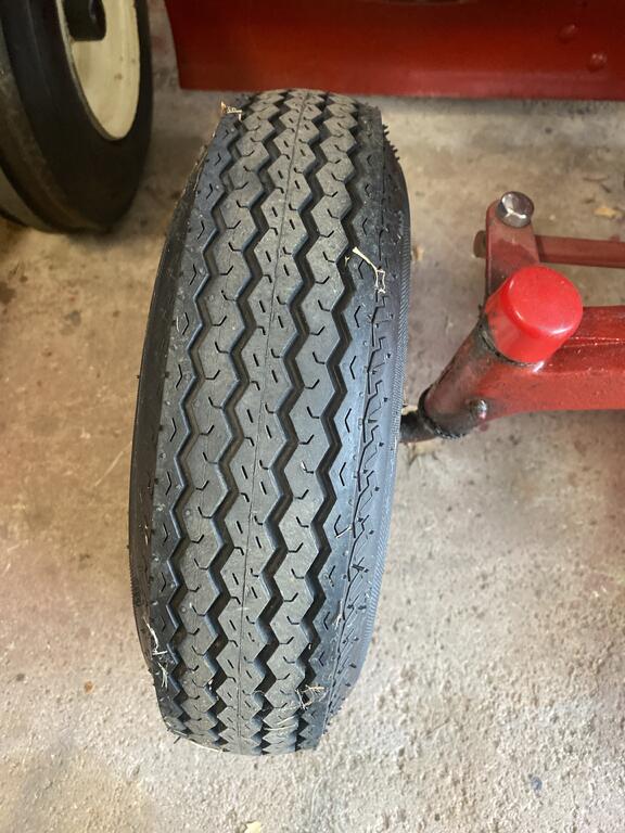

dmoore 1,042 #44 Posted May 18, 2022 I asked a few threads back but do you guy's know if the original type front & rear tires are still available? And if so please post a link. Thanks! 1 Share this post Link to post Share on other sites

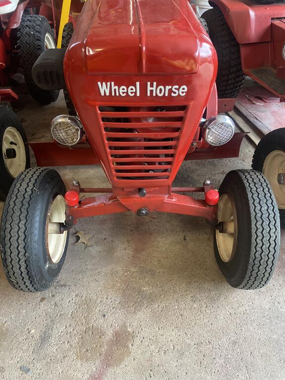

Handy Don 17,463 #45 Posted May 18, 2022 1 minute ago, dmoore said: I asked a few threads back but do you guy's know if the original type front & rear tires are still available? And if so please post a link. Thanks! Exact originals, not that I've been able to find. I went with a pretty close substitute by Carlisle, their "Sawtooth" model. Only difference I could detect was more closely-spaced side scalloping at the edge of the tread (and no more dry rot bulges). 2 Share this post Link to post Share on other sites
dmoore 1,042 #46 Posted May 18, 2022 (edited) Yes, I had looked at them..close. How about the rears, that odd tread pattern...I have entertained this combo as well. Edited May 18, 2022 by dmoore Correction 2 Share this post Link to post Share on other sites

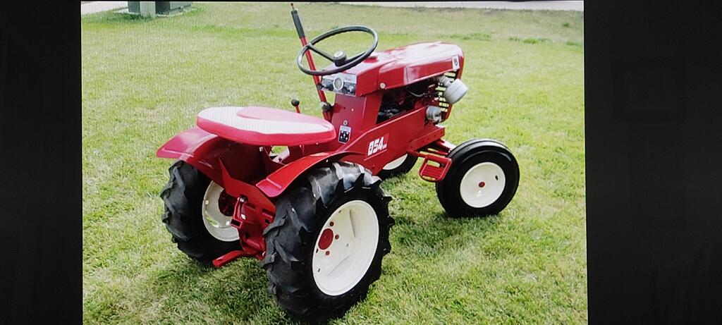

dmoore 1,042 #47 Posted May 18, 2022 It's def more of an aggressive look! 2 Share this post Link to post Share on other sites

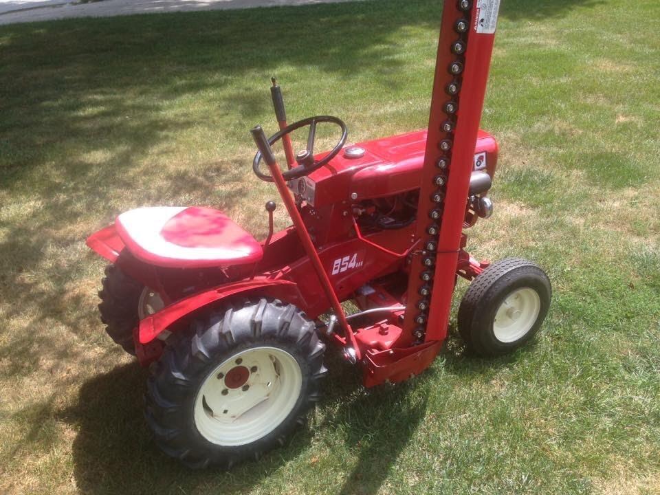

Lane Ranger 12,094 #48 Posted May 18, 2022 (edited) My 854 has DeeStones on the front and (Carlisle in early pics on back) Firestone sawtooth on the back. Edited May 18, 2022 by Lane Ranger 3 Share this post Link to post Share on other sites

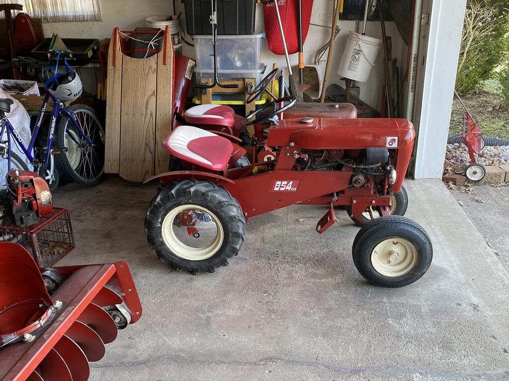

Handy Don 17,463 #49 Posted May 18, 2022 38 minutes ago, dmoore said: How about the rears, that odd tread pattern...I have entertained this combo as well I've kept the Firestone "All purpose" garden tractor tires it came to me wearing and, frankly, I like that look and they do the job. The tires and wheels must have been taken off and stored early on and only put back on to sell the machine since they have practically no wear, just some weather/age cracks, and are still holding air. The paint on the wheels was shot but it looked like weathering you'd get from covered outdoor storage and not wear and tear. 3 1 Share this post Link to post Share on other sites
dmoore 1,042 #50 Posted May 18, 2022 Okay that's your tractor Lane Ranger wow! She is sure sharp I'd like the cleat tires on the back but I don't think I could do clean on the front as well I don't know maybe just me 2 Share this post Link to post Share on other sites
