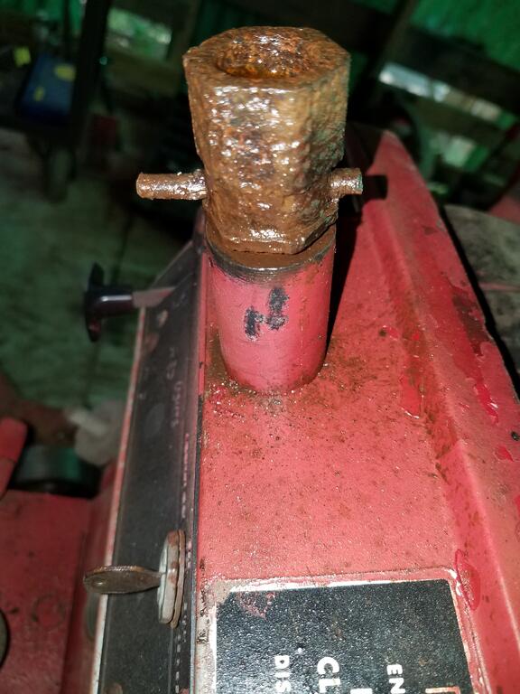

tntatro 184 #26 Posted May 14, 2022 Any suggestions for getting this roll pin out. The steering wheel broke off and this pin is rusted in. I'm thinking about cutting the ends off and re drilling the hole. 1 Share this post Link to post Share on other sites
Handy Don 17,671 #27 Posted May 14, 2022 Roll pins are exceedingly hard spring steel. Most likely you'll either ruin your drill bit or else have the bit go off the the side and drill the much softer steering shaft. Even cutting one off can be tough of a saw (I'd use a cutoff wheel, myself). This is one of the really tough WH repairs, especially because it's difficult to properly support the shaft while pounding on the pin. I got one by clamping the steering shaft to a 2x4 brace that I had bracketed to a sturdy wall and then using a roll pin punch after lots of heat and penetrant. Some members have cut the steering shaft, dealt with the pin/steering wheel with it off the tractor, and then re-welded the shaft. Some give up and seek a replacement. 1 Share this post Link to post Share on other sites
tntatro 184 #28 Posted May 14, 2022 9 hours ago, Handy Don said: Roll pins are exceedingly hard spring steel. Most likely you'll either ruin your drill bit or else have the bit go off the the side and drill the much softer steering shaft. Even cutting one off can be tough of a saw (I'd use a cutoff wheel, myself). This is one of the really tough WH repairs, especially because it's difficult to properly support the shaft while pounding on the pin. I got one by clamping the steering shaft to a 2x4 brace that I had bracketed to a sturdy wall and then using a roll pin punch after lots of heat and penetrant. Some members have cut the steering shaft, dealt with the pin/steering wheel with it off the tractor, and then re-welded the shaft. Some give up and seek a replacement. Thanks for the reply. I had already broke a small drill bit. I first ran one throught the center and the idea was to gradually go bigger. It didn' work. I might just try to apoxy and clamp the broken steering wheel back on. It's cracked in three places but the circle and supports are still intact. I can pull it apart enough to put apoxy in and get it back over the pin. I can probably file it off round at the bottom and put a hose clamp on also. There was a hose clamp there when I got it but the taper made it slide off. 3 Share this post Link to post Share on other sites

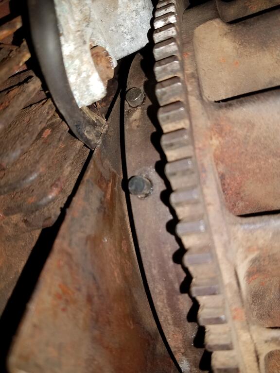

tntatro 184 #29 Posted May 14, 2022 I got the new pins installed but unfortunately there is still no spark. I checked the connection at the boot also but I don't think there is a problem there. I guess for now I'm going to focus on the B80. After that one is going I may pull the head off the Tecumseh and see how much wear there is in the bore and go from there. If the bore is good then maybe I'll try a modified ignition. 2 Share this post Link to post Share on other sites
Handy Don 17,671 #30 Posted May 15, 2022 13 hours ago, tntatro said: I got the new pins installed but unfortunately there is still no spark. Nice job on the pins. Bummed at no spark. I'll give this some thought. 2 Share this post Link to post Share on other sites
ebinmaine 81,139 #31 Posted May 15, 2022 12 minutes ago, Handy Don said: Nice job on the pins. Bummed at no spark. I'll give this some thought. @tntatro Wondering how fast the engine was turning? What depth the pins are at? 1 Share this post Link to post Share on other sites
tntatro 184 #32 Posted May 15, 2022 4 minutes ago, ebinmaine said: @tntatro Wondering how fast the engine was turning? What depth the pins are at? The instructions with the pins said to press them all the way in to the shoulders. I measured the long one and it was 1/4" to the shoulder. I set the gap about .008". I used a cordess drill to turn it over and it seemed to turn it over pretty fast without the spark plug in. With the plug in it turned over pretty good also. 1 Share this post Link to post Share on other sites
ebinmaine 81,139 #33 Posted May 15, 2022 12 minutes ago, tntatro said: The instructions with the pins said to press them all the way in to the shoulders. I measured the long one and it was 1/4" to the shoulder. I set the gap about .008". I used a cordess drill to turn it over and it seemed to turn it over pretty fast without the spark plug in. With the plug in it turned over pretty good also. I don't have the specs happy or I'd be happy to quote them. The engine needs to be turning over anywhere from 90 RPM to 400 RPM depending on the set of the pin depth and Gap. My experience with drills turning engines over does not get them up to 300 or 400 RPM but I'm not using your drill. It's possible that may be worth taking the time to set that engine up so that it turns on its own starter which should get you somewhere between 250 RPM and 400 RPM. 1 Share this post Link to post Share on other sites
tntatro 184 #34 Posted May 15, 2022 24 minutes ago, ebinmaine said: I don't have the specs happy or I'd be happy to quote them. The engine needs to be turning over anywhere from 90 RPM to 400 RPM depending on the set of the pin depth and Gap. My experience with drills turning engines over does not get them up to 300 or 400 RPM but I'm not using your drill. It's possible that may be worth taking the time to set that engine up so that it turns on its own starter which should get you somewhere between 250 RPM and 400 RPM. I'm pretty much judging the speed by comparing it to starting my other tractors. I'll try it with the starter and see if it sparks that way. 1 Share this post Link to post Share on other sites
tntatro 184 #35 Posted May 15, 2022 I hooked up the starter to a battery and still no spark. I measured the length of the pins and the long one is a hair over 3/16", the short on is about 1/8". I think the manual said the long one should be 1/4" and I forget what the short one was supposed to be. 2 Share this post Link to post Share on other sites
tntatro 184 #36 Posted May 15, 2022 Here's the instructions that came with the pins. 2 Share this post Link to post Share on other sites
ebinmaine 81,139 #37 Posted May 15, 2022 1 hour ago, tntatro said: I hooked up the starter to a battery and still no spark. I measured the length of the pins and the long one is a hair over 3/16", the short on is about 1/8". I think the manual said the long one should be 1/4" and I forget what the short one was supposed to be. Seems reasonable. Check the manual for proper Air Gap settings and confirm that. It definitely matters. 1 Share this post Link to post Share on other sites
tntatro 184 #38 Posted May 15, 2022 (edited) 8 minutes ago, ebinmaine said: Seems reasonable. Check the manual for proper Air Gap settings and confirm that. It definitely matters. The air gap should be between .006" to .010". Edited May 15, 2022 by tntatro 1 Share this post Link to post Share on other sites
Handy Don 17,671 #39 Posted May 15, 2022 2 hours ago, tntatro said: The air gap should be between .006" to .010". @ebinmaine thanks for chipping in, I've been committed elsewhere today. @tntatro, you have the docs I planned to look for that specify the gaps and pin heights and it looks like you have those dialed in. As you might have surmised, it isn't the actual heights that are critical but rather the difference in the heights of the two pins and the gap from the higher pin to the sensor. I think the manual that has the gap setting also describes how to check that the sensor is picking up the high pin to release the spark when the engine is at the cranking speed. Are you using a spark tester to look for the spark? I've had mixed result with the "lay the spark plug on the block and look for the spark" method. A tester is more certain for accuracy. And yes, it expects to be turning at 300-400 to get a spark. As you've probably discovered, the sensors are hard to come by and pricey for this system. @ebinmaine's suggestion to connect with Ed Stoller on other options is a good idea. Hope you can save it! 2 Share this post Link to post Share on other sites

oliver2-44 11,816 #48 Posted June 10, 2022 On 5/13/2022 at 7:48 PM, tntatro said: Any suggestions for getting this roll pin out. The steering wheel broke off and this pin is rusted in. I'm thinking about cutting the ends off and re drilling the hole. On 5/14/2022 at 6:23 PM, tntatro said: I might just try to apoxy and clamp the broken steering wheel back on. It's cracked in three places but the circle and supports are still intact. I can pull it apart enough to put apoxy in and get it back over the pin. I can probably file it off round at the bottom and put a hose clamp on also. There was a hose clamp there when I got it but the taper made it slide off. My C81 steering wheel was cracked at the hub similar to yours when I got it. I learned on here to use a carbide glass bit to drill the roll pin out. Found one at HD. I sandblasted the hub steel piece and epoxied it back together with JB weld. Still holding several years later. You can add a little black spray paint to the epoxy if you want to hide the repair even more. Share this post Link to post Share on other sites
tntatro 184 #49 Posted June 10, 2022 Just now, oliver2-44 said: My C81 steering wheel was cracked at the hub similar to yours when I got it. I learned on here to use a carbide glass bit to drill the roll pin out. Found one at HD. I sandblasted the hub steel piece and epoxied it back together with JB weld. Still holding several years later. You can add a little black spray paint to the epoxy if you want to hide the repair even more. I ended up leaving the pin in and glued the steering wheel back on. I also filed the base of the steering wheel to take out the taper and put a hose clamp on. Share this post Link to post Share on other sites
