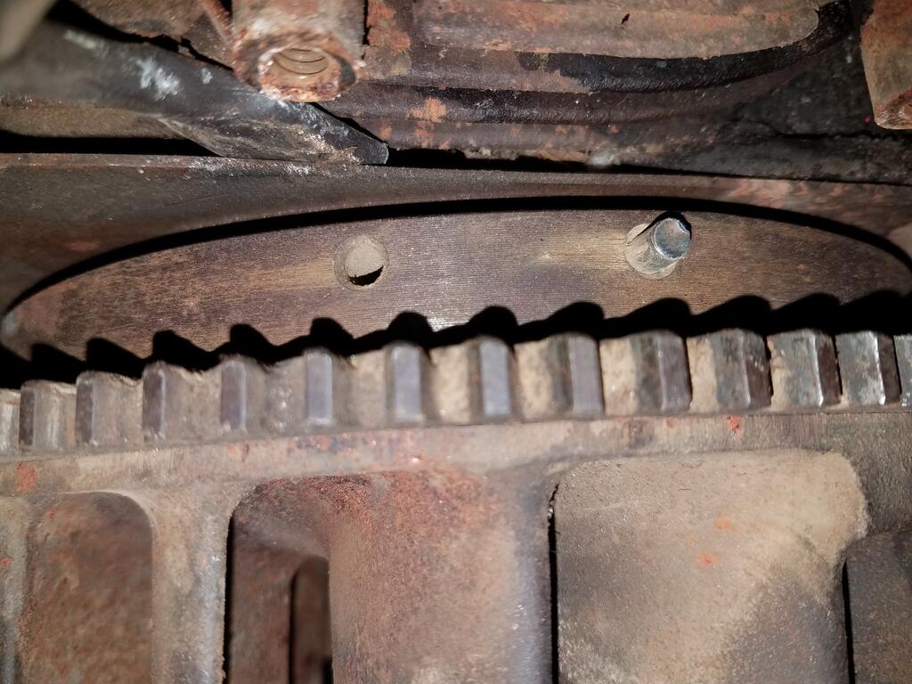

tntatro 184 #11 Posted May 11, 2022 I just discovered a pin is missing in the flywheel. I decided to try and clean the pins and ignition and it looks like the pin has been missing for a while. Would that prevent it from having spark and can it be replaced? 1 Share this post Link to post Share on other sites
ebinmaine 80,302 #12 Posted May 11, 2022 It's been awhile since I've seen how this system works. If I recall correctly, one pin is for starting spark and the other is for running spark. So yes. If it's the slow speed pin it could prevent starting. I believe one of Ed's videos shows how they work and likely it could be replaced, yes. Have you (or can you) tested the coil yet? 1 Share this post Link to post Share on other sites
tntatro 184 #13 Posted May 11, 2022 19 minutes ago, ebinmaine said: It's been awhile since I've seen how this system works. If I recall correctly, one pin is for starting spark and the other is for running spark. So yes. If it's the slow speed pin it could prevent starting. I believe one of Ed's videos shows how they work and likely it could be replaced, yes. Have you (or can you) tested the coil yet? I haven't tested the coil, I don't know how. 1 Share this post Link to post Share on other sites

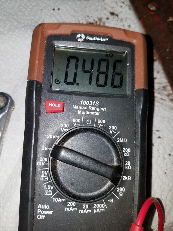

tntatro 184 #16 Posted May 11, 2022 26 minutes ago, ebinmaine said: Not sure either way would turn the flywheel fast enough to create a spark. Perhaps the manual has a method? I would think the starter turning it over should do it if it were good. That's how it starts normally. I just watched a video on testing the coil with a multimeter. I set it to the beep mode for continuity and it passed that test. I touched one lead to the terminal and the other to the block and it didn't show a connection. According to the video that shows that it might be good. I think I'll try to replace the pin since that isn't a big expense. Later I'll try adjusting the gap with the coil and existing pin to see if that does anything. I'll check out what the service manual says also. 2 Share this post Link to post Share on other sites
tntatro 184 #17 Posted May 11, 2022 I am reading the manual now and I guess I was a little confused about the coil vs the ignition. The ignition passed the test, now I'll check the generator coil. 2 Share this post Link to post Share on other sites
tntatro 184 #18 Posted May 12, 2022 According to the manual, if the coil is below 400 ohms then it should be replaced. I think the reading I got translates to 486 ohms. The strange thing is that the manual says if it's over 400 ohms then replace the ignition. I'm assuming it is referring to a troubleshooting situation. It appears that the pin that is missing is the longer one so I cannot adjust the gap accurately. In my case I think replacing the pin is the next step so I ordered a set off ebay. Hopefully the correct set, it is for an HH100 flywheel so I ordered them. $14 won't be a huge loss if it's not the problem. 1 Share this post Link to post Share on other sites
Handy Don 17,316 #19 Posted May 12, 2022 3 hours ago, ebinmaine said: It's been awhile since I've seen how this system works. If I recall correctly, one pin is for starting spark and the other is for running spark. So yes. If it's the slow speed pin it could prevent starting. I believe one of Ed's videos shows how they work and likely it could be replaced, yes. Have you (or can you) tested the coil yet? Yep, you would have to spin the engine very fast to get it to run with only the pin you have. The engine rotates clockwise (looking from flywheel side) The right side pin in your image is the "fast" pin--important for efficient running since it fires the spark before TDC The missing pin in your image is the "slow" pin--important for starting since it fires the spark at TDC The slow pin sticks out of the flywheel farther than the fast pin so it can trigger the spark sensor even at slow speed. 2 Share this post Link to post Share on other sites
tntatro 184 #20 Posted May 12, 2022 17 minutes ago, Handy Don said: Yep, you would have to spin the engine very fast to get it to run with only the pin you have. The engine rotates clockwise (looking from flywheel side) The right side pin in your image is the "fast" pin--important for efficient running since it fires the spark before TDC The missing pin in your image is the "slow" pin--important for starting since it fires the spark at TDC The slow pin sticks out of the flywheel farther than the fast pin so it can trigger the spark sensor even at slow speed. Thanks for clearing that up for me. I didn't comprehend about the fast and slow pin. I ordered replacement trigger pins so with a little luck maybe I'll get some spark out of it eventually. The coil seemed to test okay and the ignition is at least not showing continuity when I put the lead on the terminal and the other lead on the block. I was told it ran before the starter went out... twenty years ago, but that's what they all say. 3 Share this post Link to post Share on other sites
