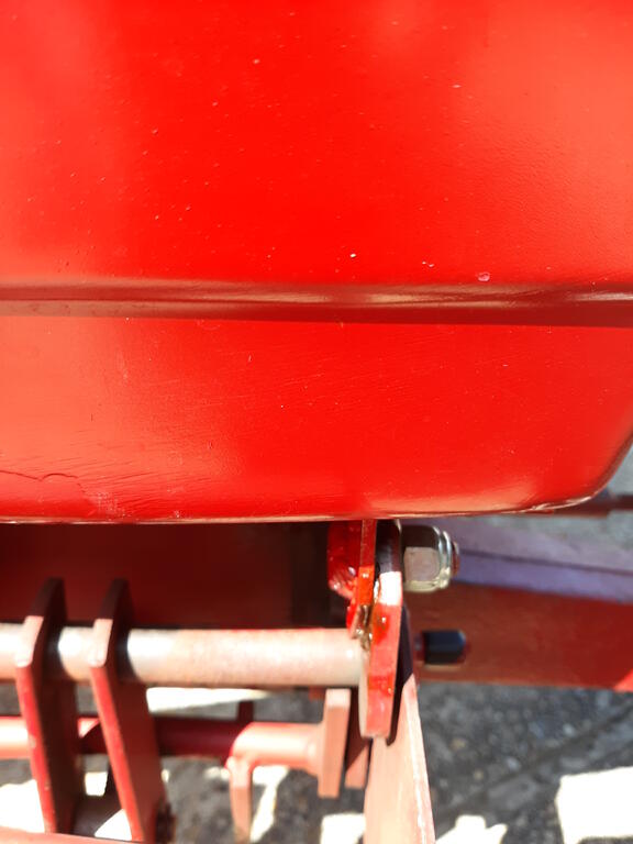

balconio 606 #5 Posted May 10, 2022 1) i wish i would have taken pictures, but on both my 312-8's the frame rail ends where the seat and rear fender tins bolt on were broken or cracked. i fixed this by cutting them short and welding on bed frame iron which i know isn't the best but it's more than adequate for this and way thicker than what was there. i can only imagine it happened because i'm 250lbs and also i get on and off the tractor from the right side 90% of the time and put a lot more stress on that side. 2) i boxed in the steering shaft bushing with some steel bar because it was sloppy AF and i couldn't for the life of me get the roll pin out of the steering wheel to do it right and replace the bushings. i still have 2 NIB bronze steering bushings, but the steering is staying tight. 3) i got rid of the sloppy bar and bushing setup for the hood and just used some bolts and nylock nuts to hold it down. hood is SUPER steady now and it used to rock around visibly as I mowed. 4) not really an improvement but more of a preference: i don't use any cotter pins anymore... i use different size "R" clips for all my retention points so it truly is a tool free process to change decks/blower/remove belt from PTO etc. 6 1 Share this post Link to post Share on other sites
ebinmaine 80,649 #6 Posted May 10, 2022 13 minutes ago, balconio said: got rid of the sloppy bar and bushing setup for the hood and just used some bolts and nylock nuts to hold it down Gonna have to try to remember that one 1 Share this post Link to post Share on other sites
Handy Don 17,463 #7 Posted May 10, 2022 43 minutes ago, balconio said: got rid of the sloppy bar and bushing setup for the hood and just used some bolts and nylock nuts to hold it down I like it. Even better if you can use partially threaded bolts to keep the smooth part at the pivot point. 6 Share this post Link to post Share on other sites
ebinmaine 80,649 #8 Posted May 10, 2022 2 minutes ago, Handy Don said: I like it. Even better if you can use partially threaded bolts to keep the smooth part at the pivot point. Wicked good idea mistah. 2 Share this post Link to post Share on other sites

8ntruck 9,296 #10 Posted May 10, 2022 (edited) 18 hours ago, Handy Don said: I like it. Even better if you can use partially threaded bolts to keep the smooth part at the pivot point. Throw a Belleview washer under the nylock. That would keep some tension in the joint and kill rattles. Edited May 11, 2022 by 8ntruck 4 Share this post Link to post Share on other sites

ebinmaine 80,649 #12 Posted May 11, 2022 1 hour ago, 8ntruck said: Throw a Belleview washer under the nylock. That would keep some tension I'm the joint and kill rattles. Again. Despite my best efforts... I've learned something. 4 Share this post Link to post Share on other sites

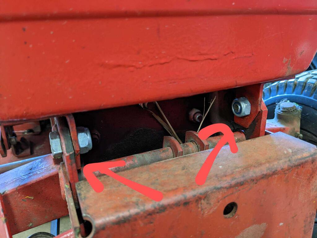

Lee1977 7,764 #20 Posted May 13, 2022 On 5/10/2022 at 3:57 PM, ebinmaine said: Gonna have to try to remember that one You don't need the bolts unless you have the later model tractors 300, 400. 500 and maybe the Black Hoods not sure about them. The C-series needs good rubber stops between the hinge. I used some of the large 5/8" diameter tubeless valve stims cut them off about 1/2" above the sealing groove and pulled the brass stem out. Did that about 25 years back and they are still working. I had some extra 5/8" valve stims that I don't use any more. 3 4 1 Share this post Link to post Share on other sites
ebinmaine 80,649 #21 Posted May 13, 2022 8 minutes ago, Lee1977 said: 👍 Excellent! 1 Share this post Link to post Share on other sites
Lee1977 7,764 #22 Posted May 13, 2022 (edited) I decided to make a new set of hinges for the 312. Tried putting bushings in the hinges a month or so back didn't help much. They made the original hinges just too thin I used some 1/4" x 2" x 2" angle and cut some out. Haven't completely finished it but got it together. Need to drill hinges and the front hitch out to 7/16" as the holes in the front hitch are worn. I got it finished, used the existing rod and made collars out of a couple of nuts shimmed the rod tight and epoxied it. Then dabbed some paint at it. It's my worker was a sad looking horse when I got it. Now it you shake the hood the hold tractor moves. Edited May 15, 2022 by Lee1977 3 2 Share this post Link to post Share on other sites
war eagle 80 #23 Posted May 14, 2022 My hinges were seriously wallered out causing the hood to rock sideways and rattle so I tack welded 1 inch grade 8 bolts to them and used nylon washers and lock nuts. No slop or rattles now! 6 1 Share this post Link to post Share on other sites
peter lena 10,047 #24 Posted May 15, 2022 @war eagle glad you got after that , once you get in the habit of correction , you look at problems differently . @Lee1977 did a nice strengthening set up on that chronic lower hood area . always adapting for function , make it better . of course if you have to keep it original , thats another issue . pete 2 Share this post Link to post Share on other sites
