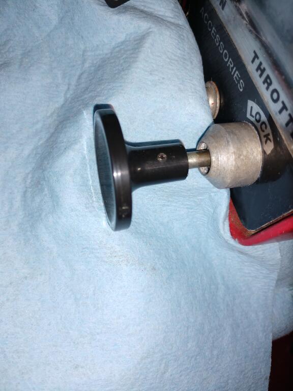

kpinnc 18,744 #12 Posted May 1, 2022 One thing I found to preserve the twist locking function on these old cables is to install a roll pin in them. Harbor freight has a cheap pin assortment, and they include smaller ones down to 1/8 diameter. These work very nice and I've never had any more issues with the throttle lock after installing them. 3 1 Share this post Link to post Share on other sites
