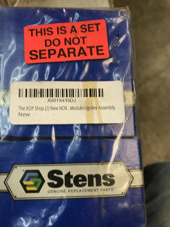

oliver2-44
I bought these off Amazon. The vendor was “The ROPS Shop”. That vendor is also on Ebay
  • Thanks 1
